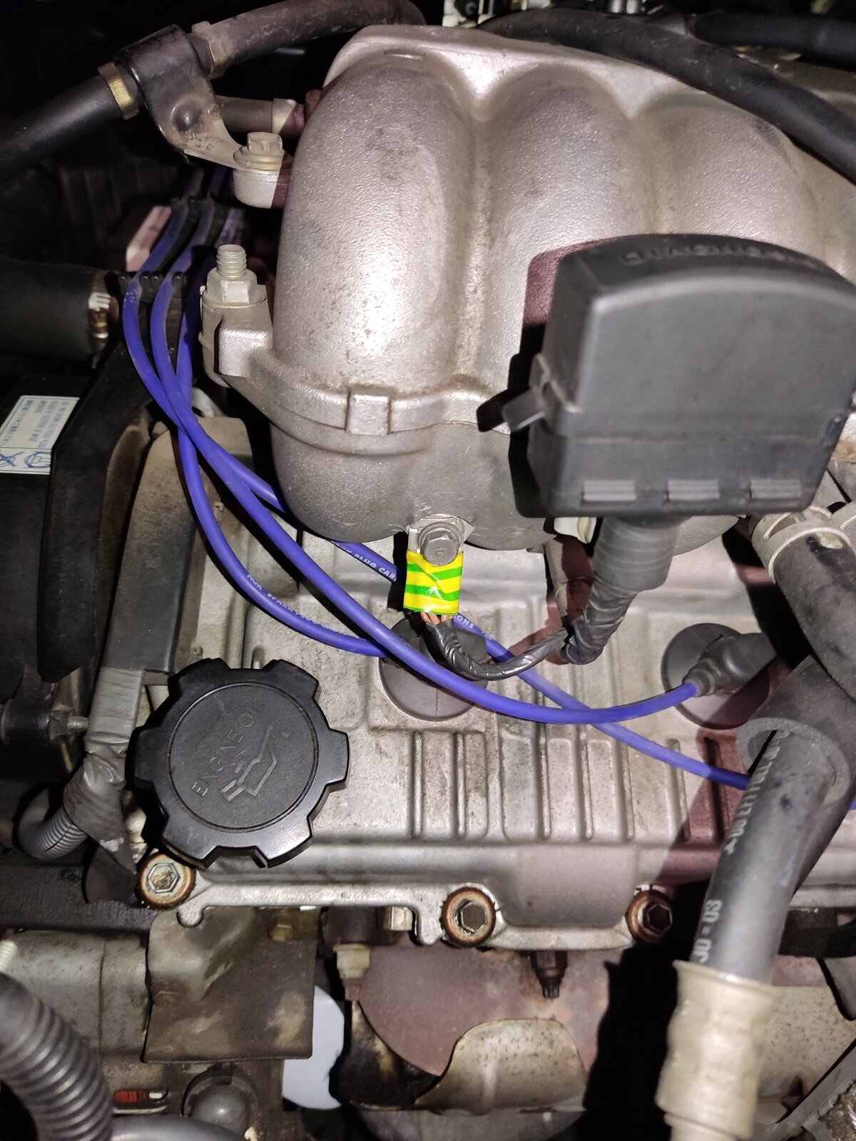

Isaac - in your previous posts, you went from 15l/100km (almost 19mpg), before a service, to 20l/100km (14mpg) after the service. If so, think through what was included in the service?
I don’t know much about the 3.4 petrol engine - could you have disconnected a vacuum pipe, left an electrical connector disconnected (or damaged the terminals) etc. Spark plugs, thick engine oil, O2 sensor, fuel filter leak. Brakes dragging?

Thanks for the heads up. Yeah I had left a hose off, which has improved it, I also did break one side of the connector pictured (green tape around it). Not sure if that is important?

Not sure if the earth is that important, plenty of other grounds on the block but a disconnected vacuum hose would definately cause issues.
