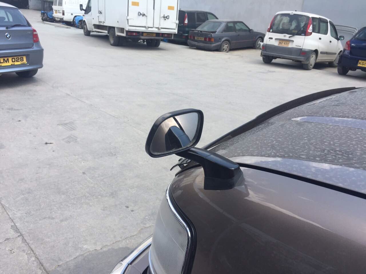

Fitted JDM mirror courtesy of Richard (Starcruiser)

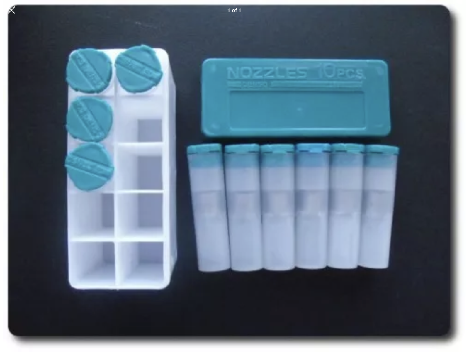

Also fitted new Denso injectors in preparation for a turbo intercooler tune up soon.
