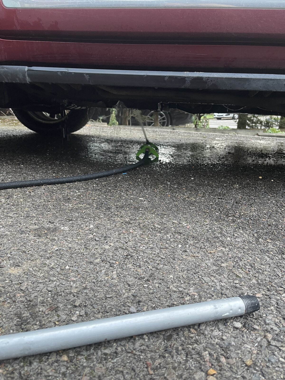

I read on this forum that keeping sprinklers under the car is good way to prevent rust from salt. Took car out this week with salt on road so doing this job. Scary rust.
