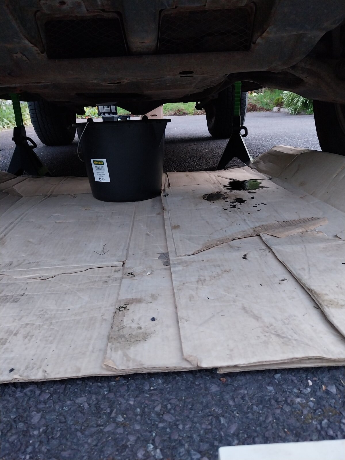

Did an oil change for my 120 yesterday, it was my first oil change and I'm pretty happy with it. I twisted off the oil filter with my hand so I'm glad I decided against buying the tool. The filter glugged out a bit of oil though so that was a bit messy. I put 10-w40 into it. I was planning on buying 5-w30 but the guy in the shop suggested 10-w40 and it was half the price so I couldn't argue.

For next time you could keep these two things in mind.
There should be a small drain hole at the bottom of the oil filter housing, should be a small bore pipe below this hole which ends up very close to the sump drain plug, if you undo the filter a turn or two the oil inside should drain down through that pipe into your waste collection bowl allowing you to remove the filter after a short wait without spillage, the hole can get clogged up with muck over time which might have happened to yours, reverse blowing through the pipe should dislodge any blockage.
If possible its worth leaving the oil to drain for several hours preferably overnight, the oil pick up strainer is directly above the drain hole on 120s, an ideal time to inspect it via torch or camera to check its not getting clogged with carbon clumps...early warning there might be a leaking injector seal if its getting carboned up.
Anyway, that's not a mess you should see me and the sheets of cardboard and the block paving i failed to cover adequately after my rustproofing escapades...:anguished:
You were lucky getting that filter off without a tool! If youre doing your own oil changes worth having one in your box for the sake of a tenner or whatever they are
