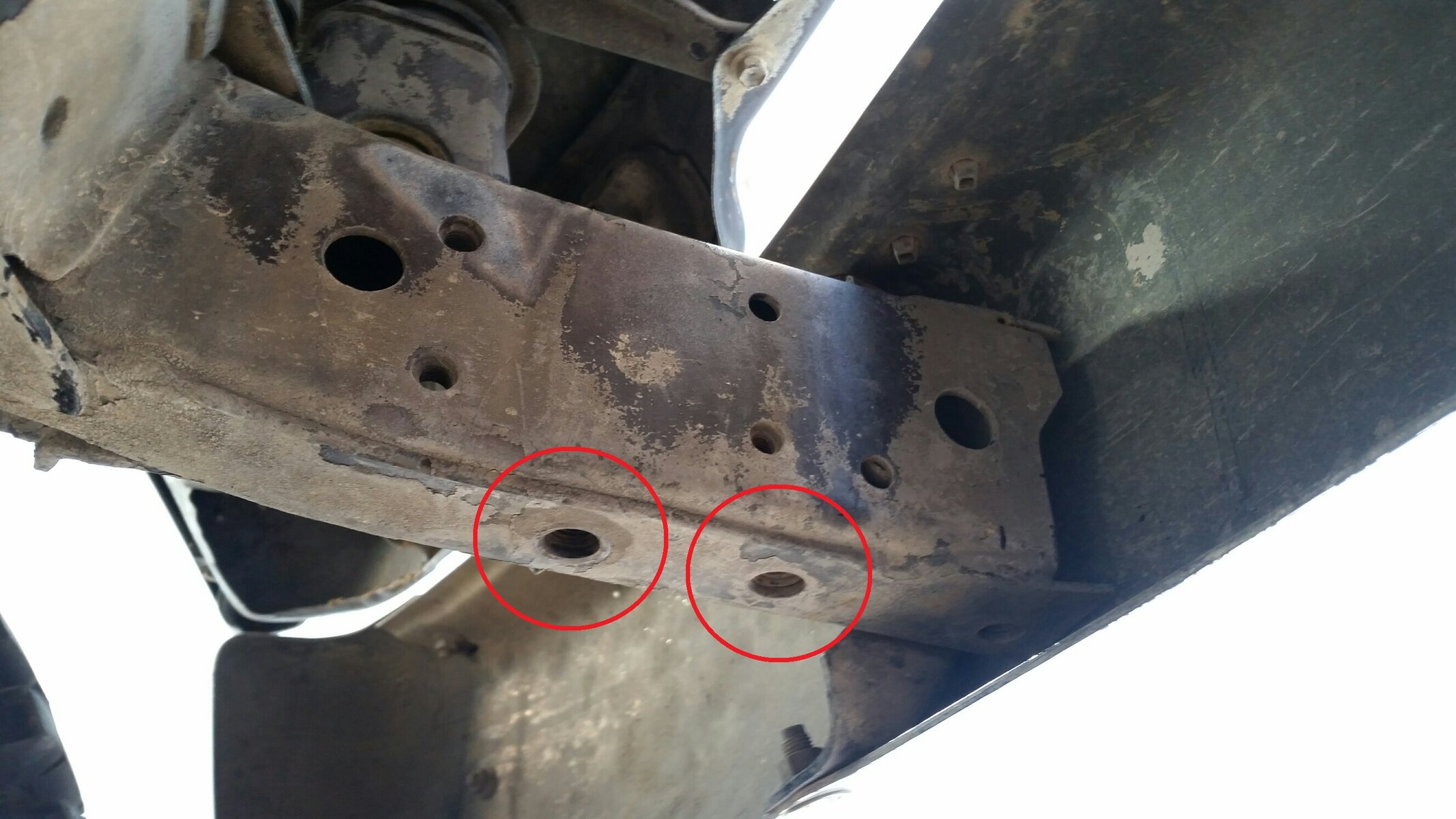

Hi guys,
Currently looking at fitting a winch to my LJ79 and I want to use the captive nuts on the chassis legs. I tried to identify what size these are and they don't seem to be metric (M10 goes straight in and M12 is way too big), in fact I think they are imperial 7/16". Could that be ?
Thanks in advance for your help :icon-biggrin:
Have you tried fine thread , I don't know about the 70s but those bolts on my 90 are m12 X 1.25
There is no way they will be imperial unless someone has changed the captive nuts which seems very unlikely. :think:
As Shayne says they are M12 metric fine thread. I've just been out and checked mine. :icon-wink:
When picking up a winch to fit between the chassis rails, you need one with the brake inside the drum otherwise it'll be too wide
