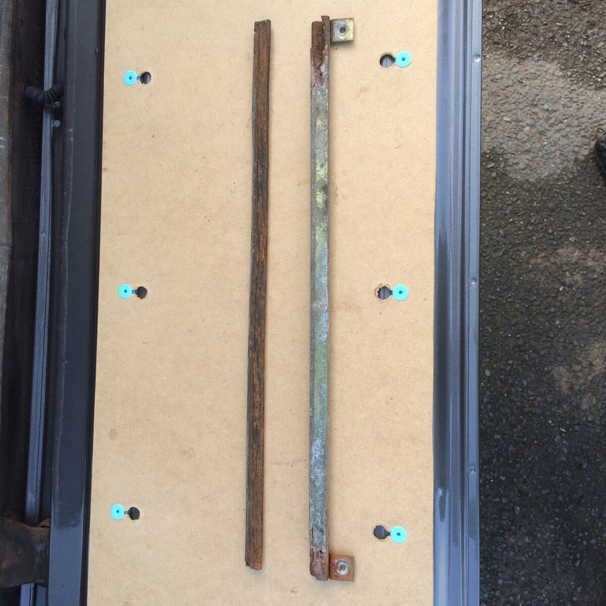

6am, on the way to work, opened the drivers window and it fell off its mounting inside the door. Then it started to rain
A bit of fiddling in a layby and i pulled it out and held it in place by raising the window mechanism.
Found out now that the glass has come out of the rubber as the metal clamp has corroded and the rubber is also perished.
Making a new clamp assembly should be fairly easy, but I found a spare window with a good rubber and clamp still attached. So it wll be a simple job to bolt it in when it arrives.
Hopefully I will soon enjoy trouble free cruising!
