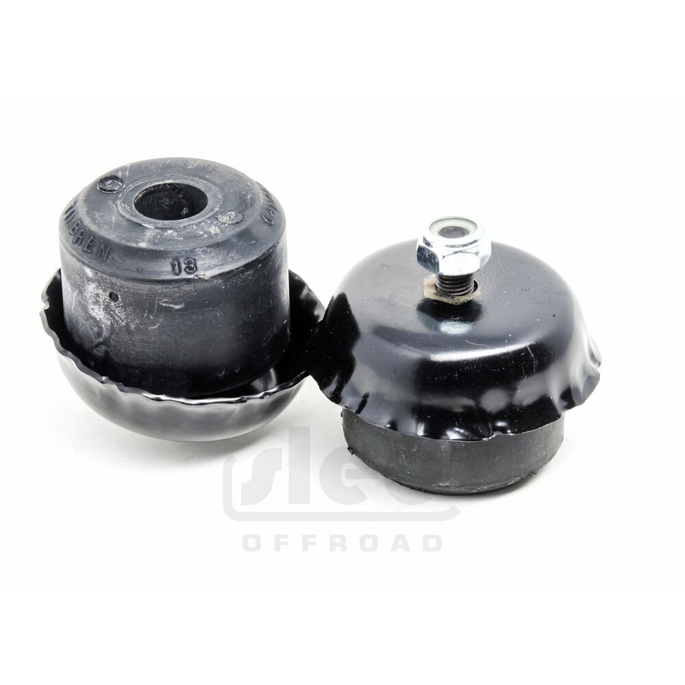

Has anyone tried Timbren bump stops
I was wondering what the difference was between the Timbren ones and a hollow rubber spring of a similar size from AV Industrial, apart from the price?
I can't see much difference TBH.... I suppose Timbren have done the homework and worked out what rate suits the vehicle .... but AV would be able to help with tech advice .
Fiat Ducato vans use a triple convolution "bump" stop on the rear in conjunction with single leaf rear springs .... they work very well and give a progressive rate without affecting ride quality when running empty . The difference is they are mounted over the axle and are designed to be "springs" so the stress is straight down .
On many IFS systems the "bump" stops are just that... to cushion the limit of travel . I'm not sure what using them as a secondary spring so putting load into the mounting point constantly would do for the life of the arms and bushes .... or even if you would start to see cracks on arms . The OE design would be that the bump stop mount is only stressed at extreme articulation or full compression .

I'm thinking to get a pair for the front of my 100 series as bump stops, I recon the 70mm single convolution ones will do the job. I'm hoping it will cushion the impact rather than bottoming out which I've done once or twice off road and it doesn't half stop with a thump.. The AV ones are only £14.99 each which is a huge discount compared with the Timbren ones at about $270. Might just buy a pair and see..
I've gone ahead and ordered a pair of the 70mm AV springs, once I get back to Zim I'll stick them on and see how they feel..

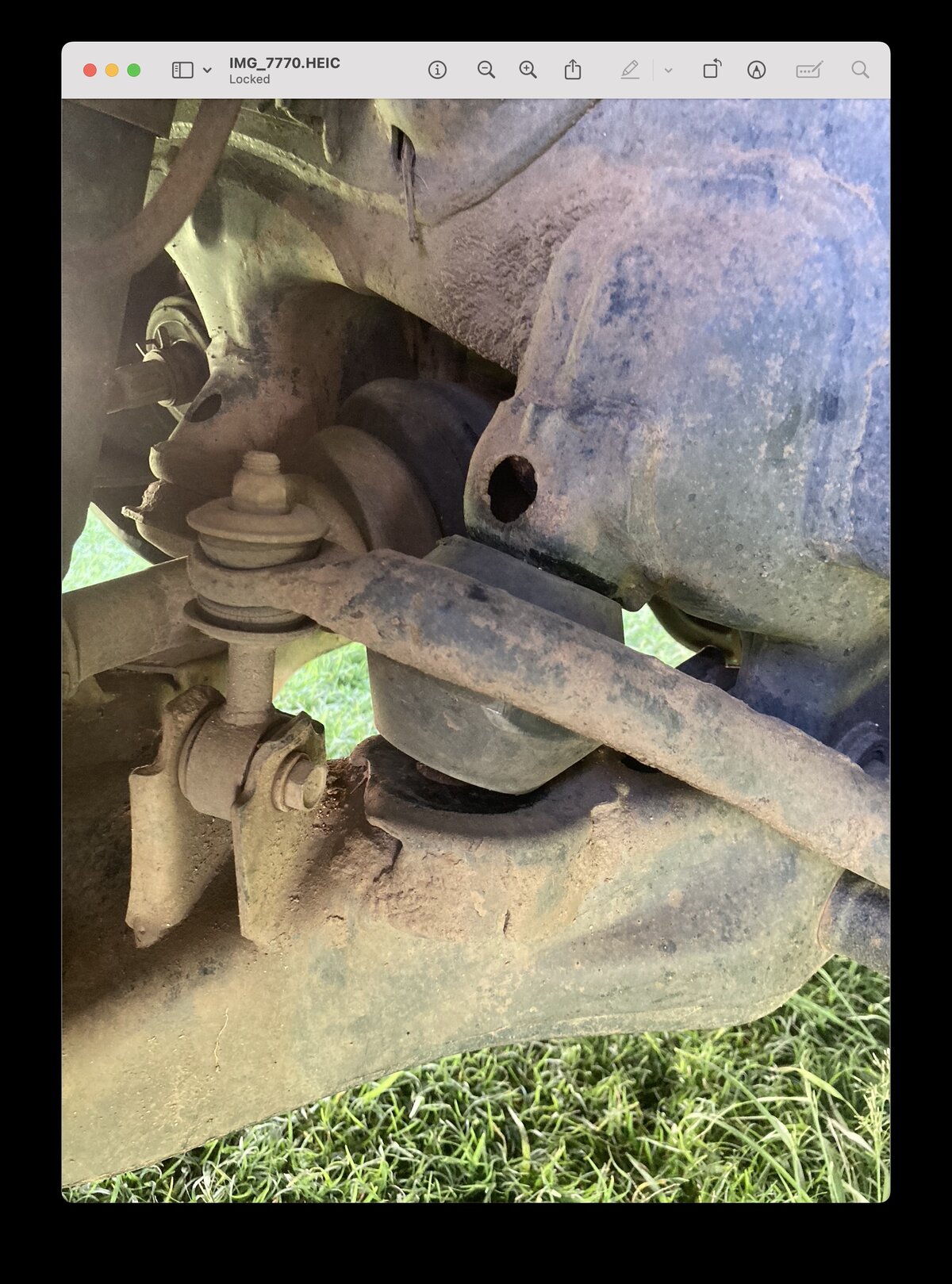

How far from the A arm is the new, taller bump stop when unloaded? 70 mm must be nearly twice as tall as the original one. Got any pics?
That sounds like a great idea you had there. Thanx for doing the research and testing.
Hi uHu, the new rubber spring sits on the suspension arm and deforms a tiny bit. I suspect it is giving me a few mm of lift but I didn't think to measure before I fitted them.. I'll try to get some pics and upload them later.

Here's a photo of the rubber spring installed
