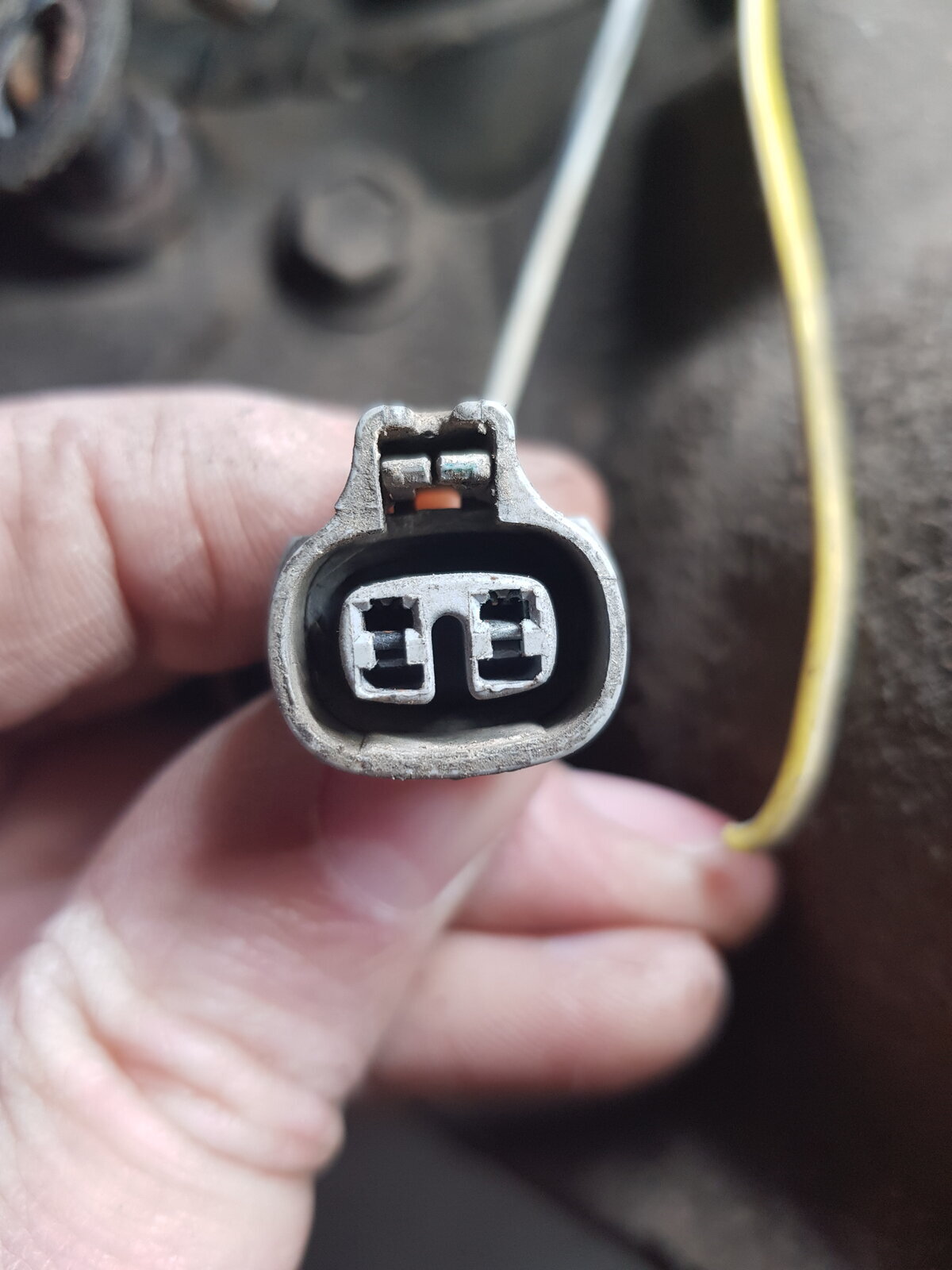

Hi All,
I need to replace the wiring to my rear rear diff locker on my 80 series as its corroded and snapped.
The connector looks like the picture below and I beleive this is the part number for the housing. 90980- 11250
Can any one tell me the part numbers for the pins and seals?
I can buy ready made ones from the states, but I cant beleive it's not possible to buy them in the UK.
Thanks
That looks like the plug for the indicator switch to tell you the diff lock is actuated. AFAIA the diff lock plug has 5 wires to it.
Sorry, yes your totally right. It is that plug that I'm after though
Toyota sell the pins as "pig tails". A pin with about 3" of wire so you can splice into your loom.
Most of the connectors seem to still be available.
I've not been able to find wire repair stuff in any of the parts catalogues, do you know where I can find the info?
@flint looks exactly like what I was after. Even explaining how to remove the pins, super frustrating, knowing there is a method, but not being able to work it out.
