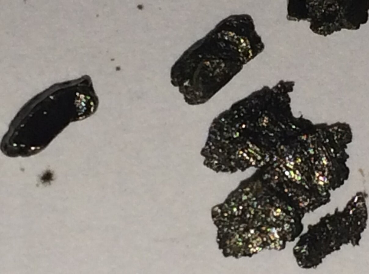

Give the swarf a good wash in clean petrol and dry it out. A good pic will help us to identify exactly what you have.

The majority of the debris are like these: (sorry for the shoddy pic)
Then there are some shavings (just like swarf from a lathe).
I'll get some better pics later this week.

By the looks of that whatever it was has long since been repaired.

I'm still worried that I've got broken gears... But I agree that the debris would have been confined to the sump or even the filter...
If your gears were chewed up like that Justin you would have heard something and hear something now. If you feel better though take the front timing gear cover off and have a look.
Nice to see with your own eyes that its all how it should be.
Agreed, but I need to remove all the timing to get to it, Which isn't so simple...
