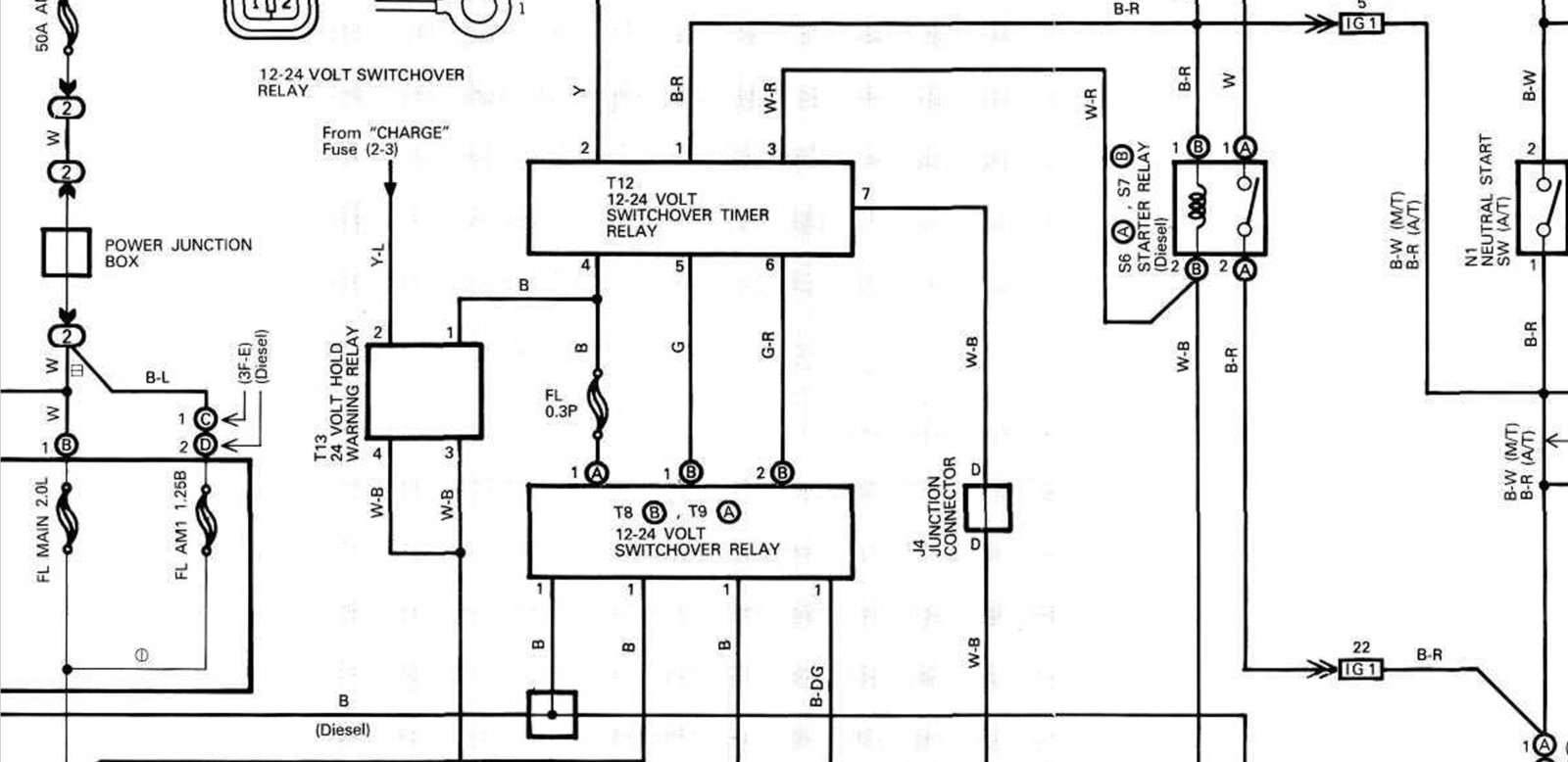

The only thing I would add is I didn't think any of the 100's came with 24v starters, so it sounds like someone has got in there and done some re-jigging although I have no idea why. However, there are a lot of people on here who know a lot more than me so i'm sure someone will correct me....
they're connected in parallel, so 12v but double the amps, very common on big engined diesel 4x4s

So the 100 is different from the 80??
My 80 does the crank in 24v but the electrical system works in 12v!
There's a relay managing this during the start up.
I have an ARB 78Lt with two Yuasa 640 SHD (115Ah 1000Amps) and there's no problem at all to power the fridge for two days...
Yes, the 100, and some 80s, are different from your 12/24 volt system.
