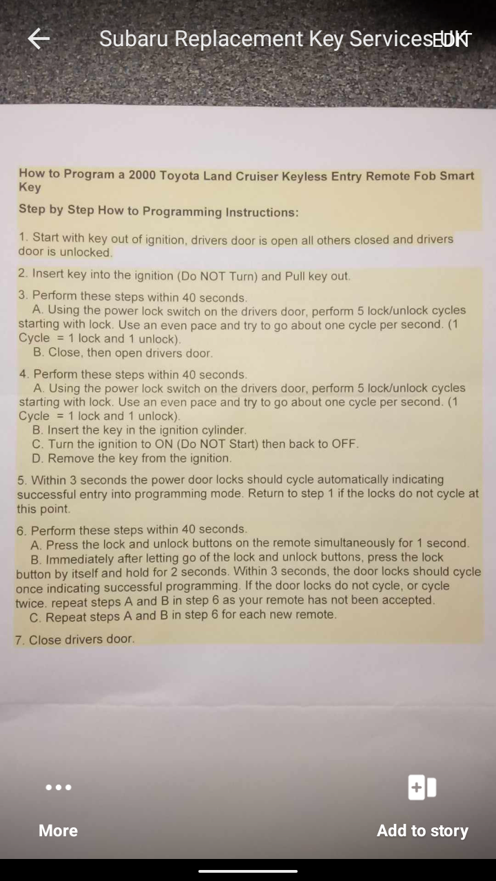

I had new style folding keys made for my 99 Collie and followed the sequence below but found out that every vehicle has a master and valet key. Using a valet key to pair new keys did not work and it has to be a master which fortunately was one I had.
