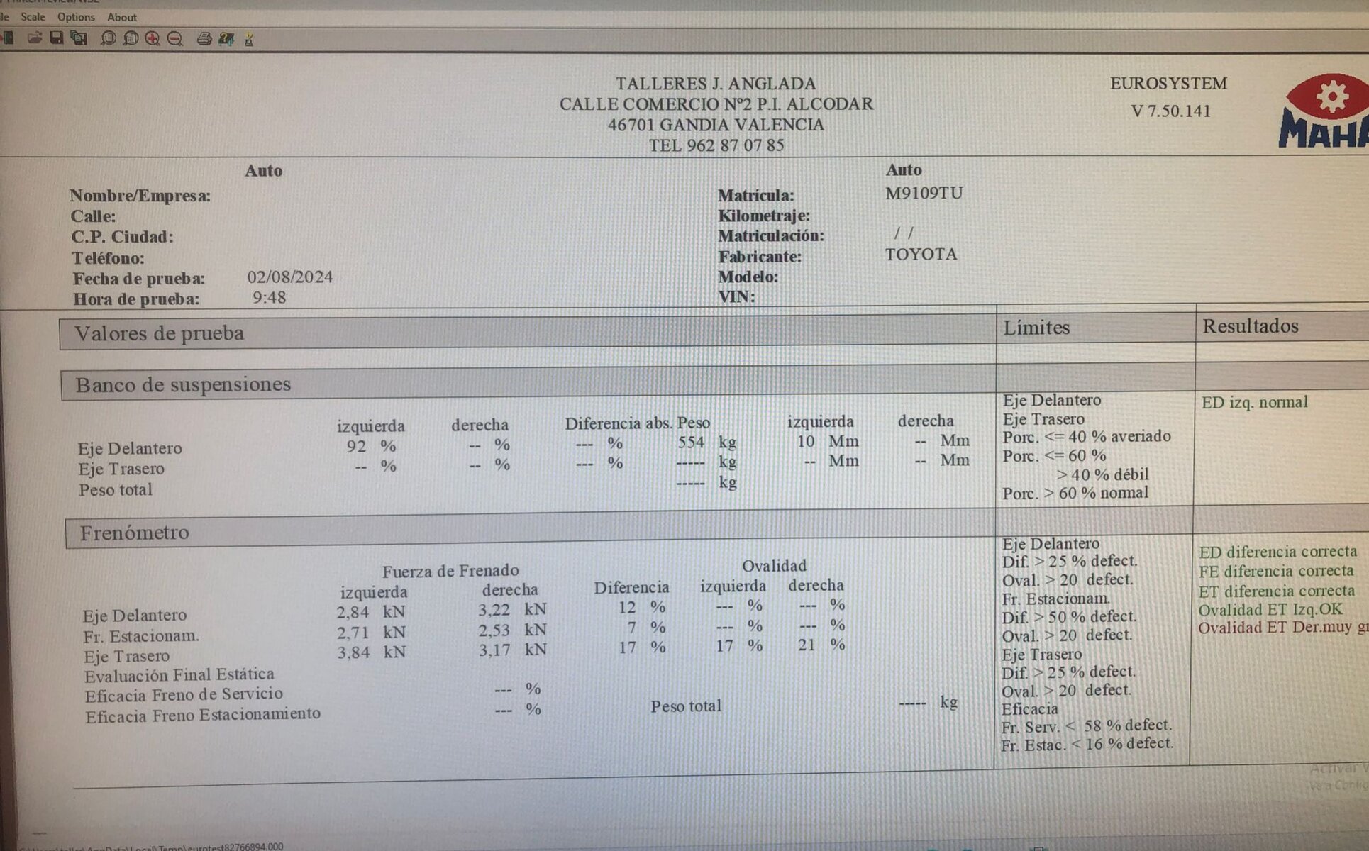

I suspect the same but the Toyota main dealer here doesnt agree. I put it into Toyota after the 1st mot failure. They changed the brake master cylinder seals. Failed again, they then found air still in the system. They put it on a brake tester and gave me the data printout. See attached.

From google translating and looking at the numbers, seems like they are more concerned with the difference left to right of the rear axle numbers than the difference between the front and rear axles?
I dont understand what the 'ovality' numbers mean on the right of the page, as that's what it appears to have failed on.
Could explain why they think the rear calipers, or one of them is at fault and not working as efficiently as it should.
