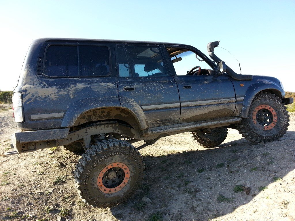

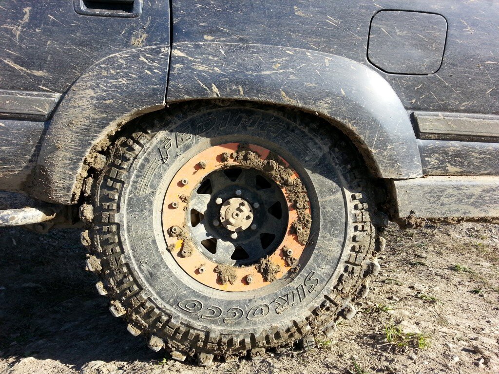

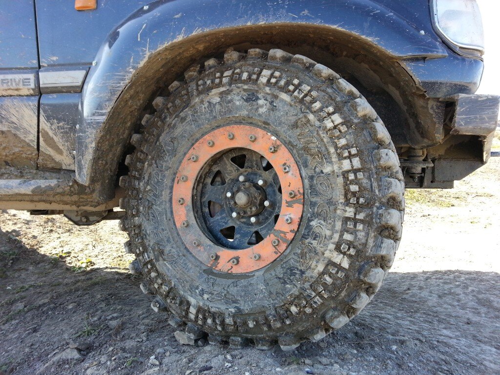

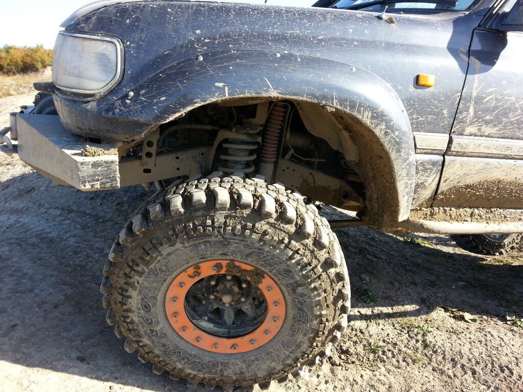

This might help others:
As posted before, Im running Fedima 35x105x16 - in the rubber they actually measure 37.5" x 12 x 16.
Running a saggy 2" spring lift and 2" body lift they do fit although I did have to modify the front inner arches and front flares to stop rubbing, the rears needed nothing but they would wipe out any standard mudflaps etc:
