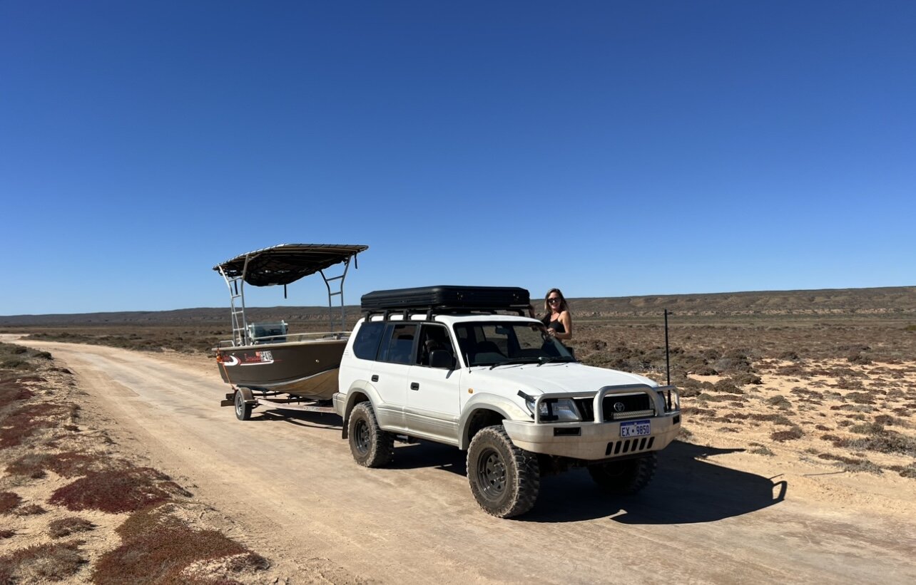

Hi all,
Trying to diagnose what’s going on with my 95 series 2001 Prado. 4wd light won’t turn on, when selecting 4H or 4L and accelerating car will make a horrible clicking noise. Thought it might be CV shafts so yesterday we replaced them.
Also when in normal drive car will make same noise.
Any idea what my next step should be?
Thanks!
