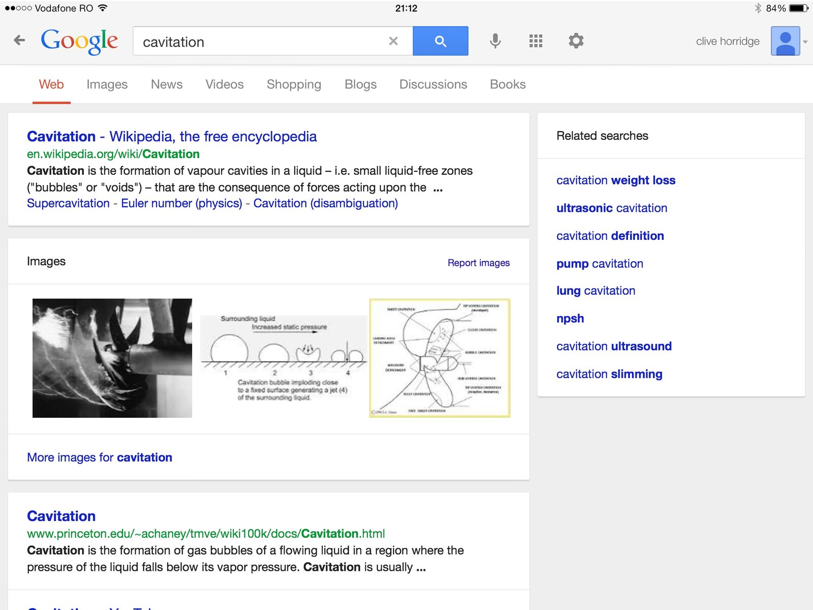

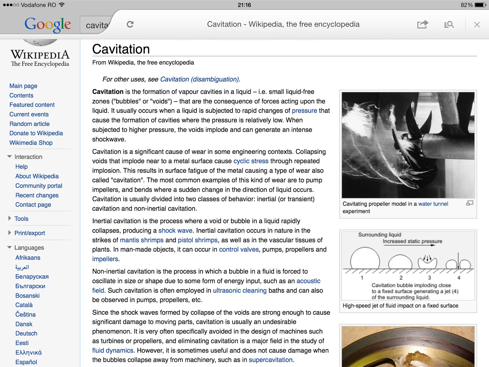

MuckyPup
Feb 20, 2012
125
How many aircraft engineers work on internal combustion engines? Probably just as well they don't, the reason the head gasket holes are a smaller outlet area than the water pump is very simple, it means the cylinder block water jacket is under pressure, pressure ADDITIONAL to the cap pressure.....
(15psi cap + 10psi back pressure = 25psi block pressure)
This is to prevent localised boiling at the top of the block where its hottest AND funnily enough prevent cavitation.......
Not even working for NASA gets a free pass, this is why they have to have everything triple signed on aircraft, too many know it alls.
(Design FLAW, FLAW it's FLAW.., I'm dyscalculic, I'm allowed to point that out.....)
