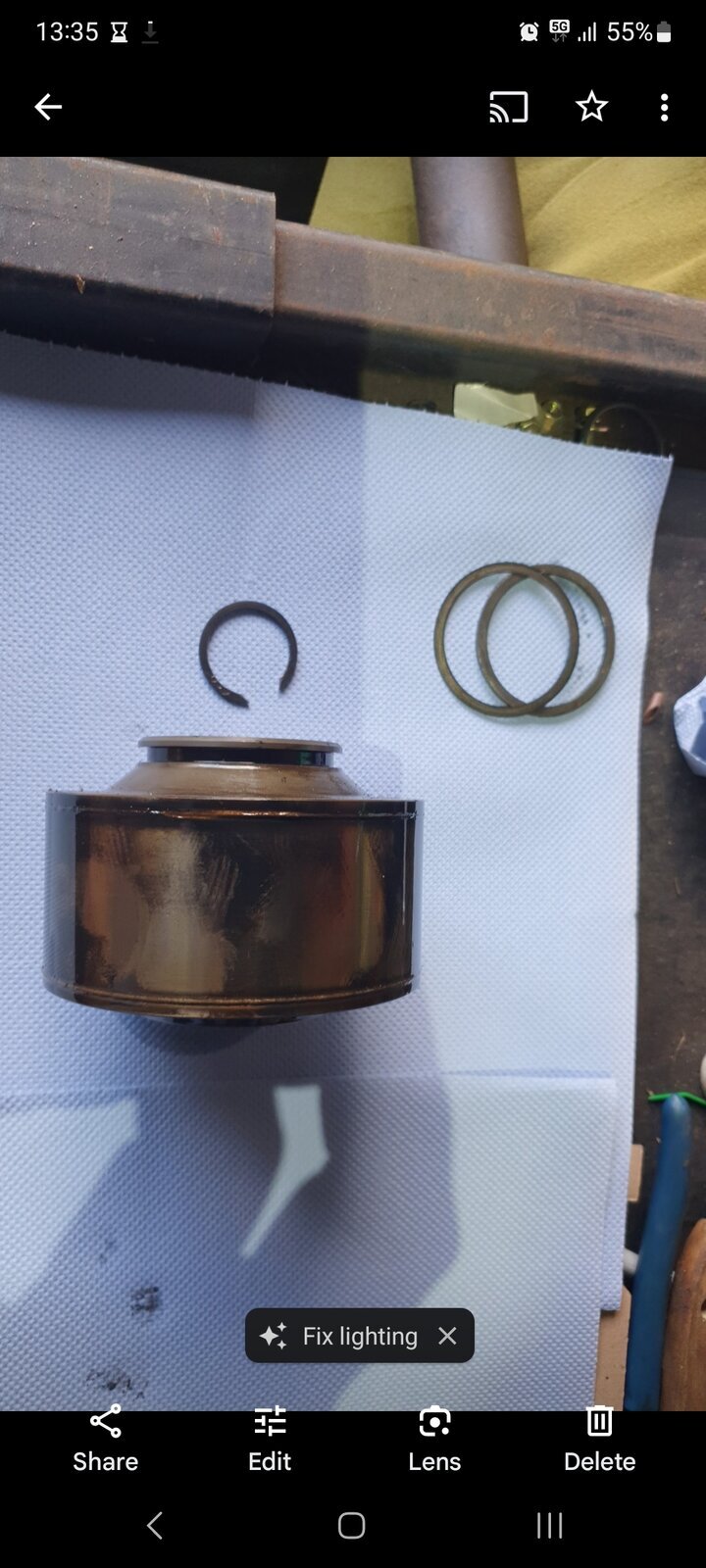

The VC is just a fluid filled clutch stuck in the back of the transfer box which basically acts like a limited slip diff. It's just a set of closely fitting plates in an oil bath that offers some resistance to rotation but will slip enough to prevent transmission windup. The diff will never be fully open as the VC will still transfer some power to the rear axle if the front wheels lose traction. It's a device aimed at improving on road handling and performance in permanent 4wd setups. The 4wd Sierra I had years ago had one.

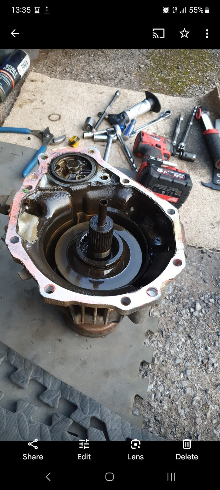

This thing I think Screenshot_20231108_133523_Photos.jpgScreenshot_20231108_133503_Photos.jpg
That's the puppy. I'm curious as to how just removing it when it fails (usually locking solid) makes the centre diff function like a standard, non VC equipped item or does another part need to be added in it's place or another mod done at the same time?
Hi Towpack,
I had a manual 80 that the VC failed on.
It was like driving with the centre diff lock in all the time.
I removed the VC from the transfer case and the vehicle drove fine etc.
I think it would be the same as the earlier transfer box with no VC fitted?

The centre dif prevents wind up re front and rear axles. The VC runs in parallel with the centre dif so if it detects front axle going faster than rear it locks up so drive is restored to the front until a normal patch of road is reached and the VC disconnects. Works the other way round as well. No difference in road holding detected when I took mine out.
