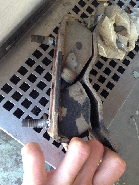

Last major job before our trip, there was an annoying shake coming through the drivetrain at low revs when cold, and also at idle when warm - turns out the rear gearbox mount was shot, so swapped that out for a very expensive OE new one! Old one was pretty knackered, to be fair:
Drives much smoother now, so money well spent I guess! :) Pretty much ready to go now!
I couldn't believe the price either when I had to change mine, but it cured the problem. Usually, IME, the mounts go when saturated with oil, but mine was as dry as a bone.
