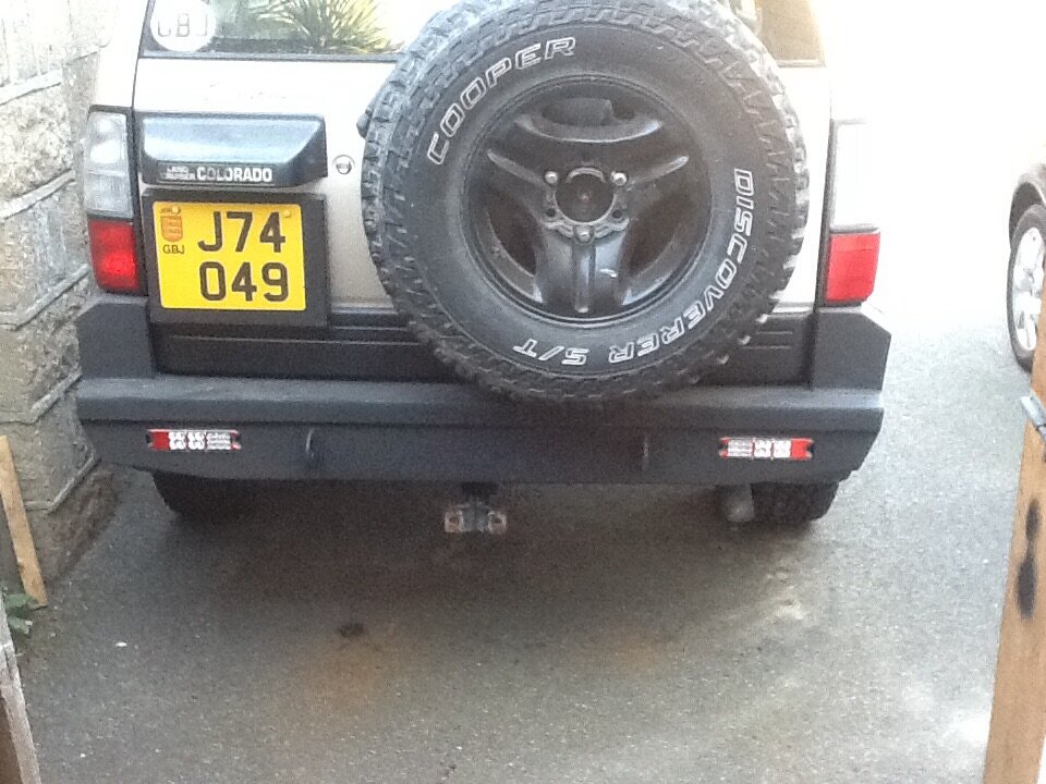

Your right I keep thinking must check the spare wheel but get carried away and forget, thanks for reminding me lol.Hi Andy,looking good just a question but does your spare wheel still fit buddy.

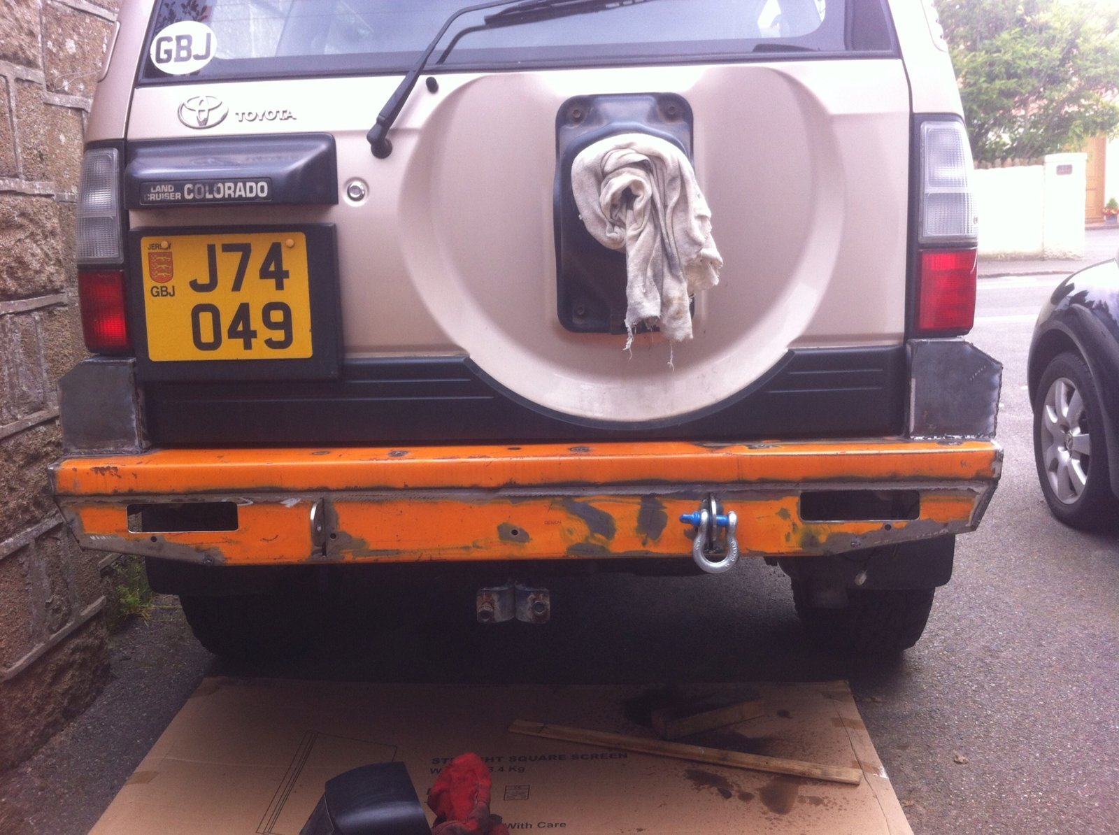

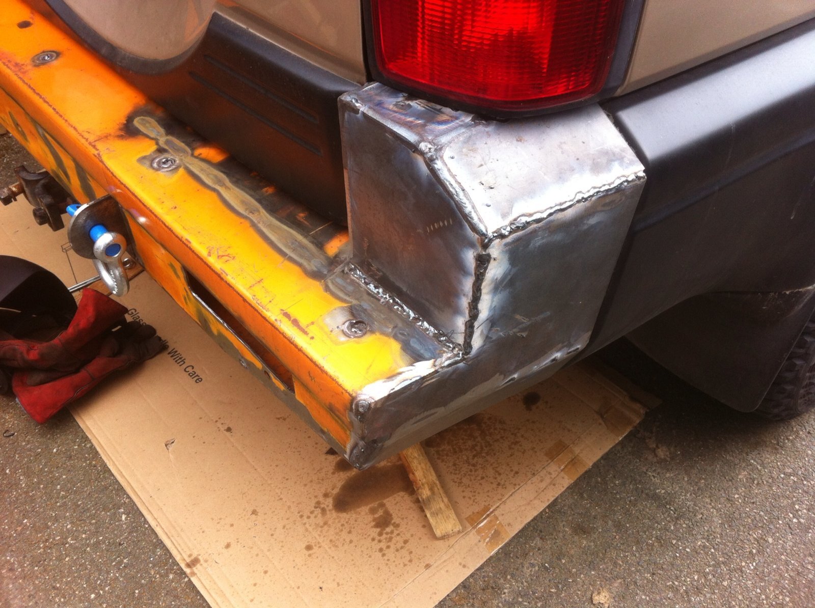

Yes really struggling with the joins that meet the trim that runs down each side of the truck, was even considering using the original plastic bits! But once I've done that there's no going back lolIt's hard to imagine how it will look when finished Andy but it will be interesting to see . I have spent a long time looking at bumpers for the collie and as you know i have finally chosen a front one but there is even less choice for the rear and those i have seen were dismissed at a glance .

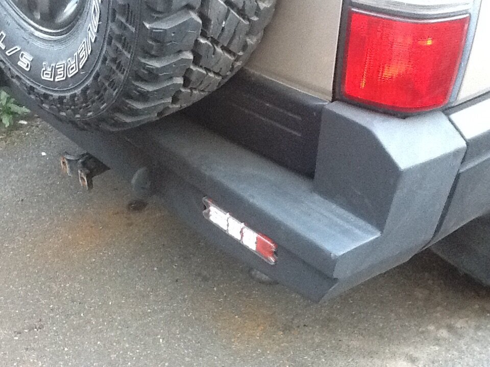

Shayne there are som interesting rear bumpers here http://www.4x4time.com/Israel4x4+topic212+page8 you will just have to brush up on your Israelie to read the textIt's hard to imagine how it will look when finished Andy but it will be interesting to see . I have spent a long time looking at bumpers for the collie and as you know i have finally chosen a front one but there is even less choice for the rear and those i have seen were dismissed at a glance .
Ha, ha, that's Li'l Blue (RIP) in the third and fourth photos on that link, if I'm not mistaken ....
Thanks Tony, what's the connection with the South African flag?Ha, it is and I think I was driving that time.
Andy, there are some more pics of Lil'Blue I took just before I sold it on, with a few more of the back bumper, which may help you:

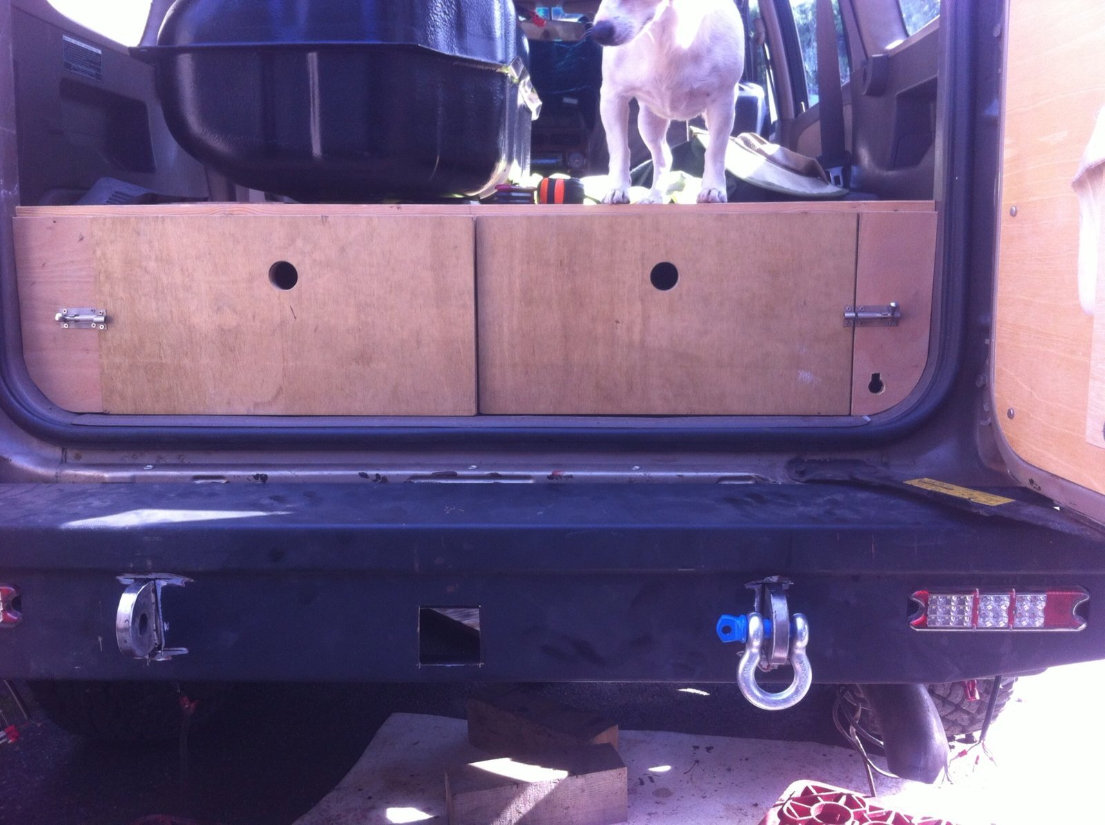

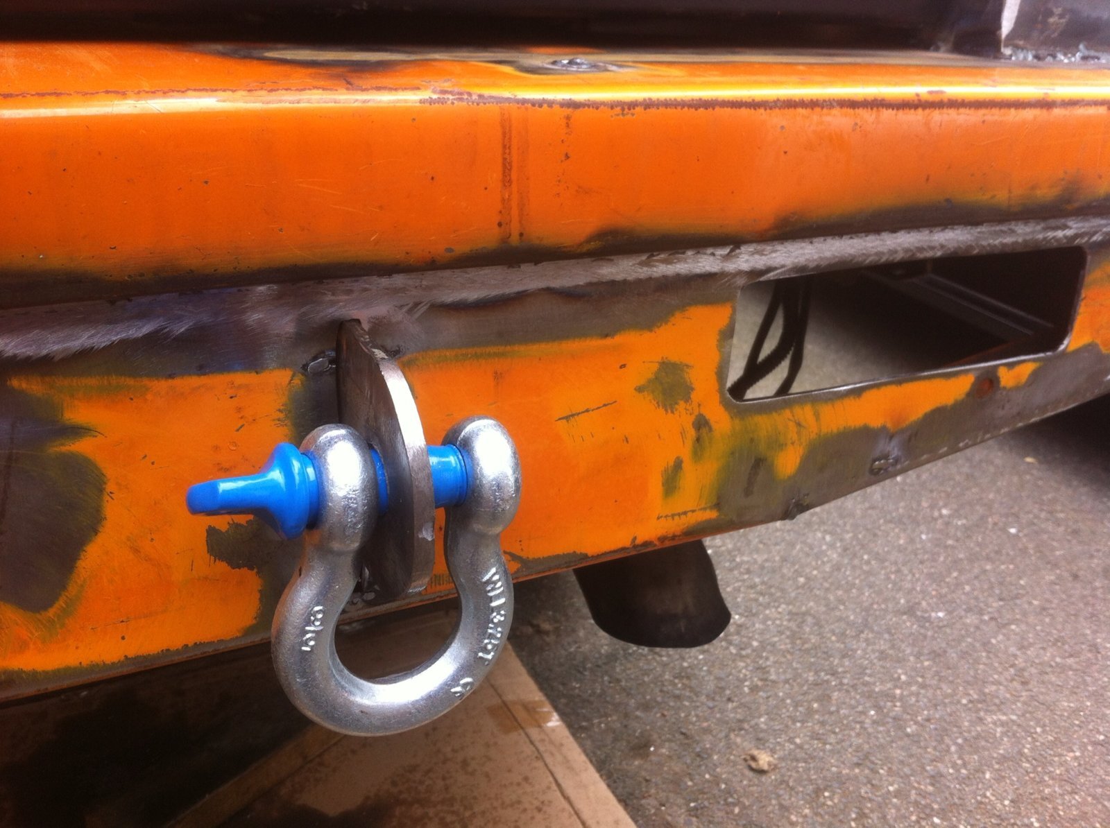

Hi thanks, really pleased with it so far. I did consider thickening the eyes but there attached to the cross member part of the chassie, the one with the big round wholes in about 2.5mmm thick. Have now bought a section of American 2" receiver and will use that as recovery point, once welded to the existing toe bar bracket. The eyes will be for show or hi lift jacking points with a shackle.That looks really good Andy. Looking forward to seeing it in black. However, my only observation is that your recovery points which I'm guessing are the ends of your mounting brackets, look rather skinny. Most I have seen are around 12mm to 20mm thick. Yours at 6mm could tear through if really used in anger. Not what you want to hear when you've just completed it and painted it black but even less do you want a flying shackle in a recovery situation.
