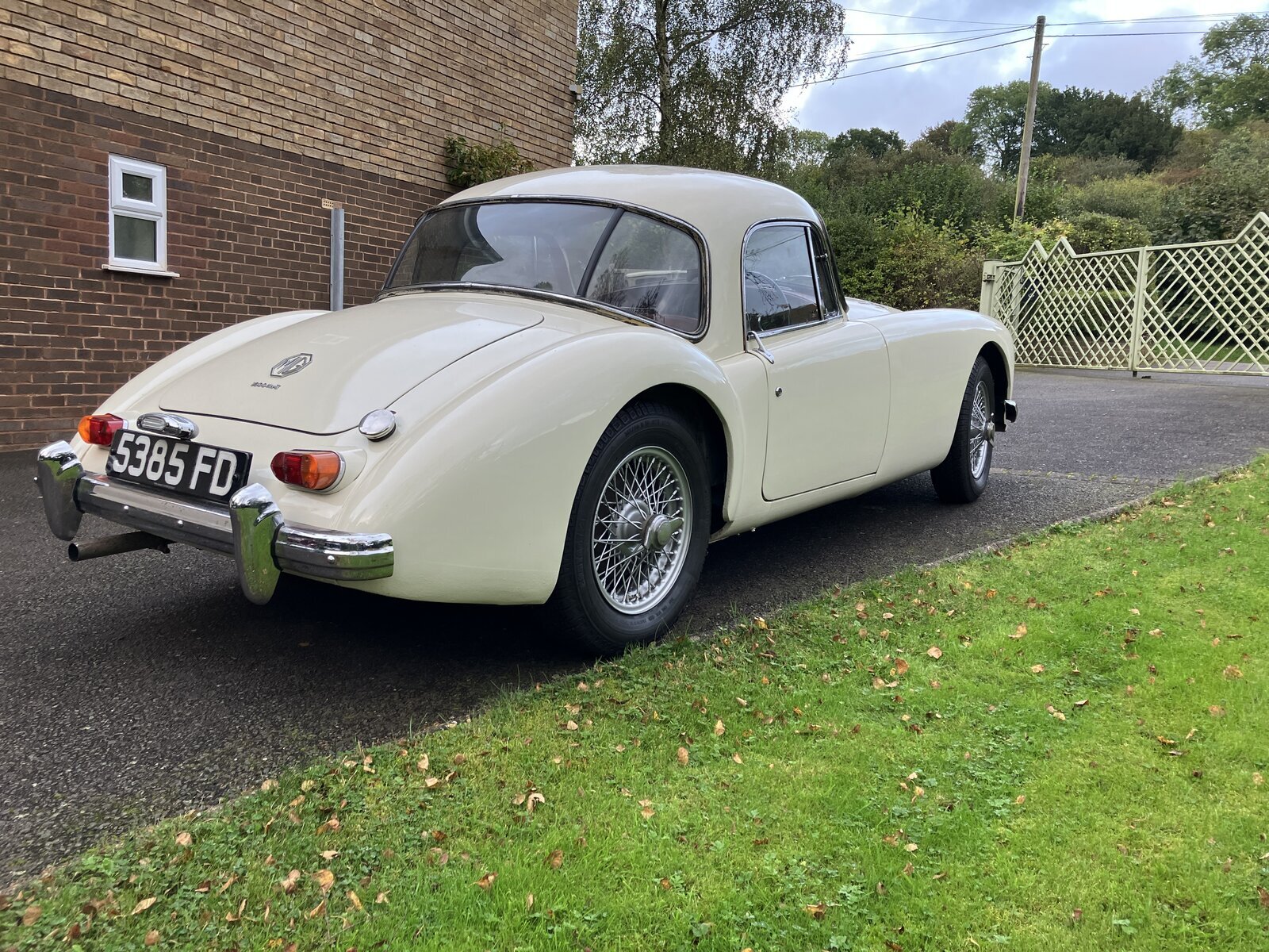

Sadly however, I have decided to part with the HJ45. I had planned to keep it as a long term project. However, the unexpected passing of a friend meant that I had the opportunity to purchase an MGA, owned from new from the diseased.
Subsequent negotiations with the wife means that the HJ45 needs to go, so I will be putting it for sale soon. It will however leave a void, having experience the practicality of a pick-up truck.
On a positive note I will be keeping the HJ60, which is very dear to me.
Nick

Believe me if I could keep them all I would. But I had to make a choice and the sentimental value on this one is greater.
img_2646-jpg.333839
Probably won't be as good greenlaning though.
Nick
