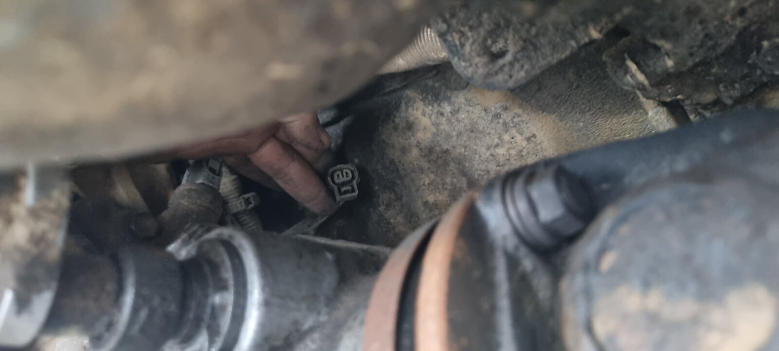

It should be the detent switch on the back on top of the transfer box. Unless yours has had the 11 pin movie done. This I know nothing about I'm afraid.
Mines just got the little one unplugged

Aye brain fart on my part I was doing all the testing assuming I plugged the one back in after Snowdonia and I woke this morning thinking why did I see two lose plugs . Midgets invaded so I got no further than plugging the transfer back in but I will try the paerclip diagnostic again tomorrow.
