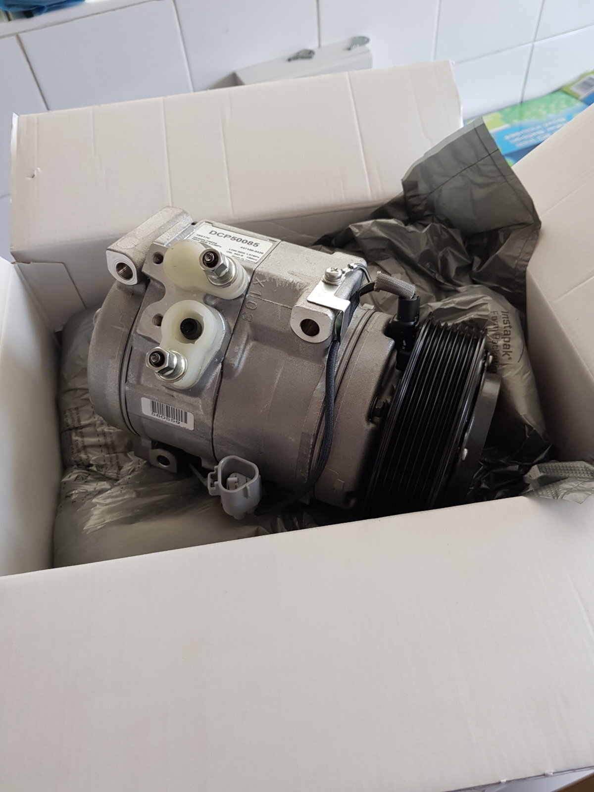

But look what arrived for me today

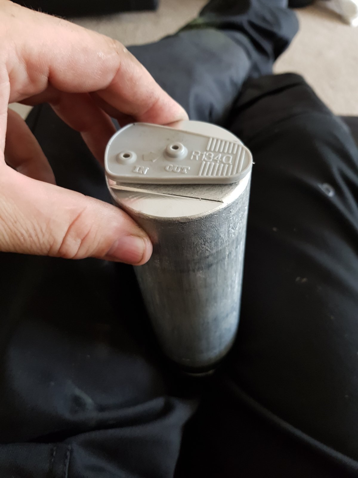

To bring this up to scratch
I have now got the reciever/drier.
Now I have had a look in the engine bay and traced pipes but I cannot find the drier?
Does anyone know where it is?
