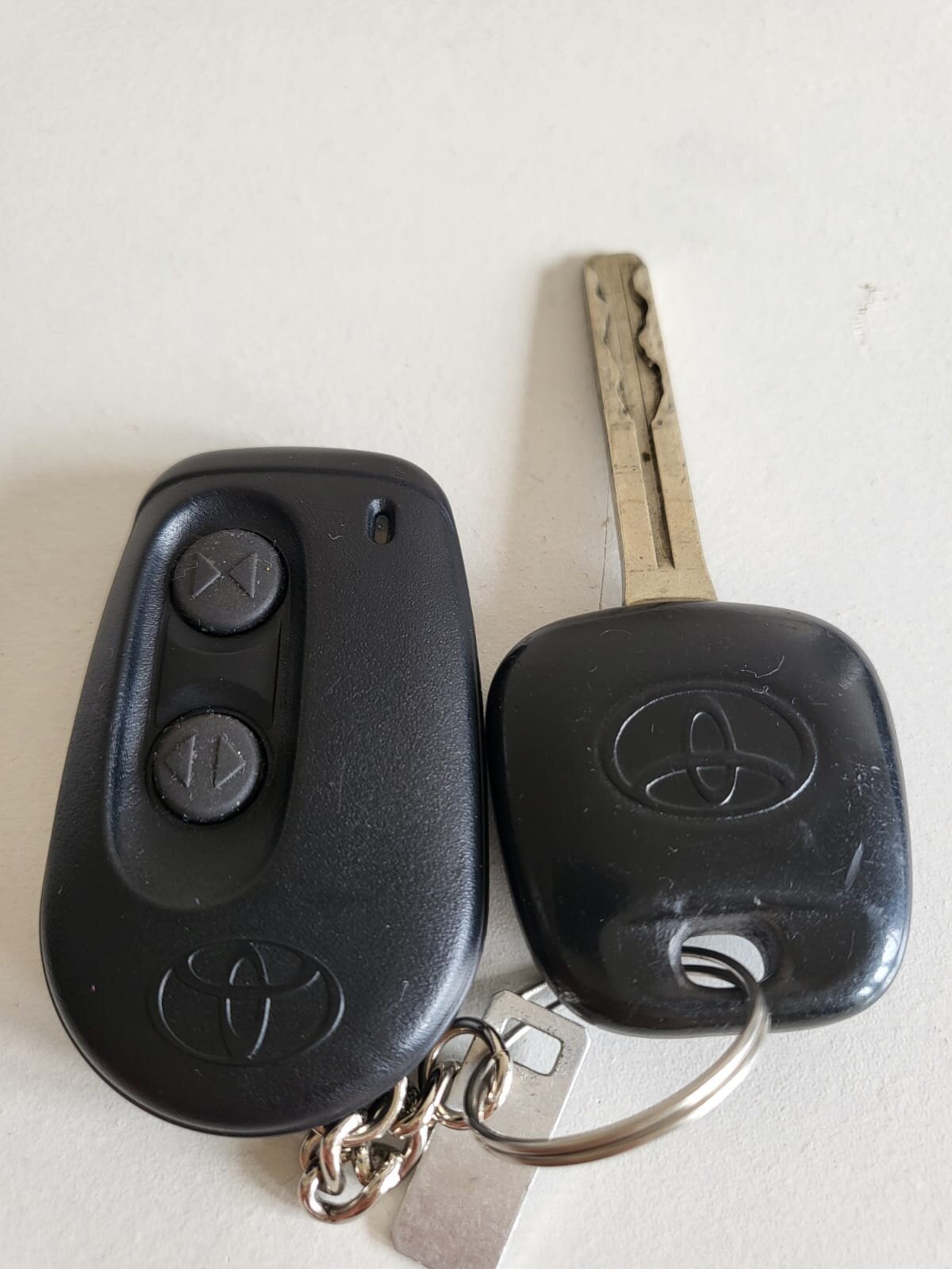

I recently bought an 80 series and I don't know if it has an alarm or how to check it, also the central locking I don't know how to set it, I also changed the batteries and it still doesn't work, can anyone guide me how to check it? Thanks in advance.

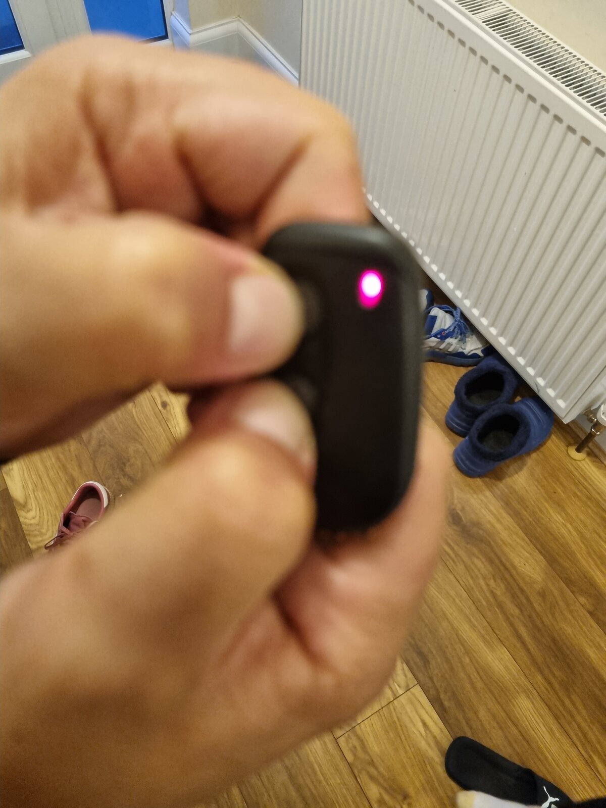

First things first. When you press the buttons does the little red light come on? If the fob isn't working then we're not going to get very far.
If the lights come on then that's a start. It just means that the alarm ECU and the fob aren't talking to each other.
That looks like the TVSS which was fitted to the 80 outside of the factory, but effectively commissioned by Toyota
It was professionally spliced into the wiring loom and a sounder fitted, typically in the wing. There is a battery in there that over time dies. It is actually replaceable with a bit of fettling but if the siren etc had had it, then frankly it's a waste of time trying.

So, light on the fob yes no
If yes, try pressing and holding both button at one for a few seconds. This can sync the fob to the car.
If no, then we need to go deeper into the system

Yes, as Chris said that's a TVSS 3B alarm fob. The same system was also fitted to some other Toyotas, Avensis for one, of the same era. My siren gave up the ghost some years back but I got hold of a used one from an Avensis, changed the rechargable battery pack and it's worked a treat ever since. If you can't get the fob to "talk" to the ECU it may need re-pairing using the "program" switch on the ECU unit.. I've found that if the FOB battery is low it may still light the LED but not set/unset the alarm so try a new battery even if the LED lights but nothing happens. Also try cleaning the battery contacts in the FOB.

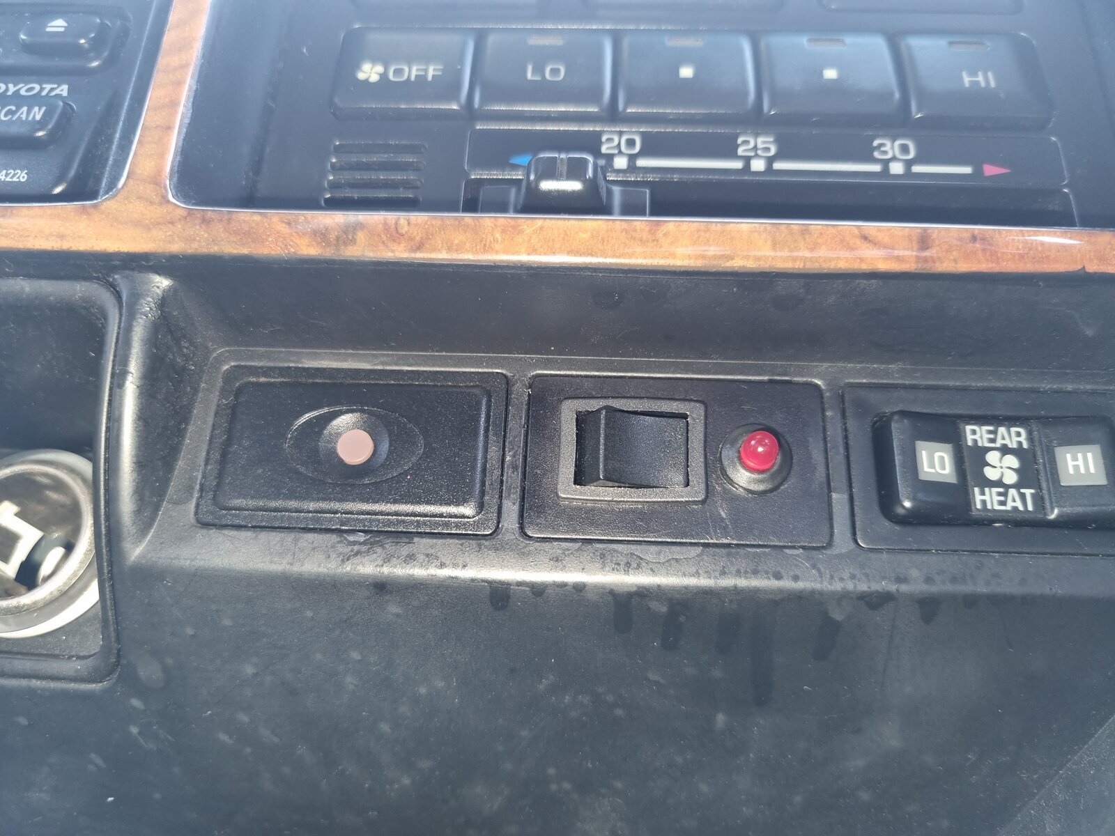

I changed the batteries 2x, it seems to have power. I followed a tutorial on a model similar (my is 97 followed 98) and it says that I have to look under the driver's seat for a module where it has a reset button, but I don't have that module under driver and passenger also, I'm still confused because I don't know where to look and what to do

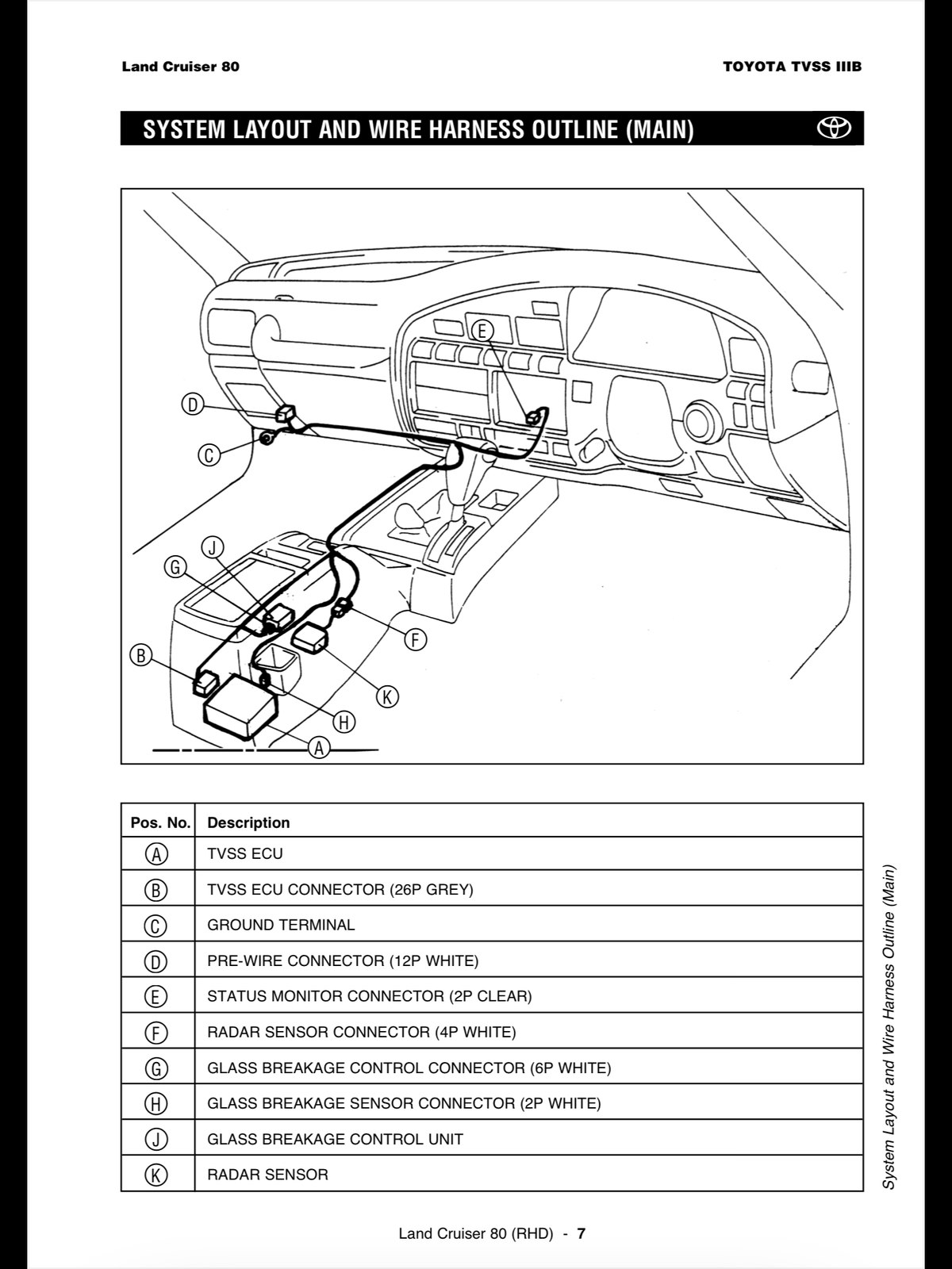

Module is under the central cubby box typically. Not the seat. I actually have the full installers manual for the 80 series TVSS somewhere. I'll see if I can find it.

New fobs can be added (max of 4) to the alarm ECU and old fobs removed but access to the ECU is required plus the vehicle ignition key. See the attachment in post No. 5.
