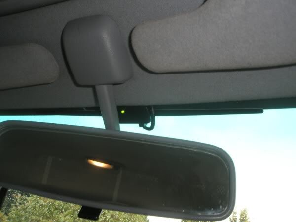

This is what you want :D
sae70 said:
I also finished installing the internal boosted radio aerial & it works a treat so very pleased with that :thumbup: :D
As featured on page three of my Garage :) Clicky is in my signature :thumbup:

sae70 - where did you get that from if you don't mind me asking...?

sae70
Aug 10, 2010
2,643
I bought it from my local motor factors :) It was about £12.50 from what I can remember :) The first one that I bought was fubard :twisted: A little annoying but Im pleased that I got another as it works really well :thumbup: I've just disconected the OEM aerial & pushed it down never to be seen again :D
