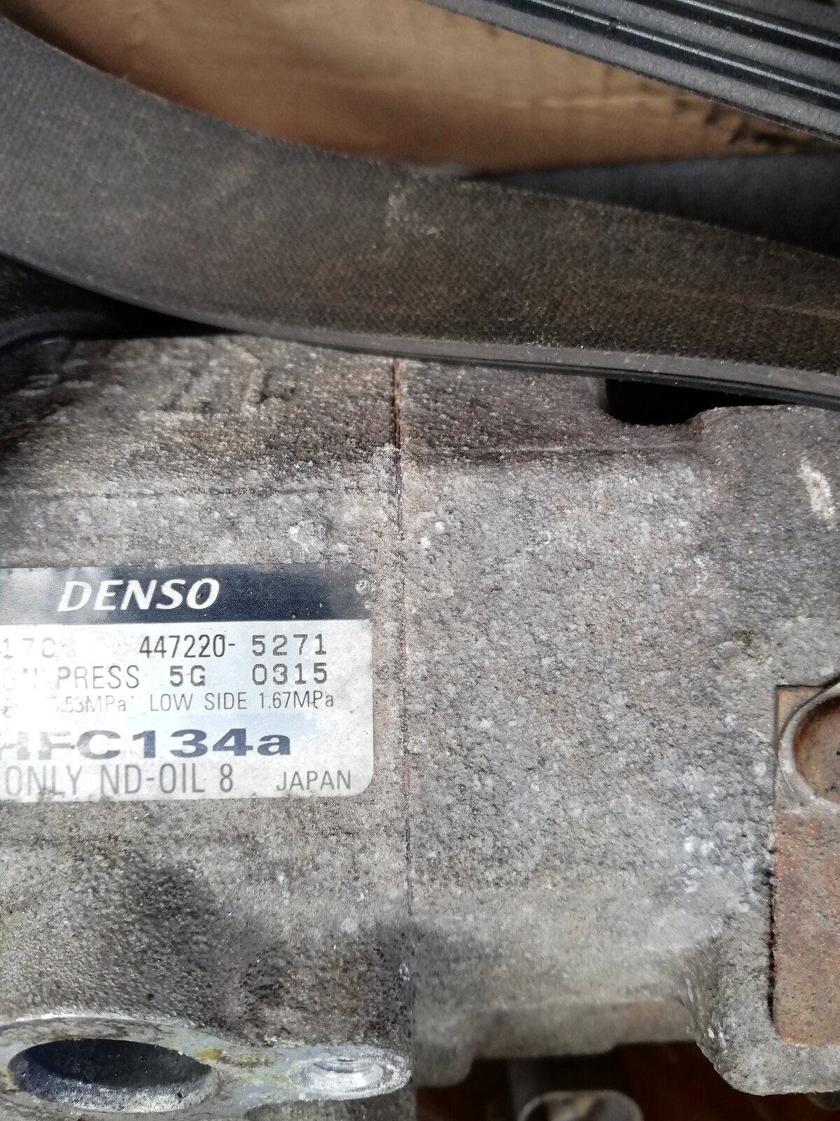

tony rodaway
I am in uk
Aug 28, 2016
446
179
43
liverpool
I have finally got my old air conditioning compressor off and replaced with my new one.
I think the clutch has packed up but I want to repair it but can't find the clutch kit I need. Any ideas we're to look and my part number is below.

did the new compressors contain pag oil?
It was a pattern part I believe and was brand new in the box and yes was oiled up fully.
Works a treat and the moment you put your compressor on it works as it should.
Since I have never had aircon in this car it makes a big difference and the rear aircon in the back is ice cold.
Big savings for a fully working compressor for £200.
