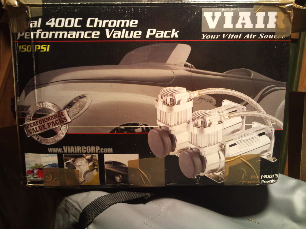

Or if like you, you buy something nice you can get high pressure, high flow.
These little compressors blow on the upstroke, a valve closes, they draw new air in and blow again. So you get a pulse of air. If you fit a tank, this gives you a collector which damps out that pulse as you are not drawing from the pump, but the cylinder. If you have TWO BLOODY POSH PUMPS then effectively you damp the pulse even more. If you could get one to blow while the other is pulling in air then you'd get no pulse at all. But that's not going to happen.
Paul is right about hose pressure, but the point is that little pumps will NOT stand that back pressure. You will bust them if you run them with a closed chuck.
