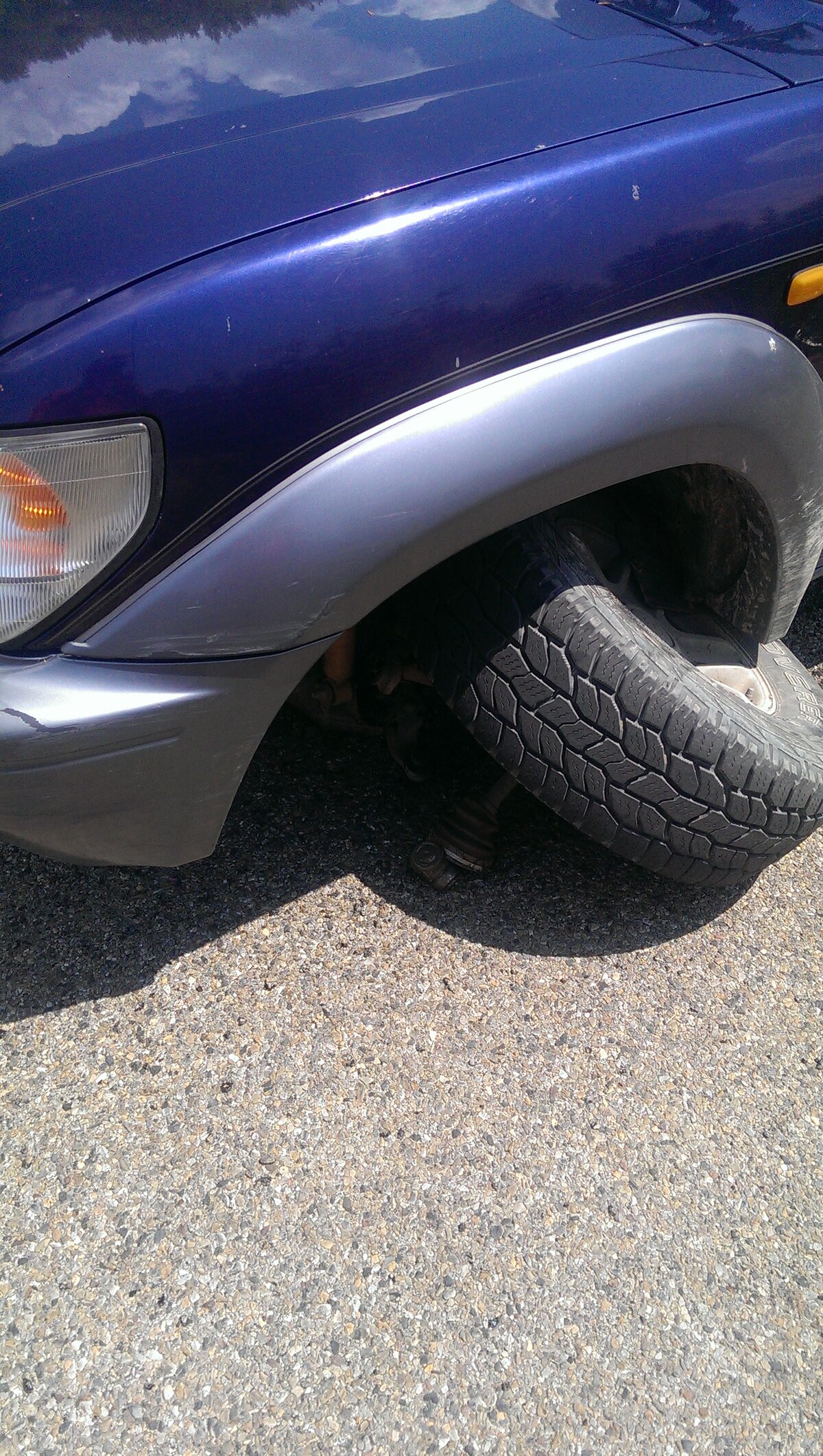

Again another lower ball joint failure on a 90 .Luckily no one was hurt.It let go with with very little warning - a bit of vagueness in the steering & then it went.As you can see from the photos it was on a lane at low speed - the previous weekend i was hacking up the motorway at a steady 85......i then spent 2 hours waiting for the breakdown wagon & an hour & a half lashing it back together so we could load it.:angry-screaming:

The toyota workshop manual suggests that you measure the vertical play with a dial indicator , mounting the magnetic base on the caliper - more than 0.5mm (20 thou ) & its scrap.it also suggests checking rotational resistance with a torque wrench 0.1 -2.5 nm .the problem with all this is that if its seized you cant tell.one thing that i find puzzling is that it failed on road & not on my "driveway" a rough track that needs low box to negotiate .

I had heard of a couple of failures before mine went - when it started to tighten-up I was pretty sure what it was.
Its not a good design with the joint being under constant extreme tension, the 100 and 120-series have a much better design as the 'nose' of the lower wishbone pokes into a 'stirrup' on the bottom of the Steering Knuckle with the balljoint underneath - where it is in constant compression.
