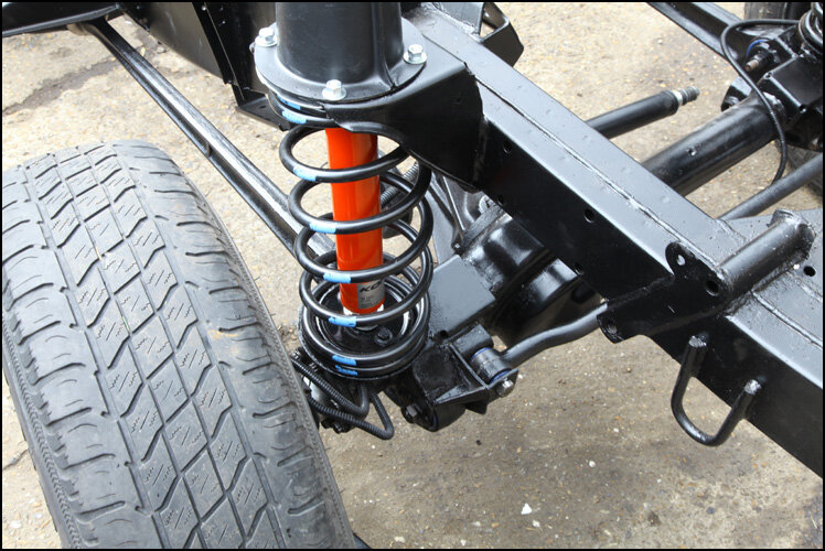

How time flies! I built a new RR in 1980 REA 938W from mostly 1973 old parts but with a new chassis and body. There was no chassis number so I stamped it CFR 1 and this appeared on the log book when the Ministry of transport sent it. An inspector came and I had to pay car tax on what we agreed the value was. I can't remember what that was now. There was no engineers inspection on what I had built but the Police came to check the finished vehicle for stolen parts. I did over 200,000 miles in it in 6 years. Very very simple and lightweight machine and very easy to work on. I could strip the engine in a day and remove the block from the gearbox. I could easily walk around carrying the block.. Most of the body was aluminium but the inner body was steel but like Meccano. I was astonished at how good the road holding was especially on a fast bumpy corner which not unnerve it at all unlike the 80. No rust appeared at all as I had used my spray gun to spray a mist of diluted waxoil into all the new chassis and body parts.
