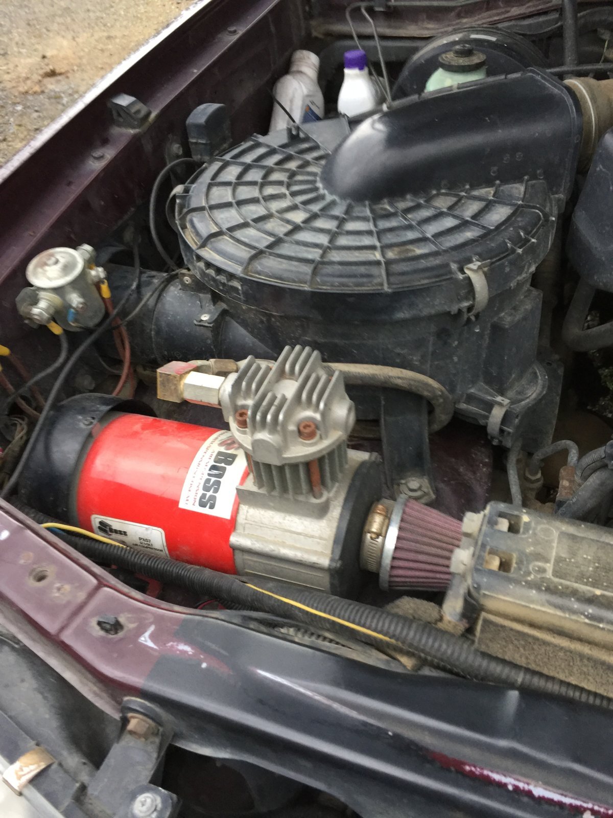

Mine's in the engine bay too
Thanks @Chris . Wow do all 80's have that much space there or did you move something to fit it in? I think i'll have another look because getting it into the engine bay really would be good.
Mine is a GS with no ABS. Otherwise there'd be a great big silver box there.
Mine is only a single ARB pump, so less than 1/2 the size of Chris'.

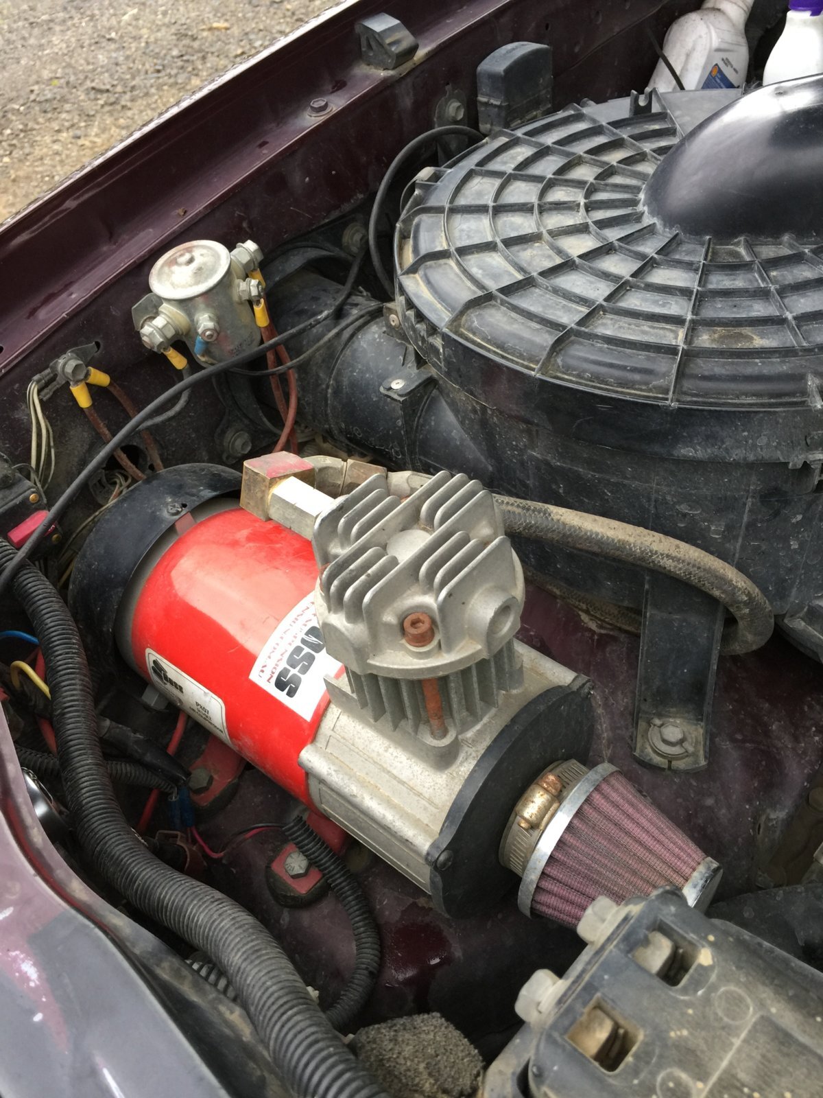

There's loads of room available in my engine bay, I was kinda spoilt for choice.
It's bolted to the wheel arch, as close to the inner wing and the bulkhead as I could get it....
It's on the passenger side, mine's a LHD so that's on the left as you face the truck.
Very sunny today, so not easy to get a shot without shadows...
It's also pretty dusty in there at the moment, haven't cleaned the engine bay in a while ...
Thanks @clivehorridge really appreciate you taking the time to do that. Everyone else seems to have a lot more space in their engine bay the me. I'm looking at the small one too and looking at your photos they really are quite small units arent they. I'm sure i'll be able to find somewhere to squeeze it in.

Nick, there is no space in my 105 engine bay either.
So, what is in the big space in my photo, between the air box and the bulkhead? I could mount 2 more batteries there, or an air receiver tank?
It's warm there, above the exhaust down-pipe, but otherwise vacant.
I think its because yours is left hand drive @clivehorridge which seems to have a much better engine bay layout than the RHD.
On mine the area where yours is mounted it taken up with all that useless steering/ brake/ clutch nonsense
and on the other side are the fuel filters and something else (AC?)
so basically theres no room at the inn for baby ARBcompressor
