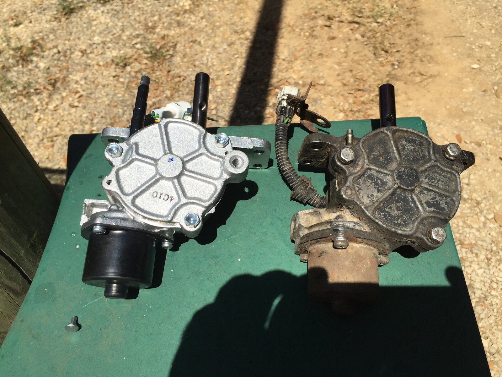

New proper wheel nuts and rear diff lock have arrived, just got to make time to fit them now. It's too damn hot here right now to work in the afternoons, 33 today, going up to 38 next week.

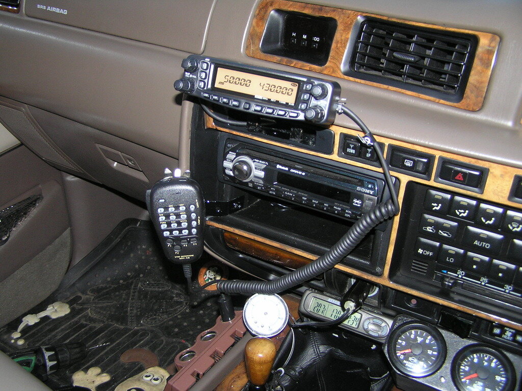

Today I made use of that little slot above the radio which if you are lucky has a cup holder.

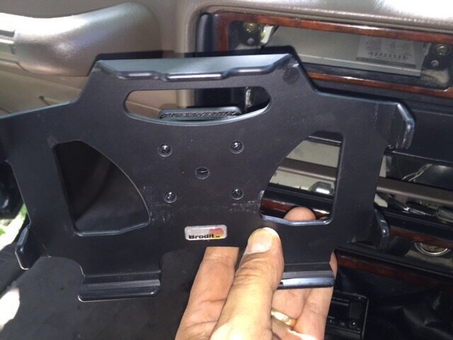

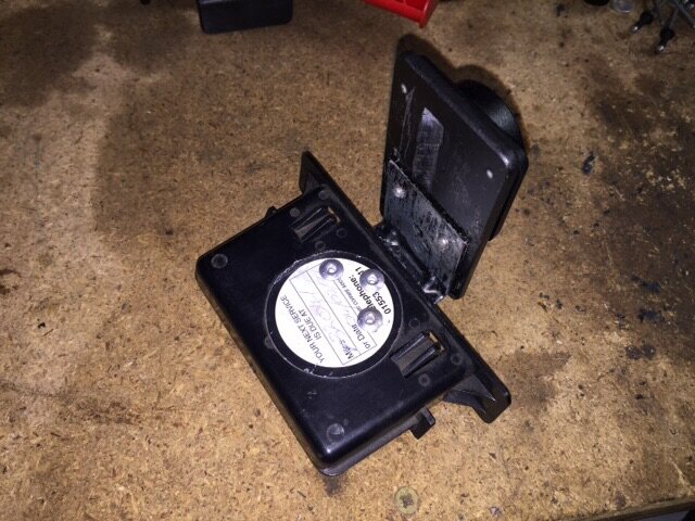

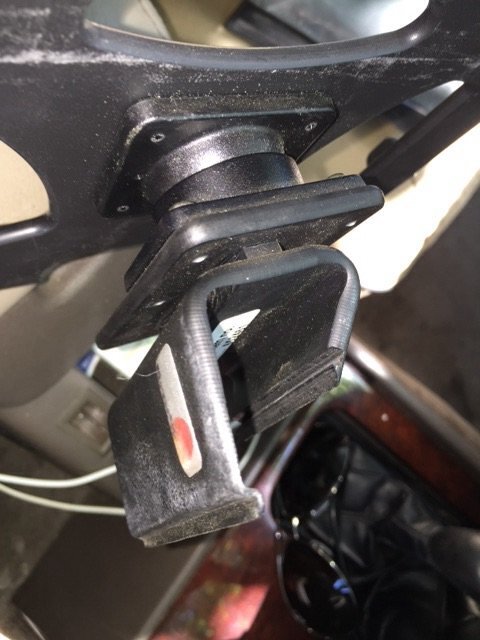

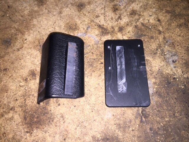

Since I removed the original radio, my Brodit iPad holder no longer fits. For those that know them, they are 3 part. One fits the device. That screws into a ball/socket affair which in turn screws onto a piece of plastic designed to fit the particular car. It's a very good design and I've had several for different cars. All have been robust and solid mounts.
this is what I couldn't use anymore and how it used to fit. It simply clips in gaps between the trim.
This is it close up
Whilst it is a good design, the only issue was that it covered up the radio and made it hard to get to the controls.

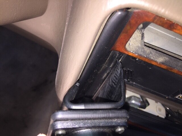

So I took it apart and cut off the bit I wanted, which is on the right

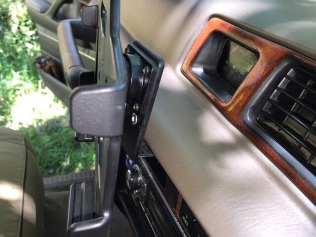

Then, using a simple angle bracket, it riveted and araldited it in place on the upper edge of the plastic form (funny where they secreted the next service history date in the early days of its life)
This is it, in place
And this his is it from afar
I'm quite pleased with the result. It's pretty solid and now above the radio pretty much in the right place for me as we have the garmin stuck to the windscreen normally

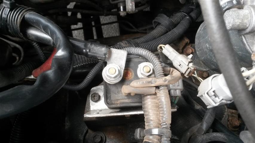

We decided to go away for a few days and the blooming Tmax split charge solenoid seems to have gone kaput. does anyone know of better replacement ?

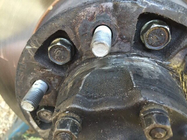

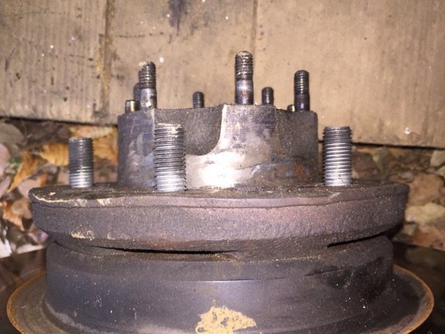

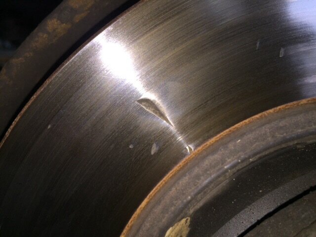

Today I had the tyres rotated front to back and discovered the Portuguese technique used to re-attach the front disc and hub assembly :shock:. The must have been a truly BFH with a BF idiot on the end of it :oops:. Brand new genuine disk it was.

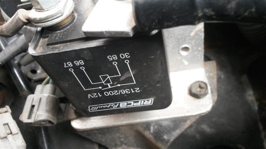

I replaced mine with an ordinary relay. Here it is (took cover off for photo) sitting where the 24v swap over relay used to be....

Well, today I took the damaged disc and hub off for close inspection and found that not only did they put the disc on crooked and have to hammer it home resulting in huge distortion of the face the wheel clamps to but also, they ground off the hub centric lip on the hub :icon-eek:. Can't imagine why as the wheel located fine when I worked on it.
photos don't really show it too well but anyway :cry:
sadly, I'm off the road until new parts arrive.
on the upside, fitted the new rear diff lock yesterday.
With animals (and that's an insult to an animal BTW) like that around, I feel justified in my dogged attempts to maintain my truck myself. It makes all the work and swearing worth while.
