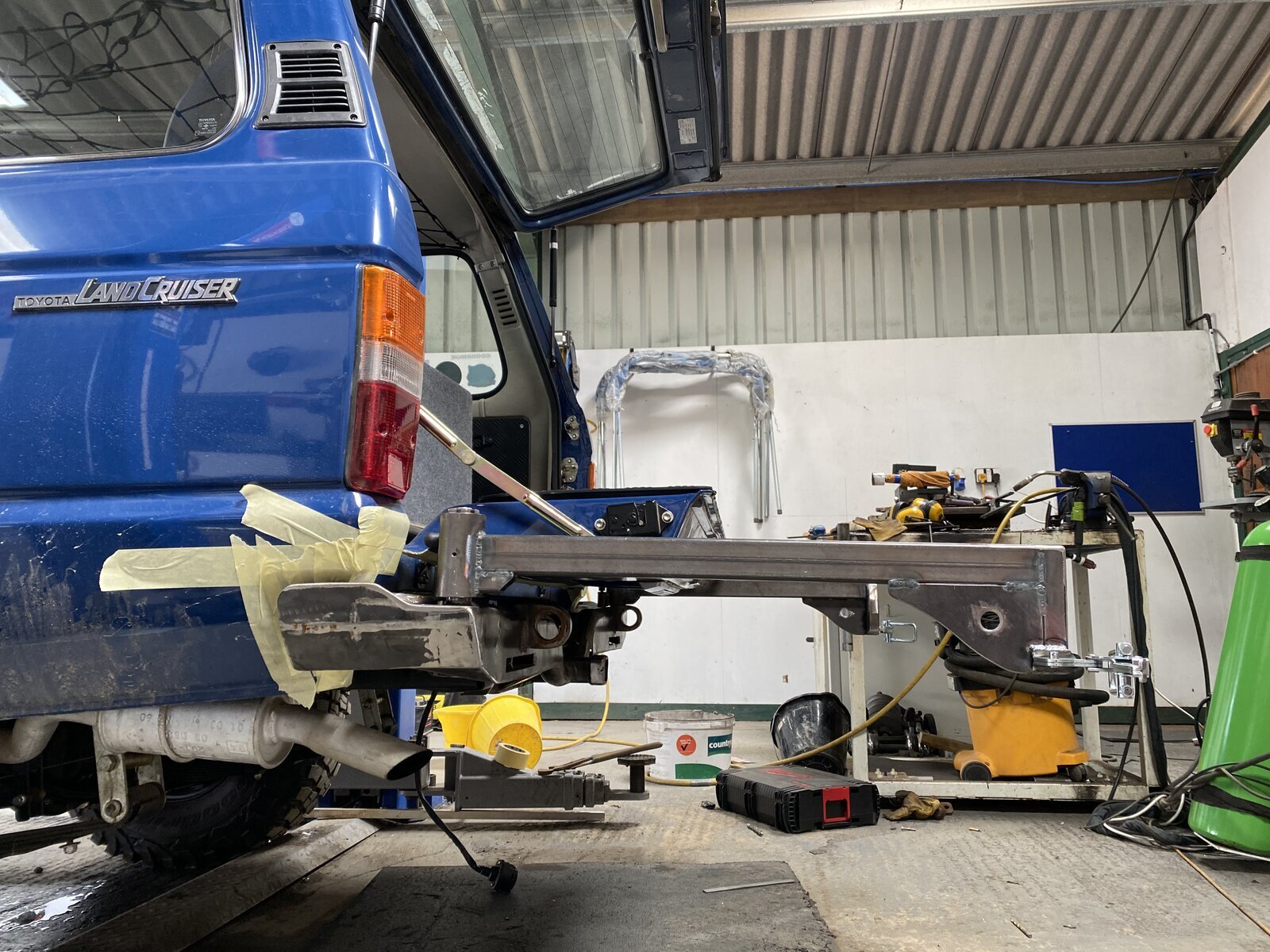

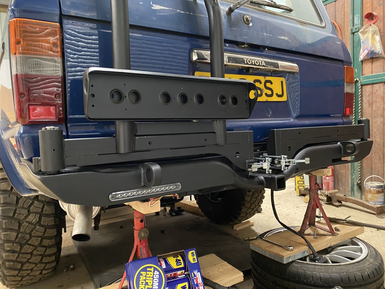

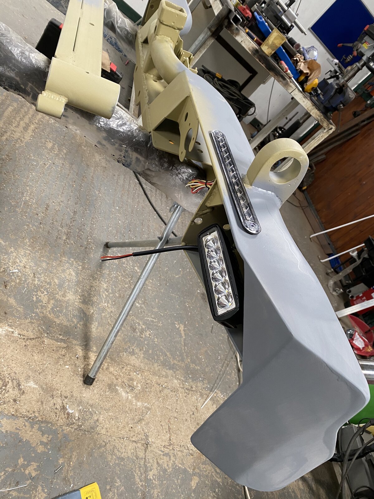

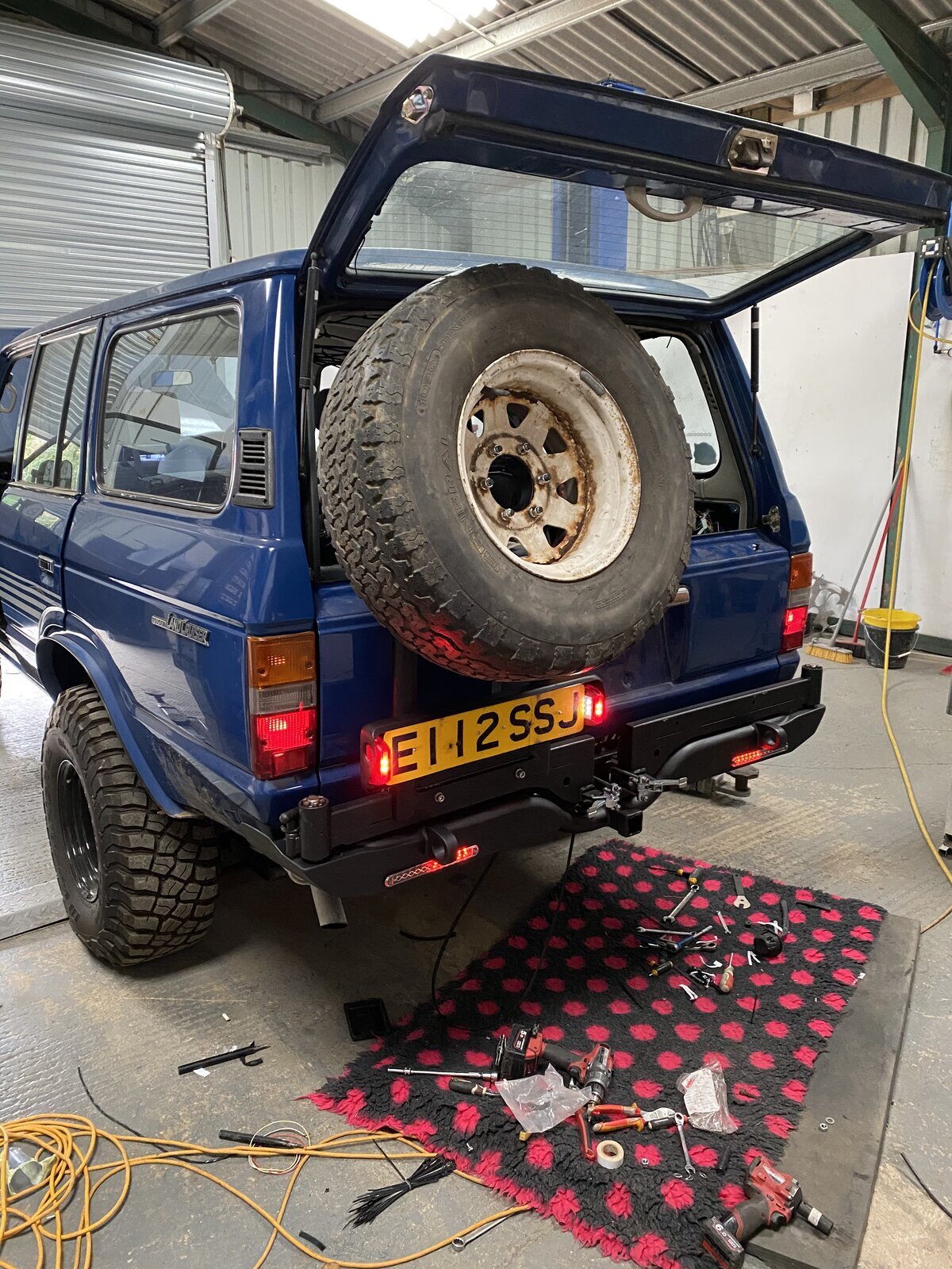

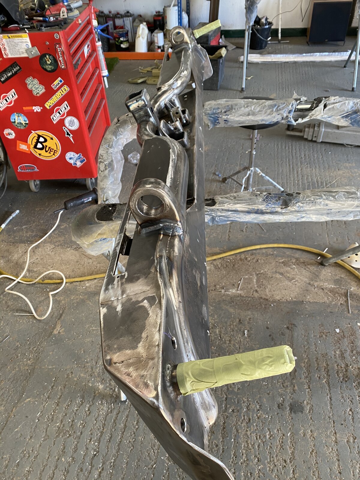

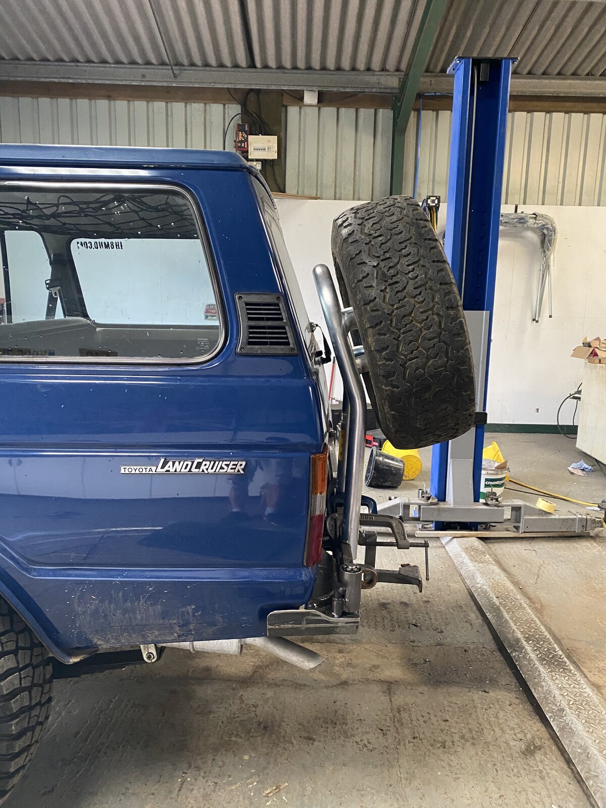

I don’t think I had put this up yet, I made a double swing arm bumper for the rear.
arm spindles are from trail forged in the US if anyone is interested.
Etch primer then raptor coat
just need a front bumper now

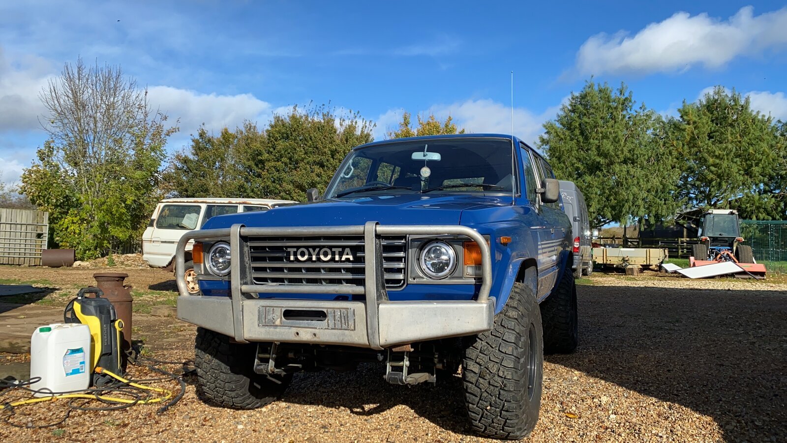

Picked up a nice looking bumper off Andy will be going black in the next couple of weeks after driving up the motorway I’m starting to think a turbo would be a nice power boost for the old 2h.
