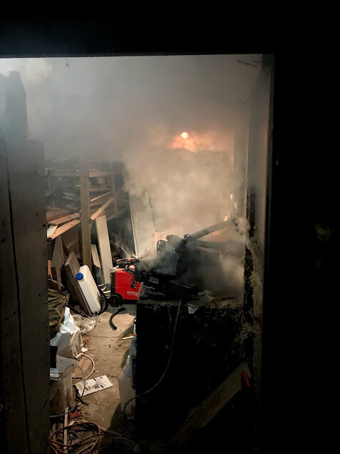

I haven't bought one of these yet but I have been playing around with a webasto FBH off a defender. The one I bought clearly needs a good service as I found out last night. IMG_9393.jpg
It's in there amongst all the smoke.
Over all it was a successful test though as the tricky part of these things is getting them to fire in the first place requiring wiring of plugs and a wbus controller.
