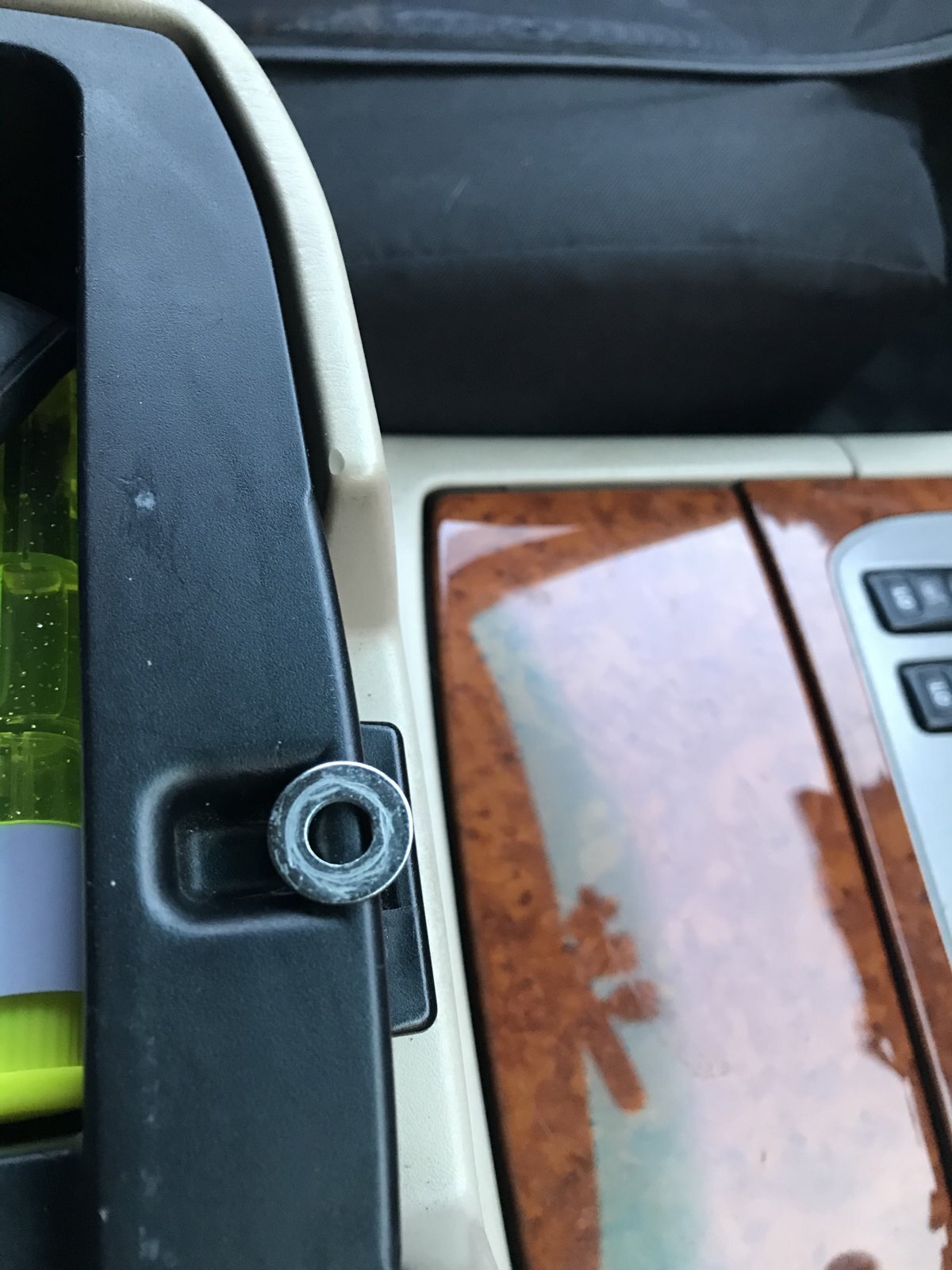

Back to the Console lid problem, I can now see why the latch is not sold separately, it's part of the lid molding so can't be got at without damaging the lid, as I said, the only thing I can think of if the latch is not coming far enough forward, is that the spring is worn, I was thinking about trying to oil it, to see if that would help, you can get small oilers with what looks like a long needle but is a small tube and the oil is very light, have a look on eBay.
The other thing would be, if you can't make the latch go further forward would be to make the receiver of the latch slightly smaller, off the top of my head, I was thinking of a small (smaller than the one in my pic) washer or similar on the top with a small short screw, or maybe use one of the previous posters suggestions, but what ever you do it would be a bodge job, and if it were me it would bug the hell out of me.
That looks a pretty good solution. Like yourself it would bug me but it is still better than the lid flying up all the time. Many thanks.
And better for your bank balance, I can't believe how expensive those lids are, keep your eye open for a used one on eBay.
