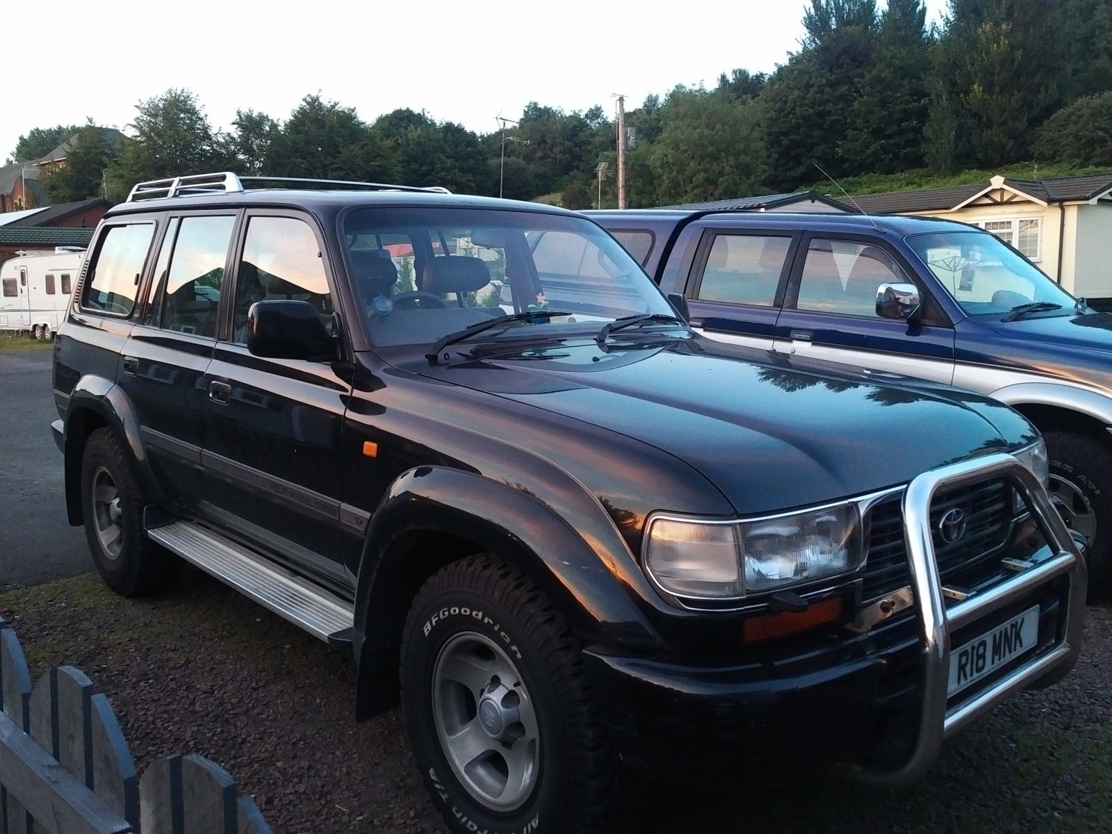

Now that is one seriously nice lookin' 80 there BL. I bet your bro is sick he sold it to you.
Don't let @Shayne see it, he'll most likely go into a decline as that's his favourite colour and he's been thinking about an 80 or two for a while now.
I think you're right, the more Cruisers that stay down here on Earth the more Landys can be towed when they break down or bits fall off. Bless 'em!
Thanks. Thot it would go onto the wee thumbnail bit. Didn't mean for it to be a full pick. And yes. My brother tries every week to get it back.
