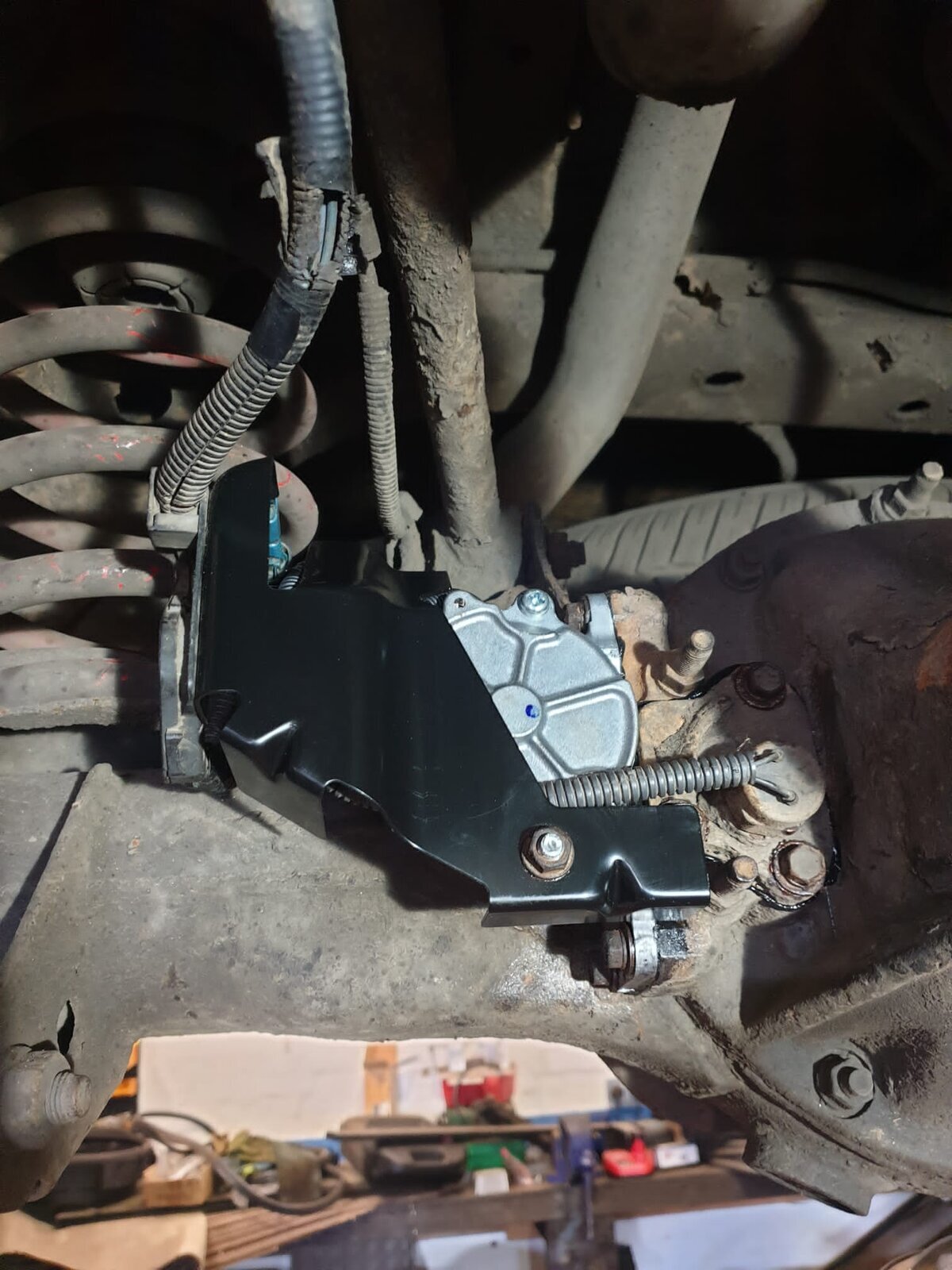

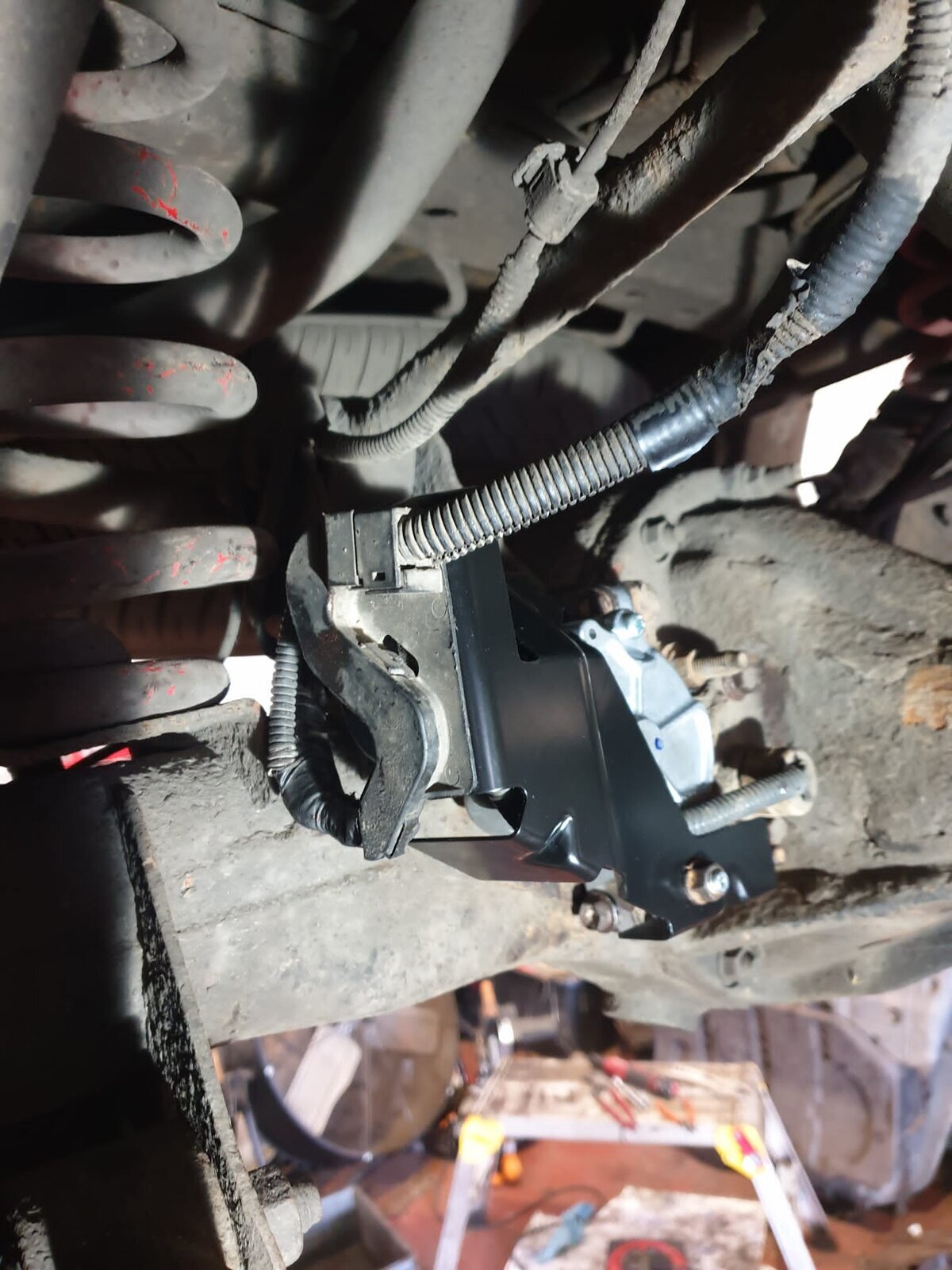

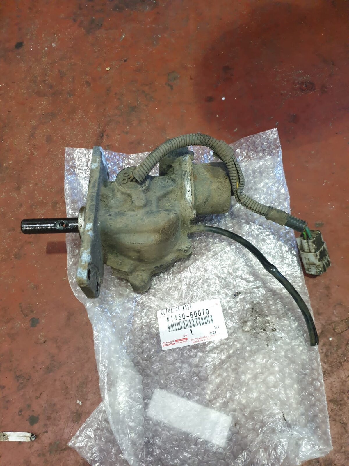

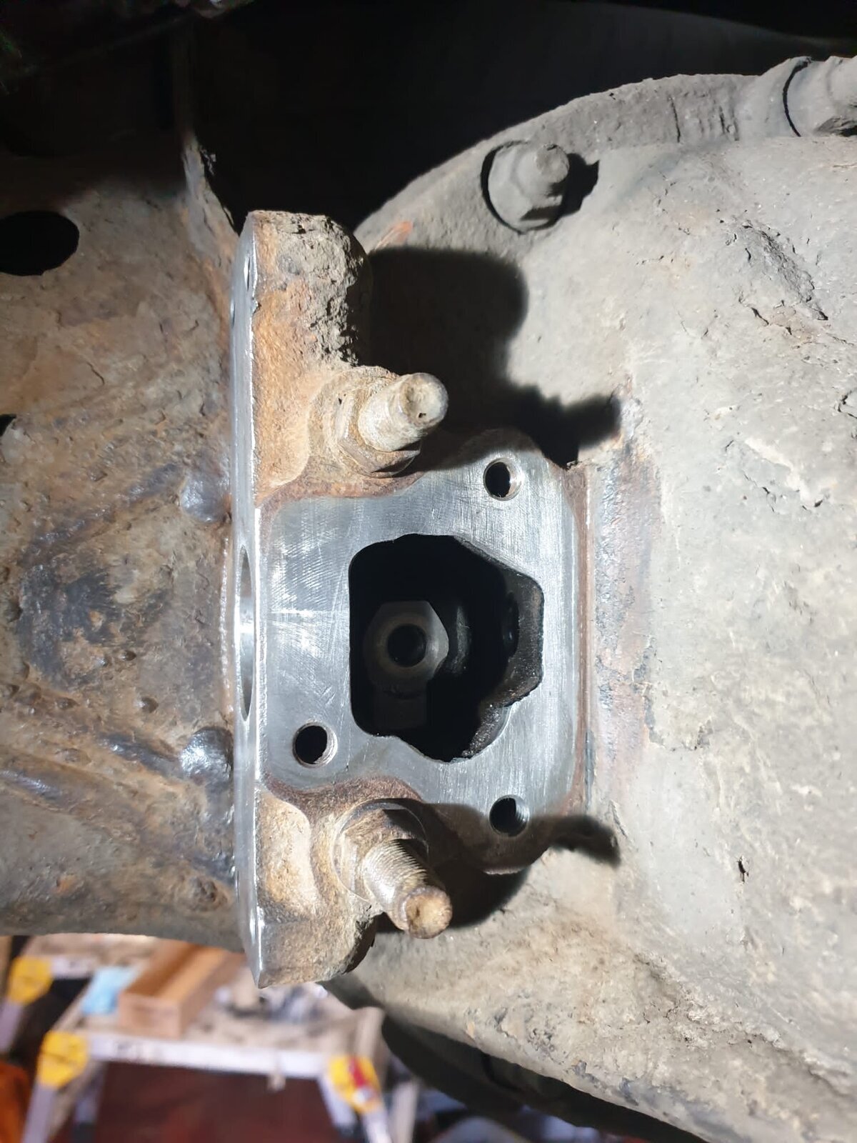

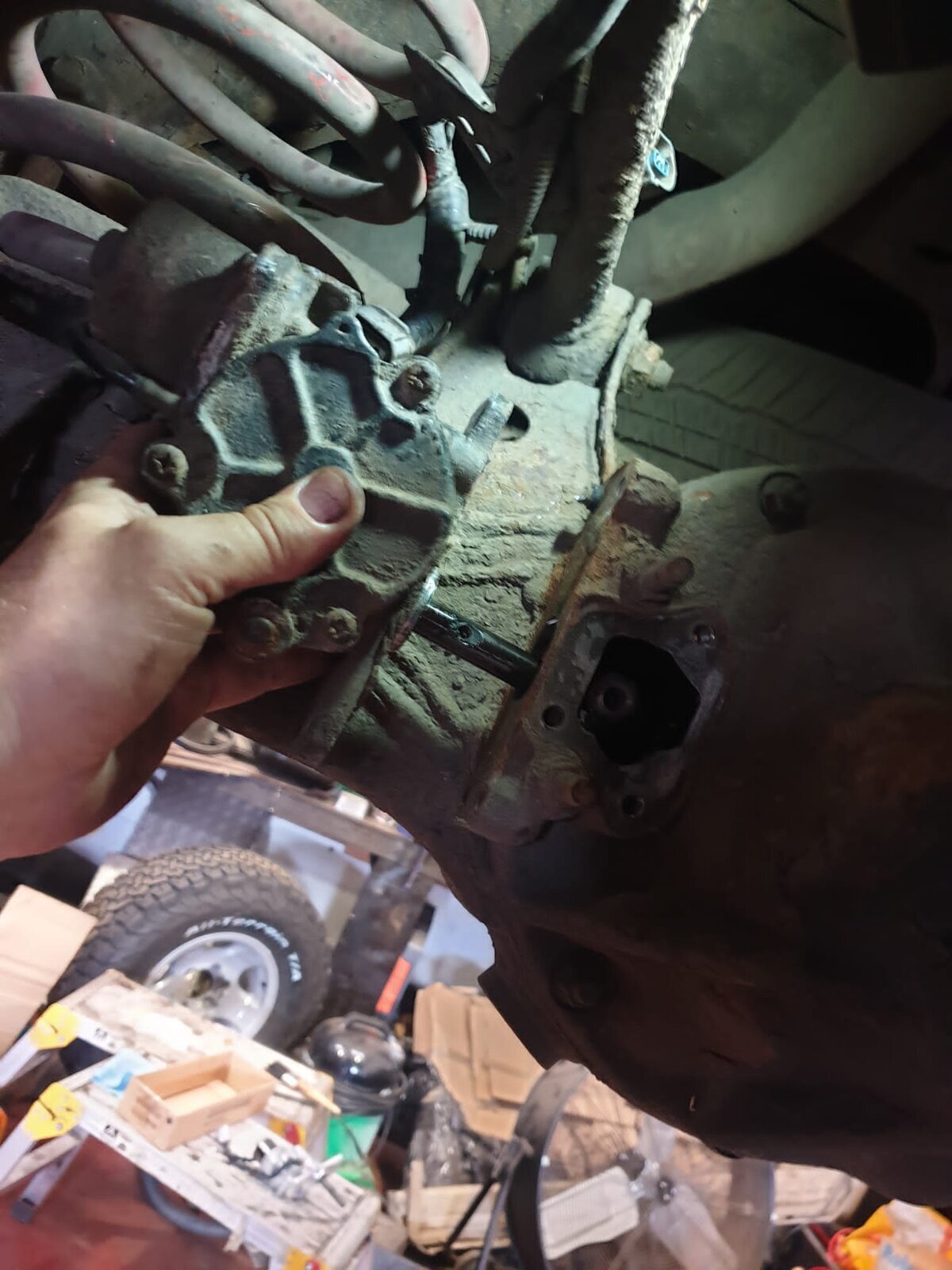

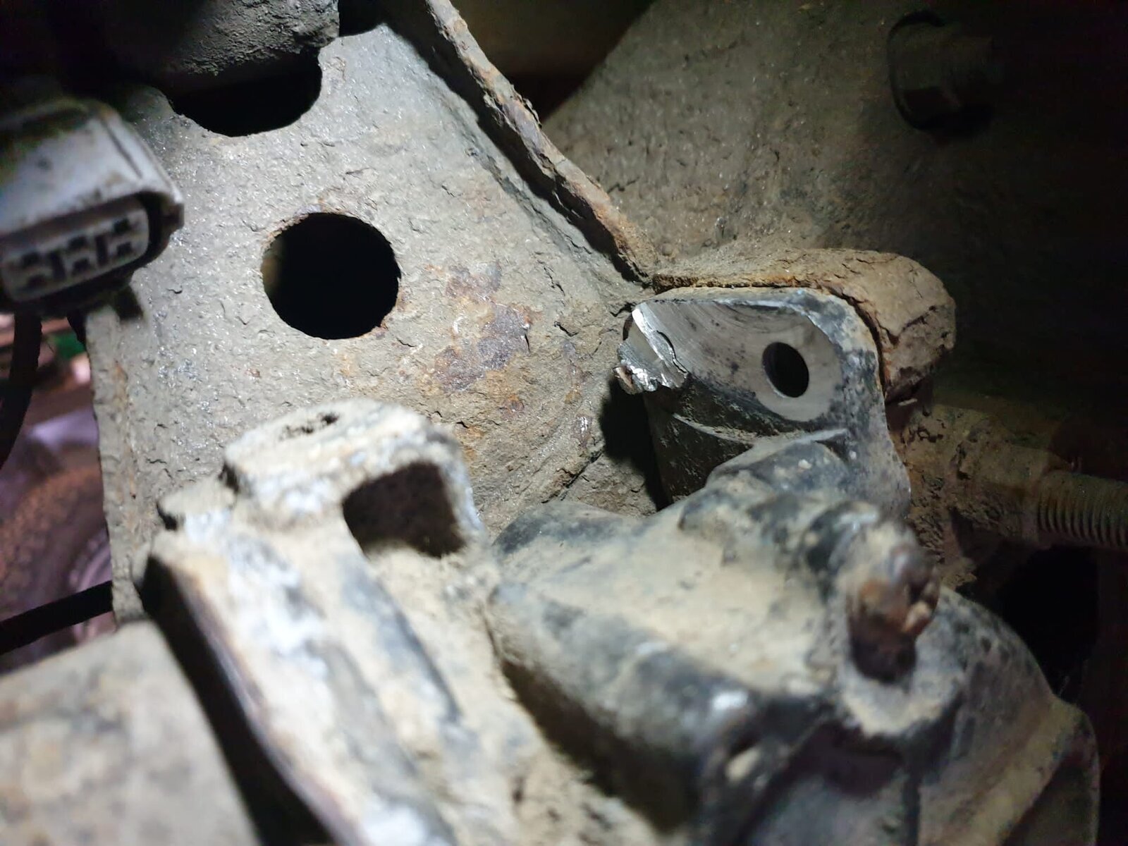

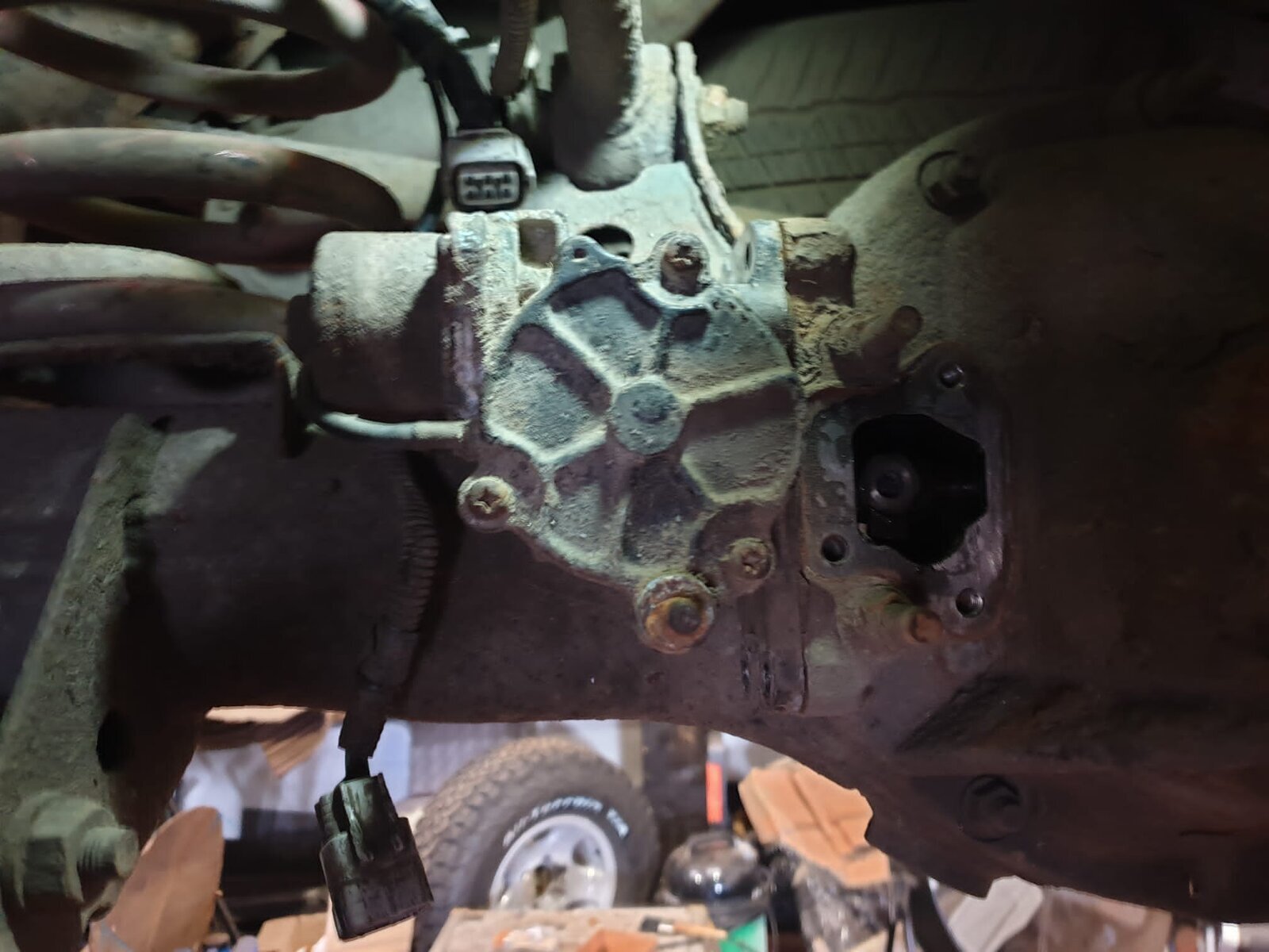

Glad it's sorted, Trevor and Ian have just done mine, hope the following pictures help! Also an added problem with mine was the low range detection switch was *#*#ed, when you select low range the center diff lock would not automatically engage and no amber light although would via the dash switch, so rear diff lock doesn't know it's in low range so would not engage anyway. There are three switches on the transfer case, I believe are all the same, center diff switch, neutral detection switch and low range detection switch. Three bolts that hold the actuator in place came out relatively easy, the fourth and most awkward needed the head cutting off, surprisingly the bolts are not stuck fast to the threads and it came out with ease. Pictures four and five clearly show the dog gear that attaches the actuator to the the diff. New Toyota guard also fitted. About two hours in total.
