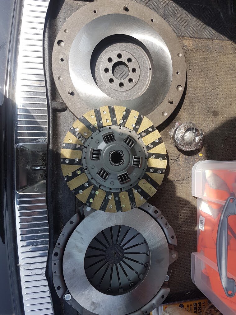

Kevlar Clutch, new springs, upgraded bearing and flywheel grind:

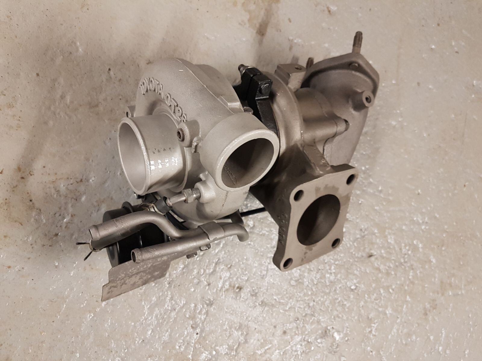

My turbo is being re-conditioned and made into a 22psi hybrid affair - the guy doing it said we caught it just in time as the bearings were just about to break through.

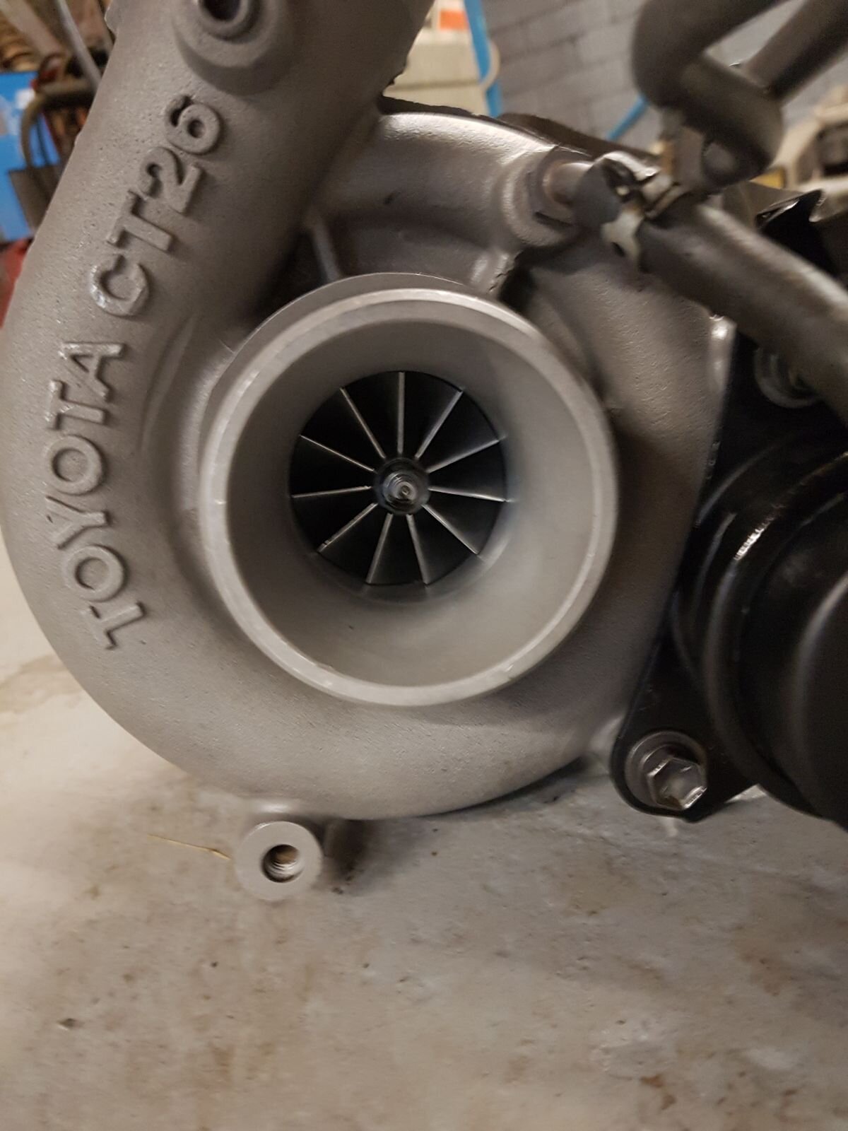

More shiny bits arriving - Turbo fully re-conditioned and improved - bespoke billet turbo wheel, machine housing - approx 60% increase on stock flow and 29psi safe

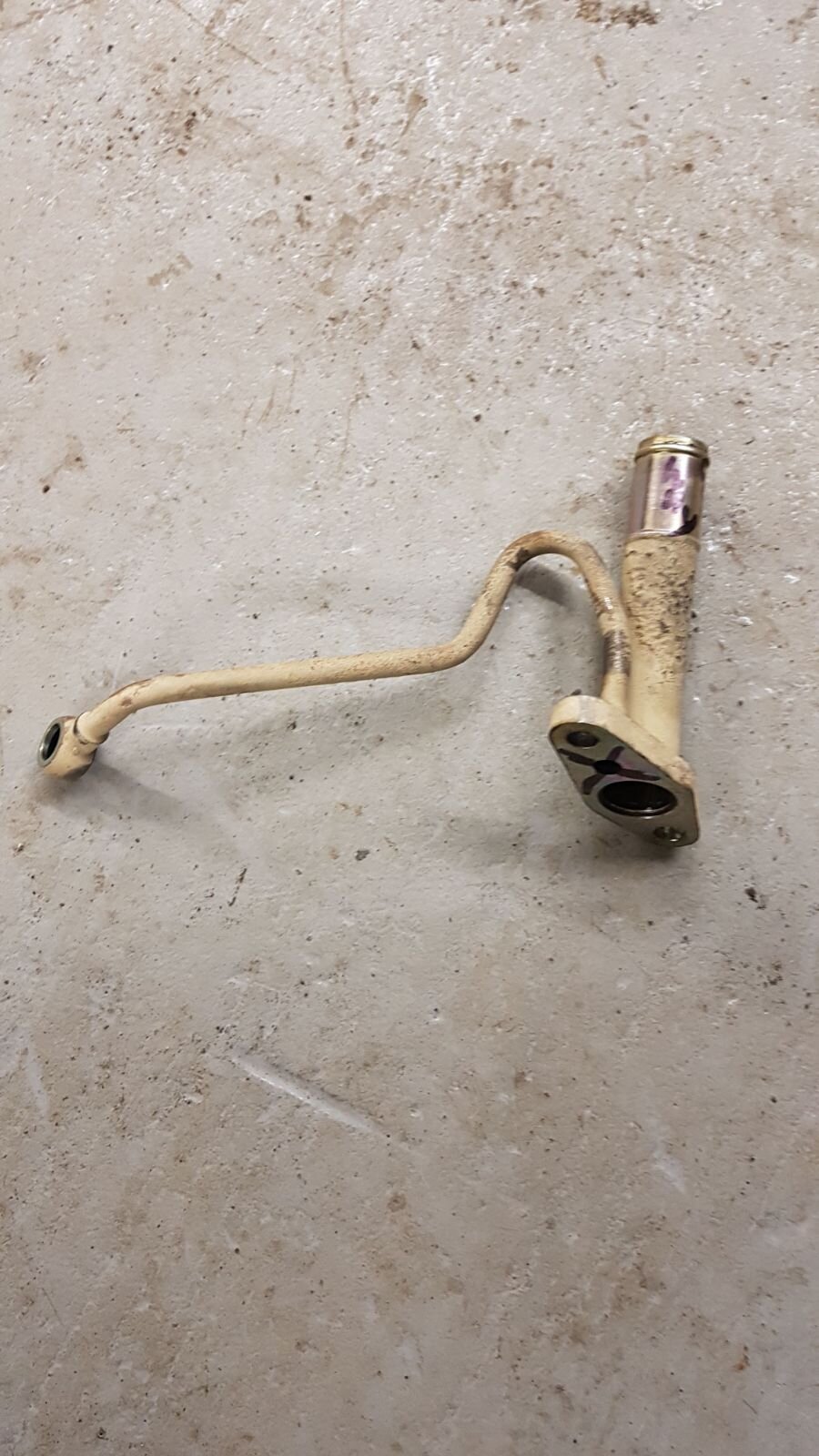

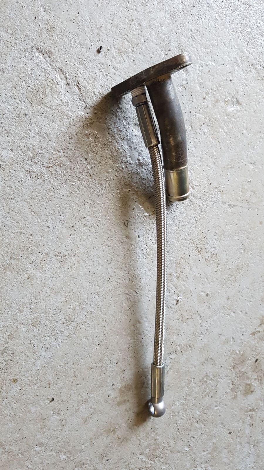

Although the oil pipes were full of carbon / crud - so pipe modified - I will do a full write up and who did what / recommended suppliers when its all done:

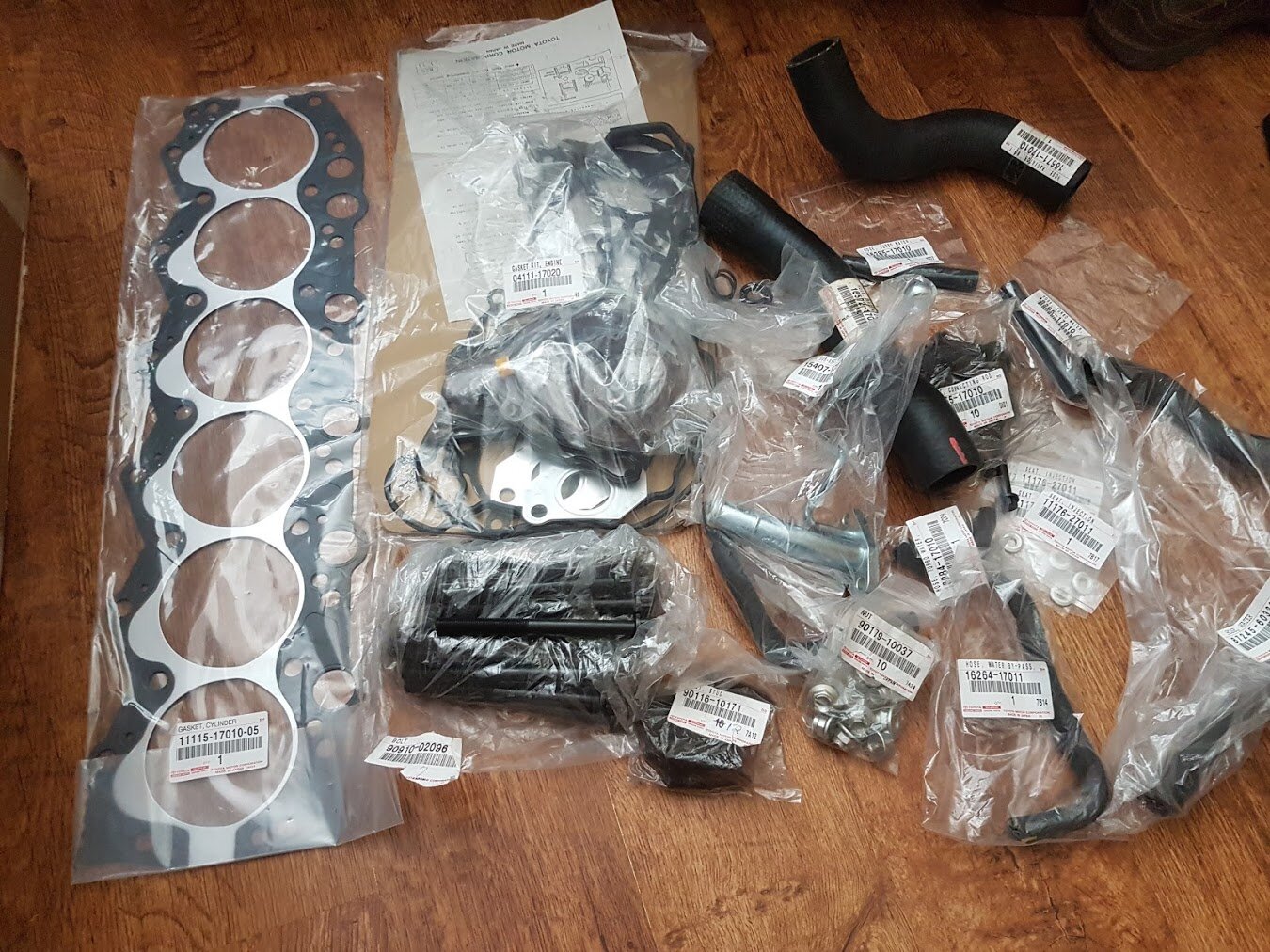

Some more shiny new parts, Bolts, Seals, Gaskets and Hoses: All genuine Toyota - thanks to Julian at Overland Cruisers for sorting these.
Just the fuel pump to arrive and the rebuild can begin!

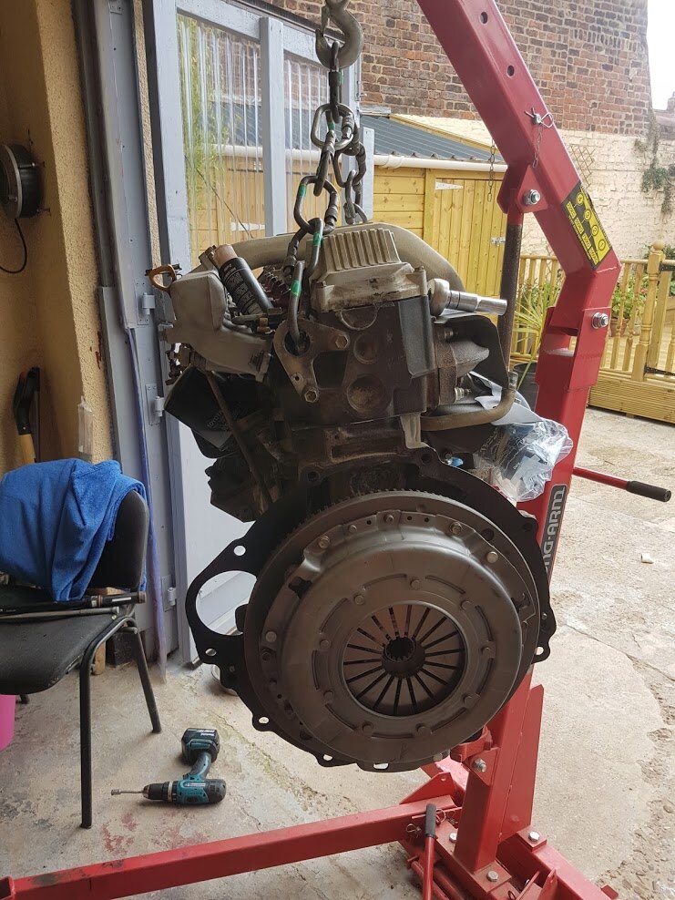

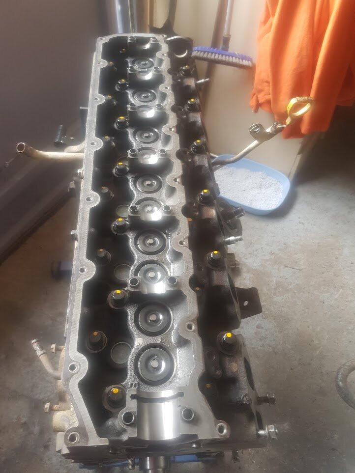

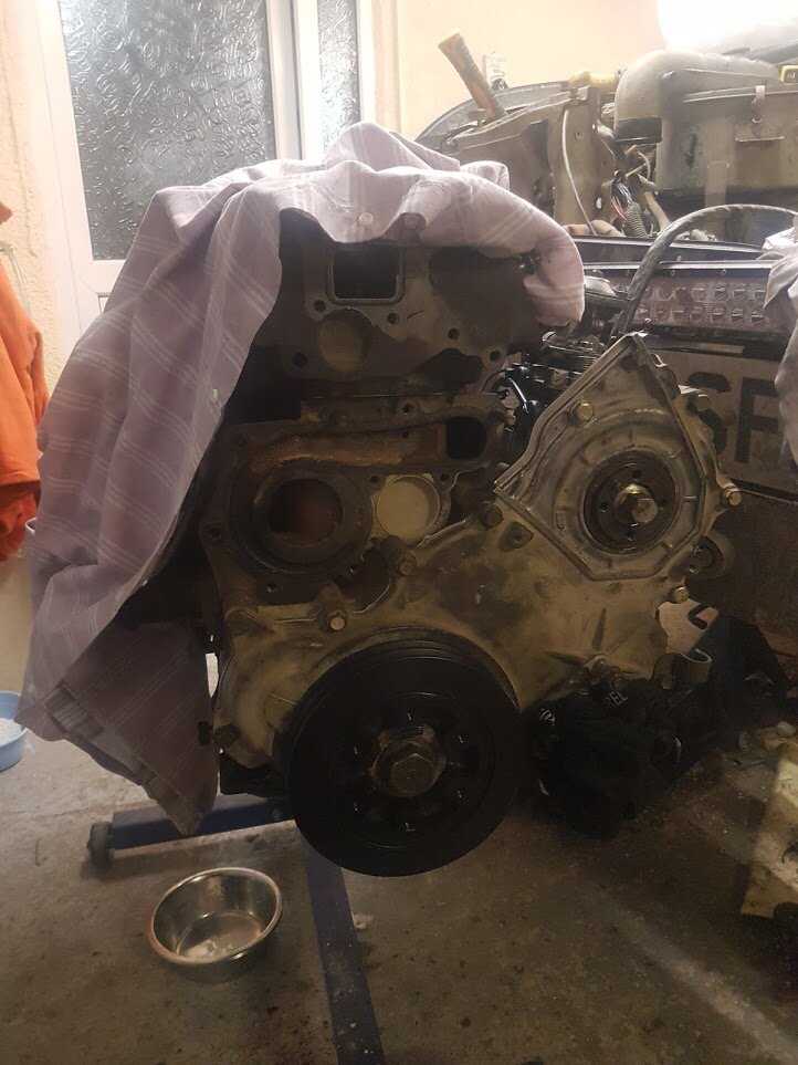

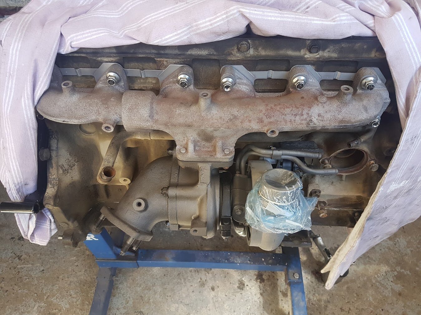

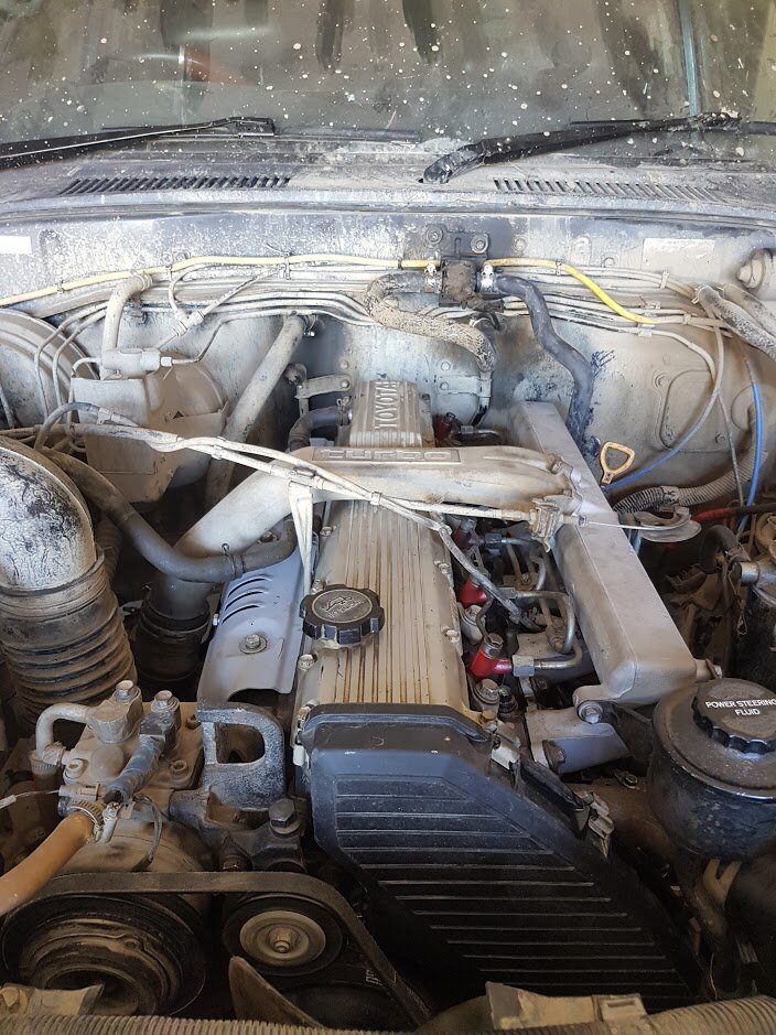

Had a good weekend rebuilding the lump (considering the fuel pump failed to deliver - another story of courier issues) - bottom end, head and turbo on.
A friend comes around, looks in the engine bay and stops play!....................

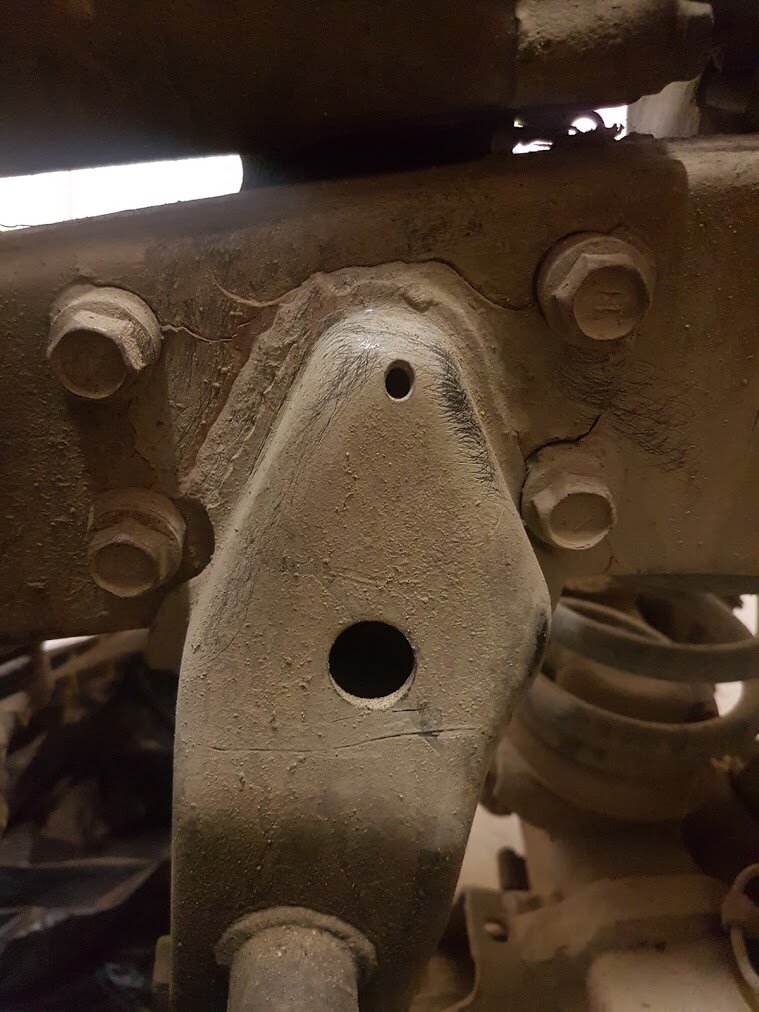

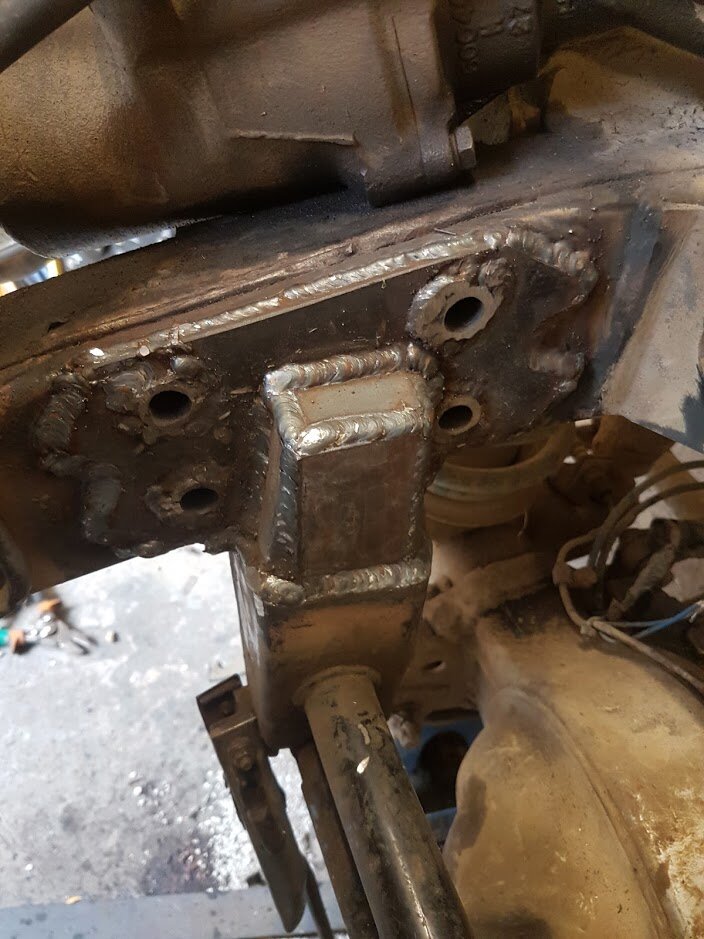

Pan-hard Rod inner mounting (steering box mount side inner) - I plated the outer about 3 years ago.
So, Im going to get the engine sealed up, the get busy on this, its going to a be much easier to do with the engine out still.

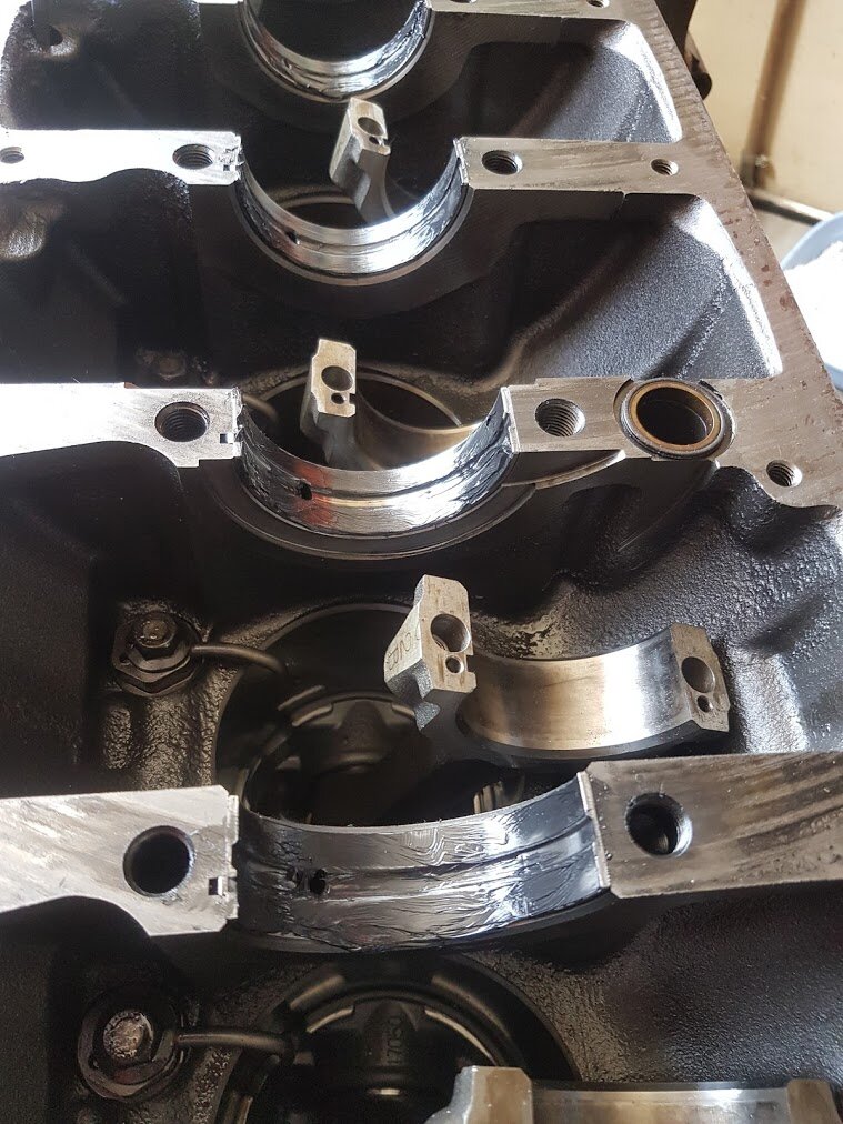

Well the pump finally arrived yesterday - allowing the rebuild to get started........
Graphogen applied to bearing surfaces
Spot the deliberate error?

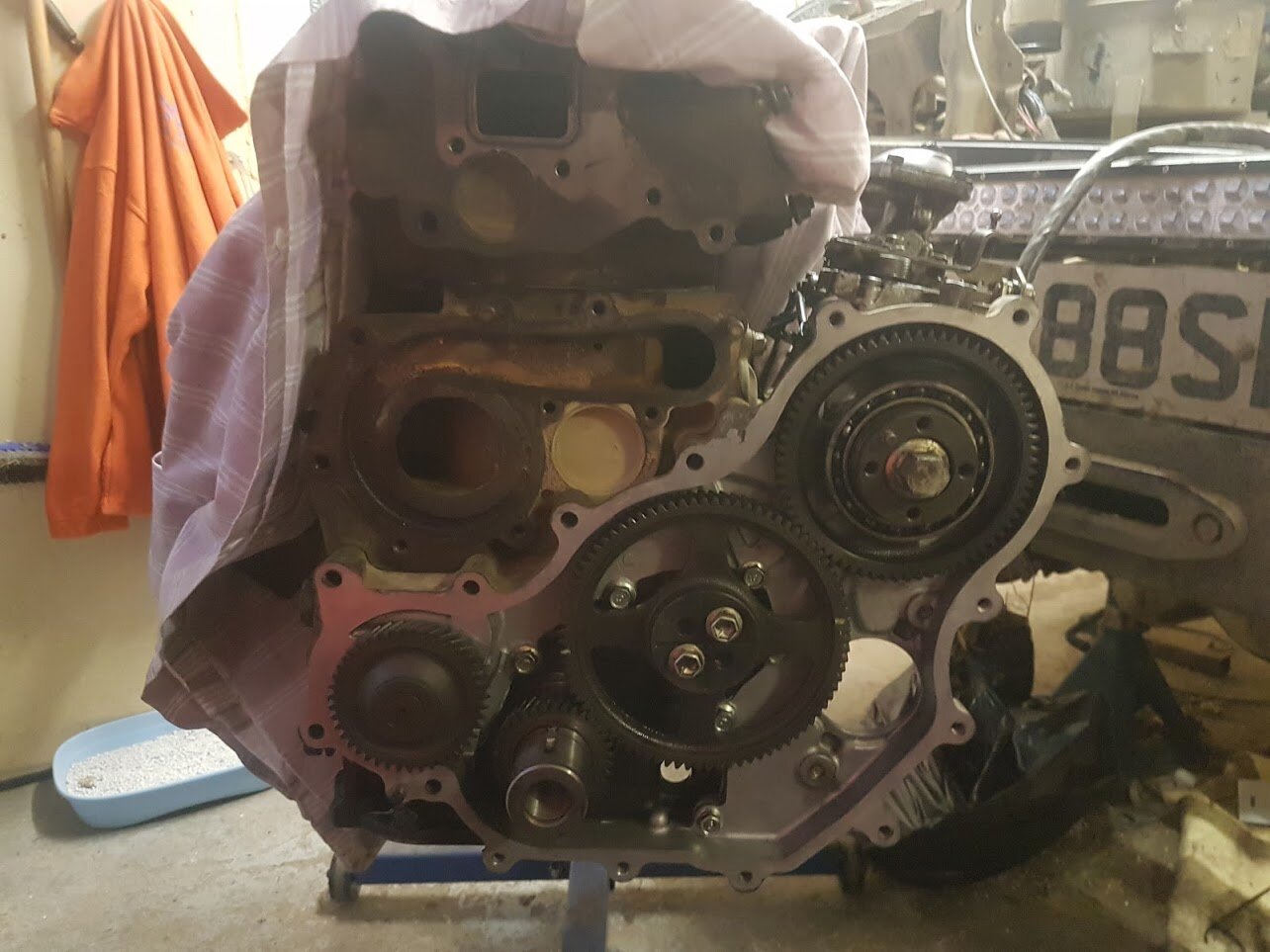

3.jpg Pump and Timing Gears on - love the simplicity of setting the gears

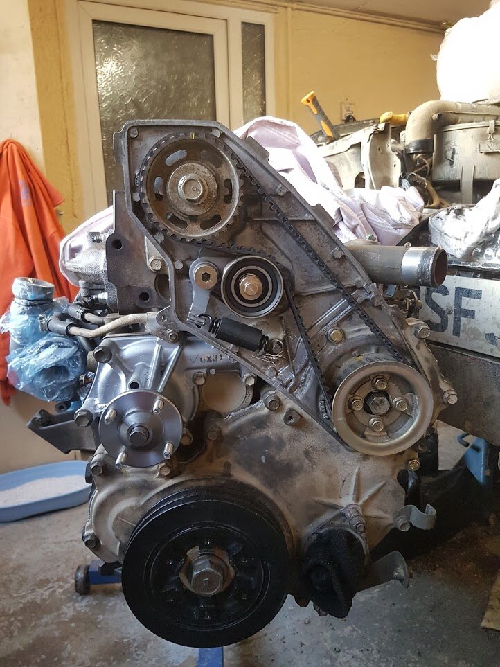

A bit more done last night, water pump fitted, cam belt on, timing checked, turbo fitted, top cover on.
The only thing that "bothered" me - I bought a new water pump and went for the AISIN one as its OEM - but look at the pic - there has been some grinding off and a sticker applied - it did come in a full AISIN box - I wounder if AISIN are out sourcing now - it also had a plastic / composite impeller not a steel one.
Apparently aisin do the grinding off due to there comitments to toyota... its on rufftraxs website.
Cheers Mike, I missed that, comforting!
I do rate Roughtrax as one of the better "bulk" suppliers, I think they do some decent research into the quality of their products.

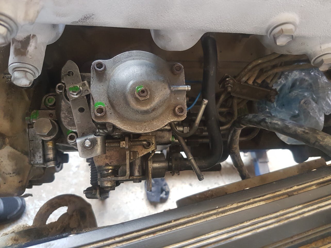

Looking more like an engine now - inlet, injectors and feed pipes are on - note to others - make sure the tape you use for numbering the pipes stays on - I had 15mins of layout practice!

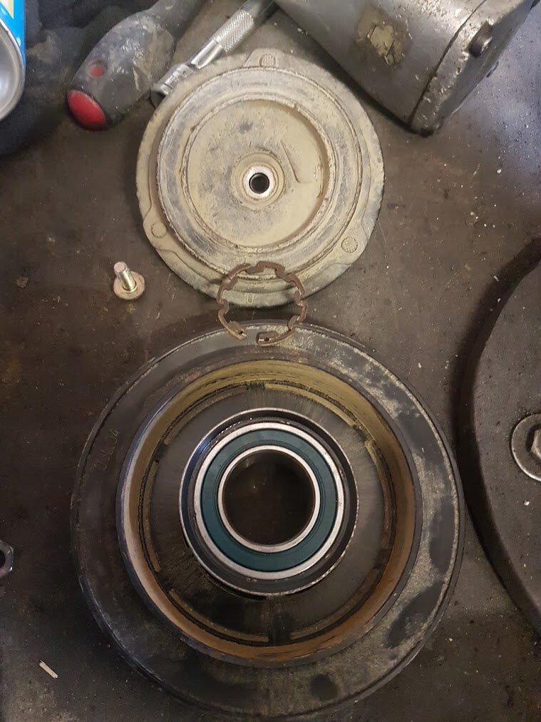

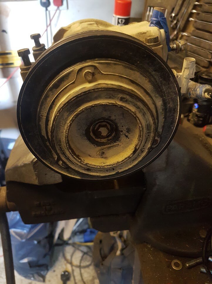

Another job ticked off the list last night - replaced the air compressor bearing as mine was getting a bit noisy.
I figured that although the bearing is a little pricey at £45, I would happily pay twice that if stuck in the middle of nowwhere without my on-board air (I use the aircon pump for onboard air but the priciple for bearing change stays the same either way).
Bearing Link Here

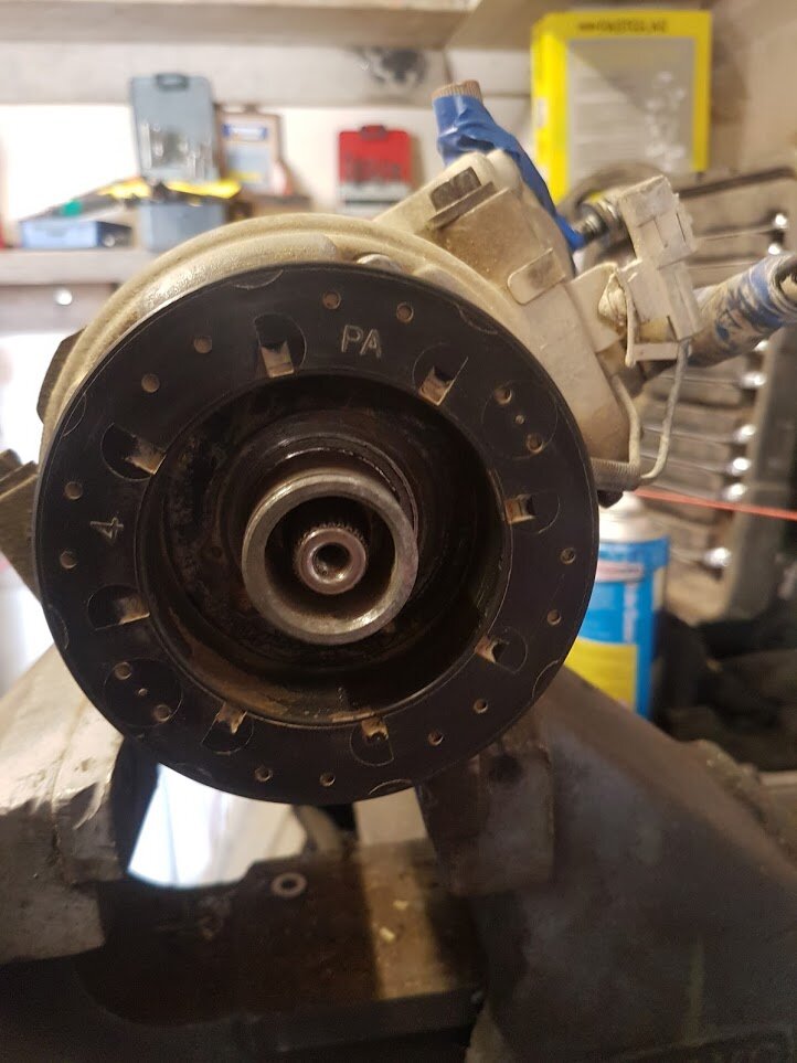

Its a very easy job, just need a 10mm socket, circlip pliers and possibly a gear puller (mine tapped off), A few pics:
Front clutch comes off with a 10mm socket (you need to put some small resistance to stop the clutch turning)
Pulley shown with the new bearing fitted
Clean up the electromagnetic coil with some scotch brite

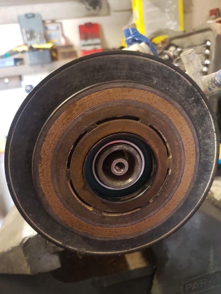

Gentle clean up of the clutch mating faces - clutch to pulley
Re-Assemble (dont forget the little spacer that sits in the clutch mounting bore)
Runs as smooth as a greased pig on a marble floor now.

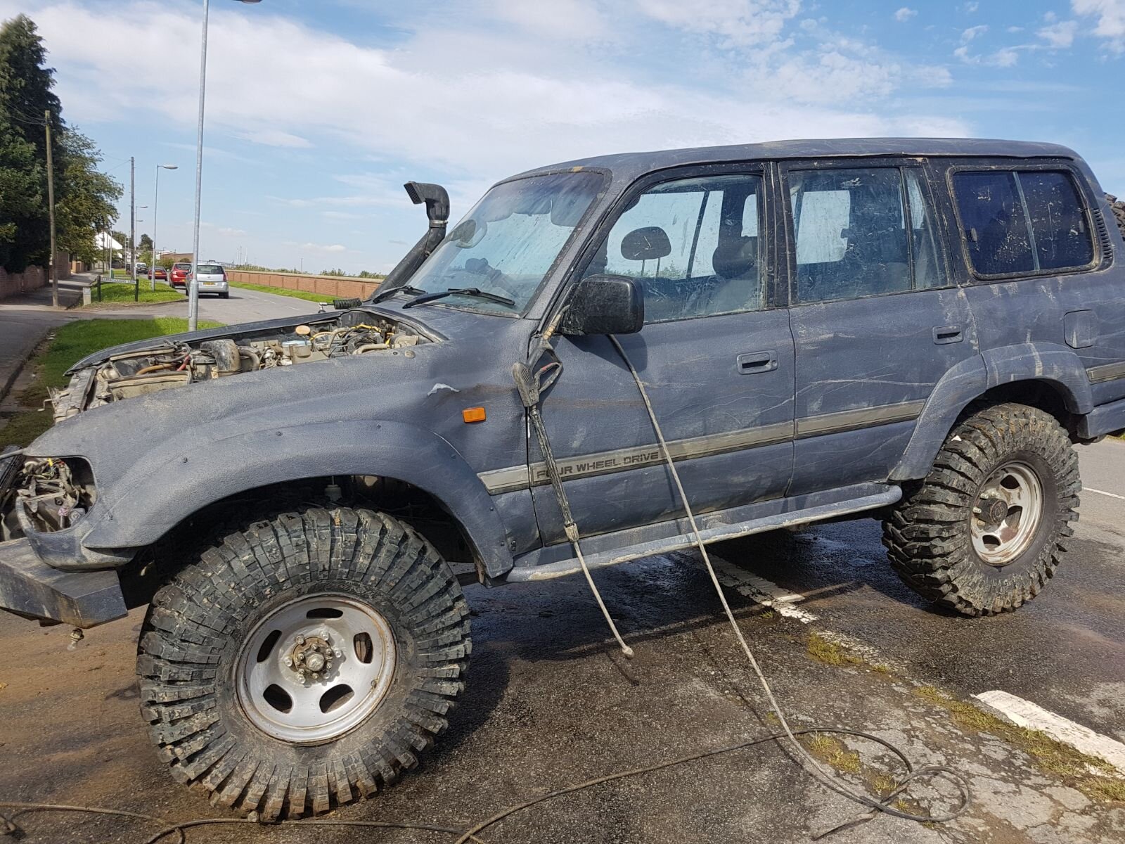

Its seen daylight - the first time in 9 months!
Gave me chance to clean off the mud (it came back on a trailer with about 200Kg of mud on it!)
Not all good news though, struck up from cold perfectly fine, but a misfire came in - it looks like cylinders 1 & 2 (no difference when I crack off the pipe) - these are the only parts not changed or upgraded - they were tested when I had the fuel pump rebuilt but I was advised to get some new ones as they are not the best (like a fool I said it could wait) - even though I bought these off a UK breaker who had said they were tested!
