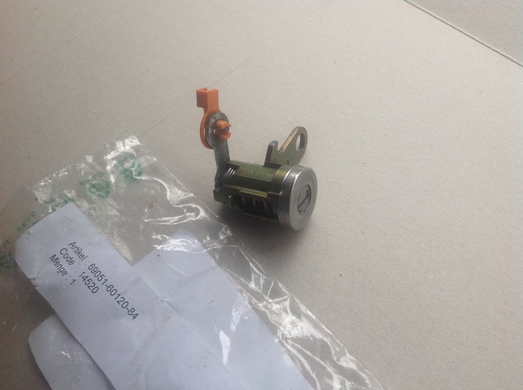

You can buy new cylinders and even get them set to your key; it was about £80 from memory for the ignition barrel. The door lock cylinder was replaced on mine by the previous owner (different key unfortunately) and there is a bill in the paperwork for £110 including fitting.
Swapping with passenger side should work too although you may have to swap the linkages.

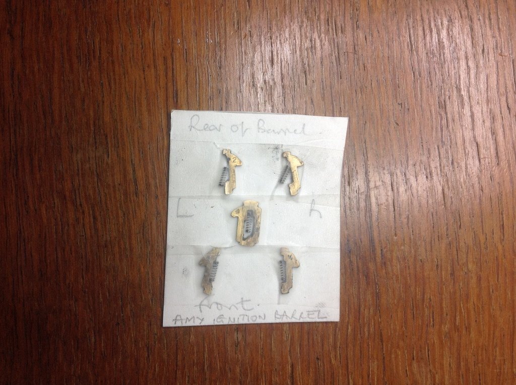

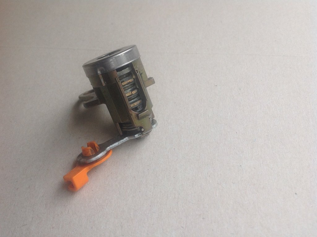

Mine was full of graphite lube, which ruined two pairs of trousers over time. There comes a point when the split wafers wear to the point that they will not allow the lock to rotate easily. I got sick of jiggling mine about for five minutes so just removed them. The final straw was when the MOt tester couldn't get the thing started and it nearly lost me the test.
These were the wafers I removed. I think taking the middle (full wafer) out is what allows the key to come out in any position, but it was sticking and had to go. If you take any out make sure you get the little springs out too.
