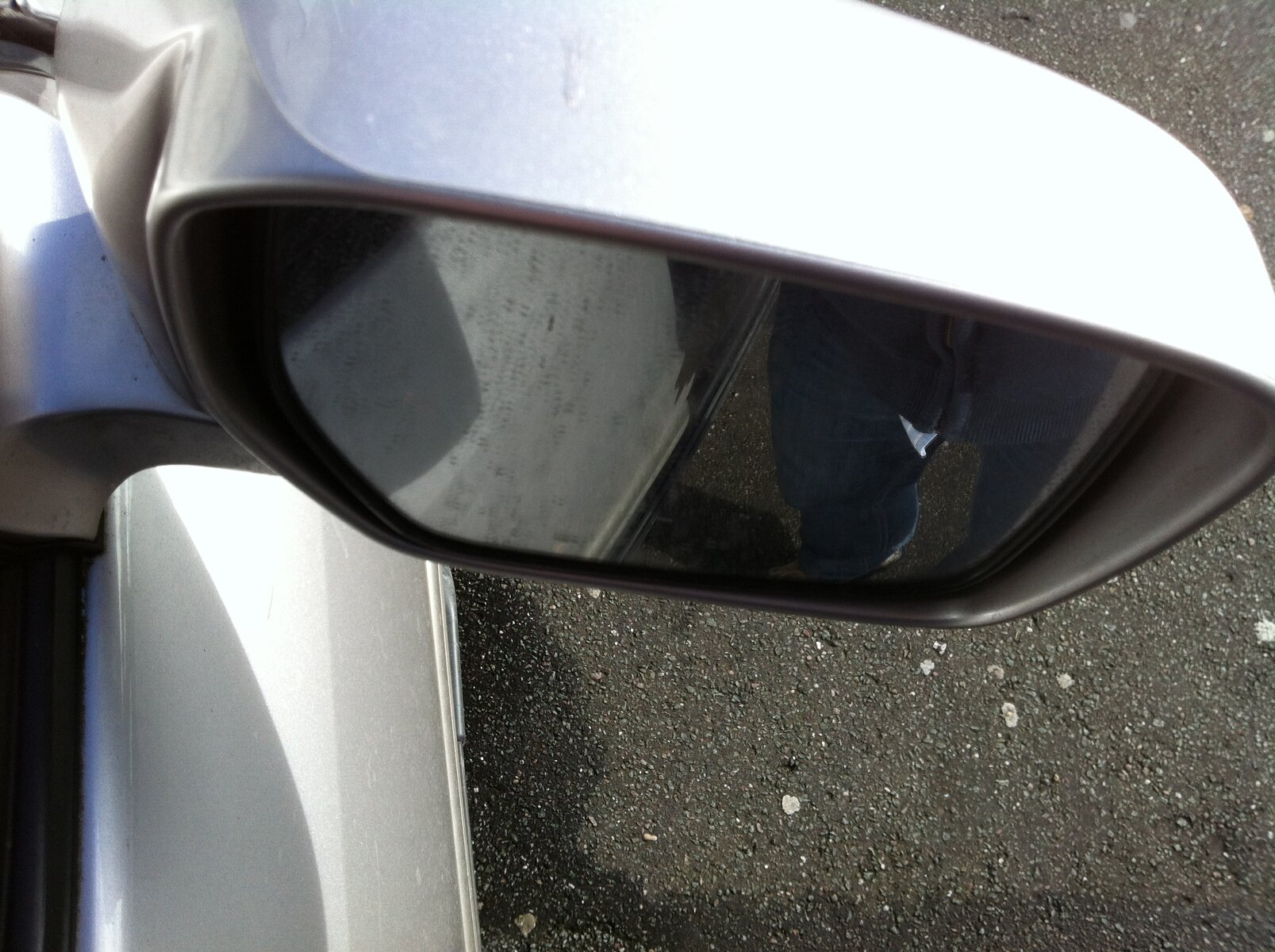

Brian, LHL & LHR does not look like good news to me.
I drive a LHD and the LH driver mirror is plain glass whereas the RH passenger mirror is convex.
The first picture you posted looks the same as my mirrors, but it's not that clear.
That aside, I can position my mirrors well beyond the ideal position in both extremes so that doesn't explain your problem fully.

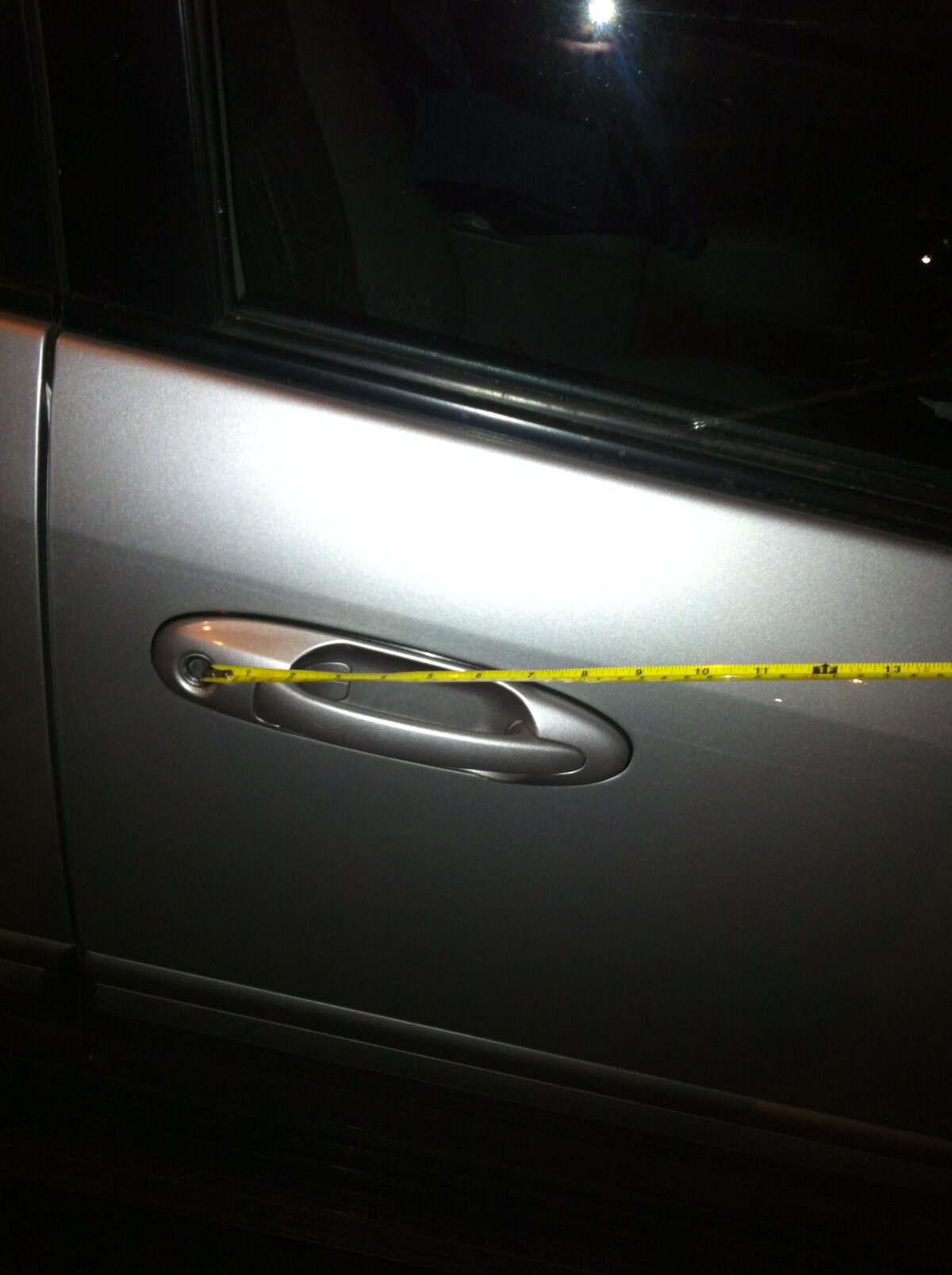

From key hole in drivers door to edge of mirror 28.5" passenger side is 30"
hope that helps.
Try sitting in passenger side & see if the range of vision is OK from there to see if it's from a LHD vehicle?
cheers

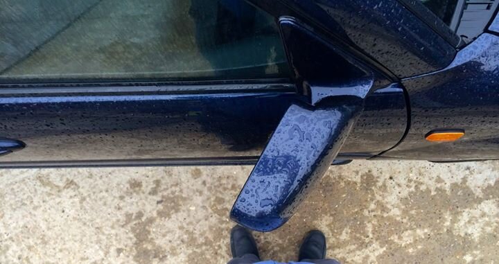

Top down view
my feet look tiny!!!
Good call Chris. I like it. Bit of the old lateral finking.

Drivers Door Mirror measurements ... 28.5 Inches Passenger Door mirror from lock .. 28.5 inches
Chris are you sure your drivers door isn't 30.5 ? with your passenger side 28.5 ?
Looking at Chris`s Angle compared to mine, this confirms, the angle of mine is different !
This concludes the problem !
No I just checked again, drivers door is 30"

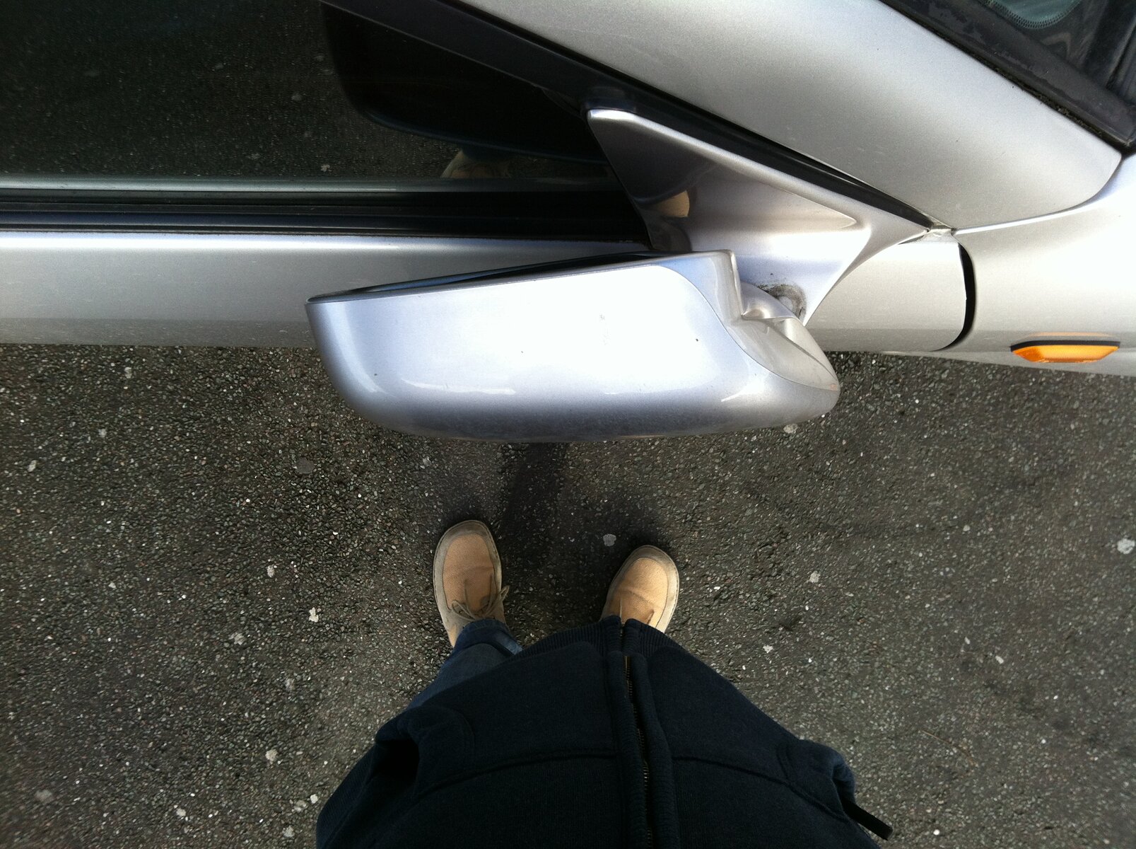

folded in it doesn't seem to fold away as much as the passenger one
glass angle when folded out:
Mine is easy to physically fold in or out - the difference might only be where the 'detent' is that holds it in place?

Hi Chris, thank you for double checking.
Mine does fold in and out easily if you push it, there is two `detents` one where it wants to be and the other where it should be but wont stay in that detent and jumps back to the wrong detent.
I think we could be onto something here,
Time to dismantle it again I think.......
