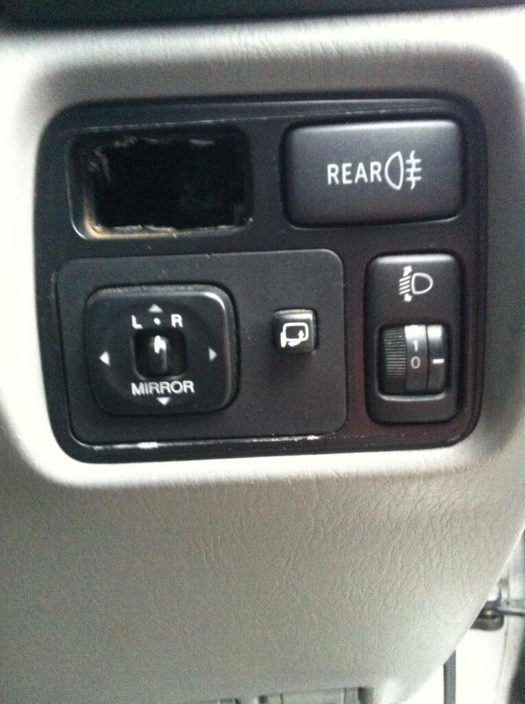

to stop the mirrors dipping when selecting reverse just set the selector switch to the central position.
Like below:

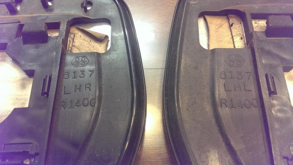

Took a picture of my mirrors - I guess it indicate differences between RHD and LHD
the mirrors from my left hand car reads #Left hand right and left hand left"
