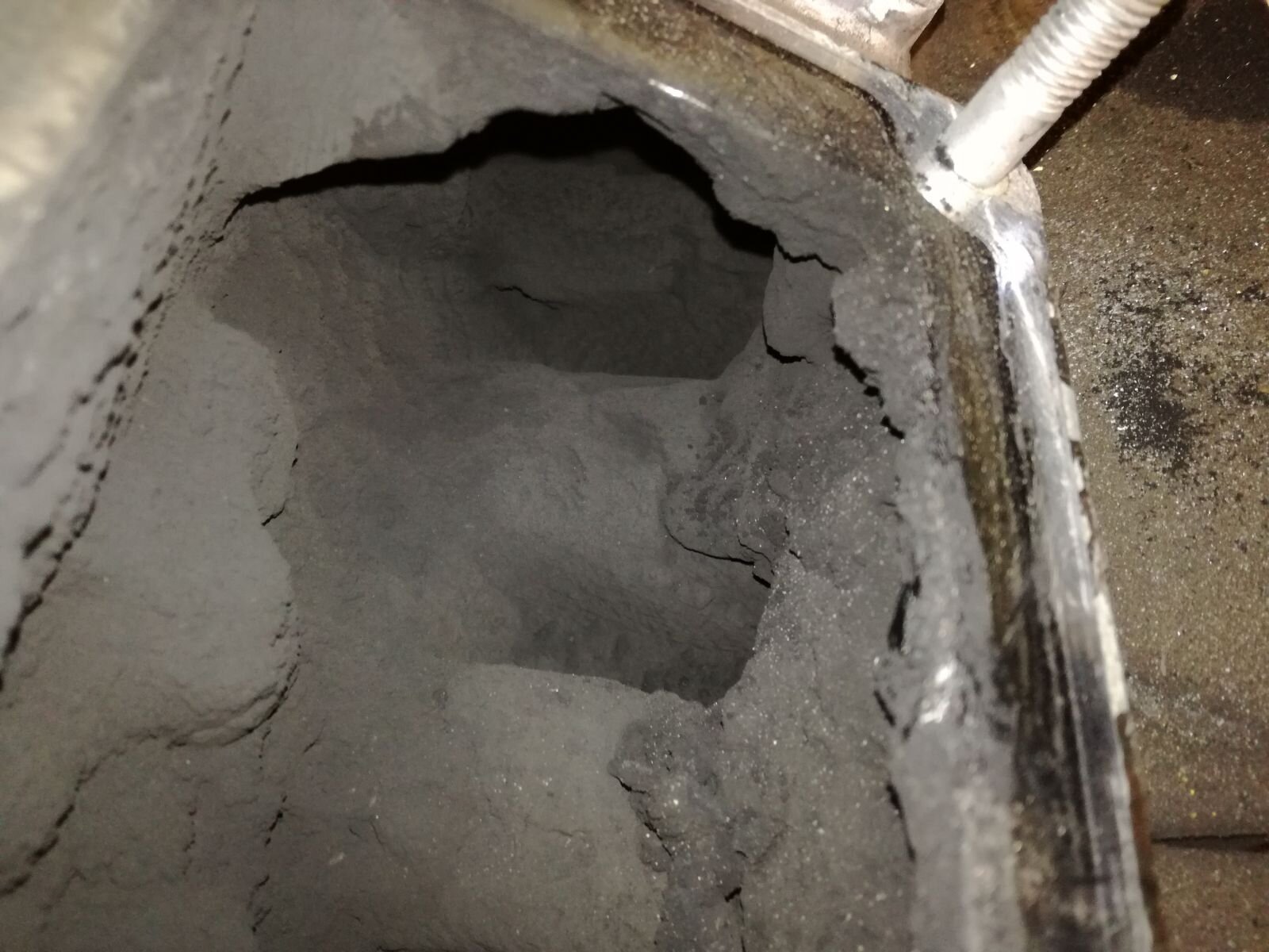

Whats the best way of getting rid of that? Some kind of chemical treatment?
I soaked my air crossover pipe in a mix of petrol/diesel which worked very well and carefully scraped what I could from the inlet manifold. Ideally I guess you should also remove and fully clean it like the air pipe and then remove the cyl head and do a full decoke!! All depends on how far you want to go with it.
