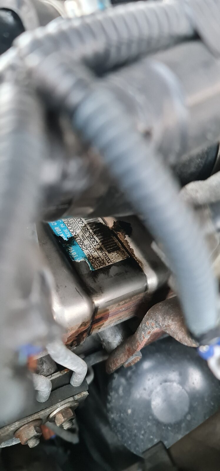

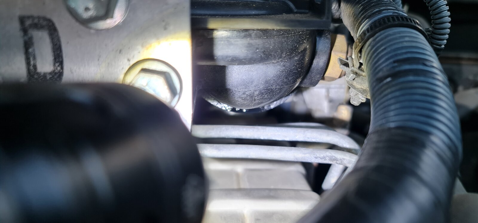

I believe it's blocked, rough idling, rough on low revs driving, smooth higher revs, found oil leaking from the pipe from the intercooler to the EGR

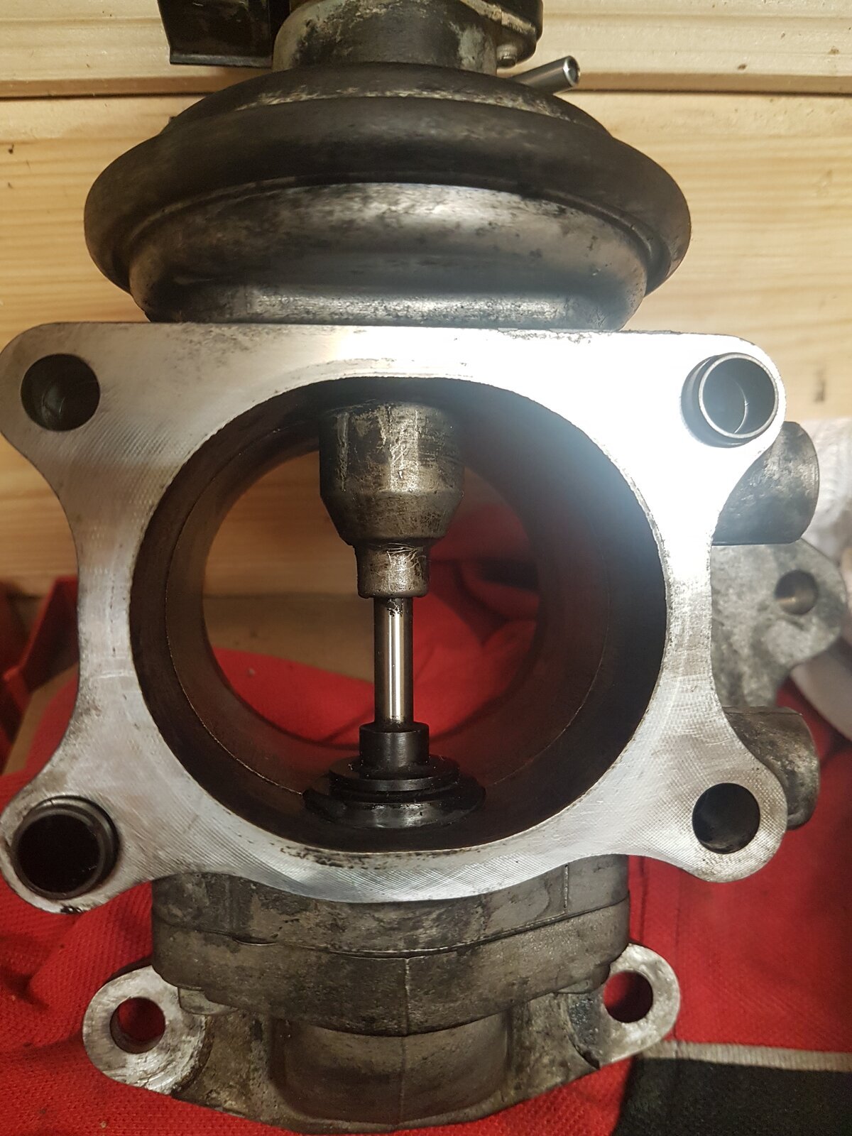

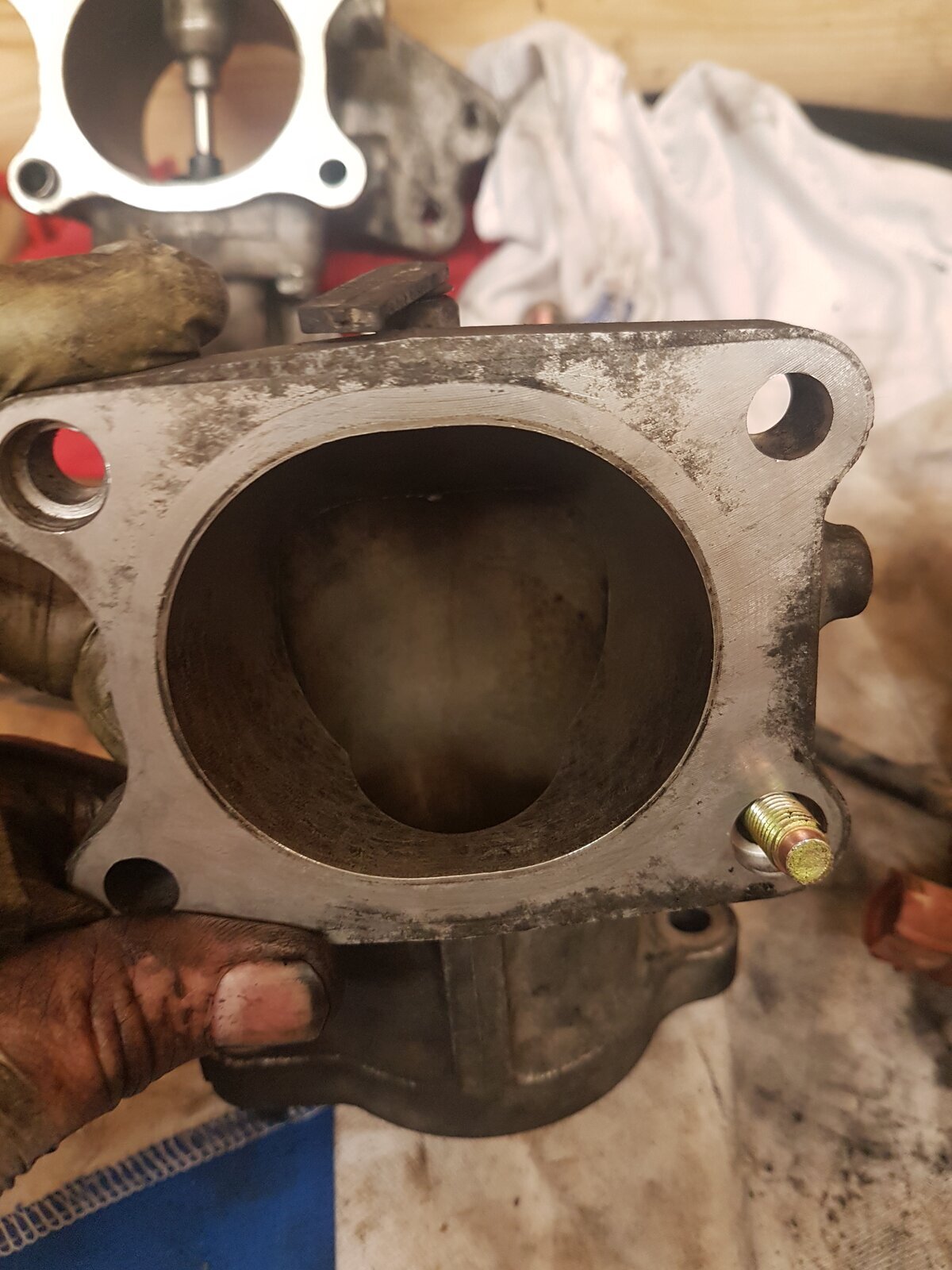

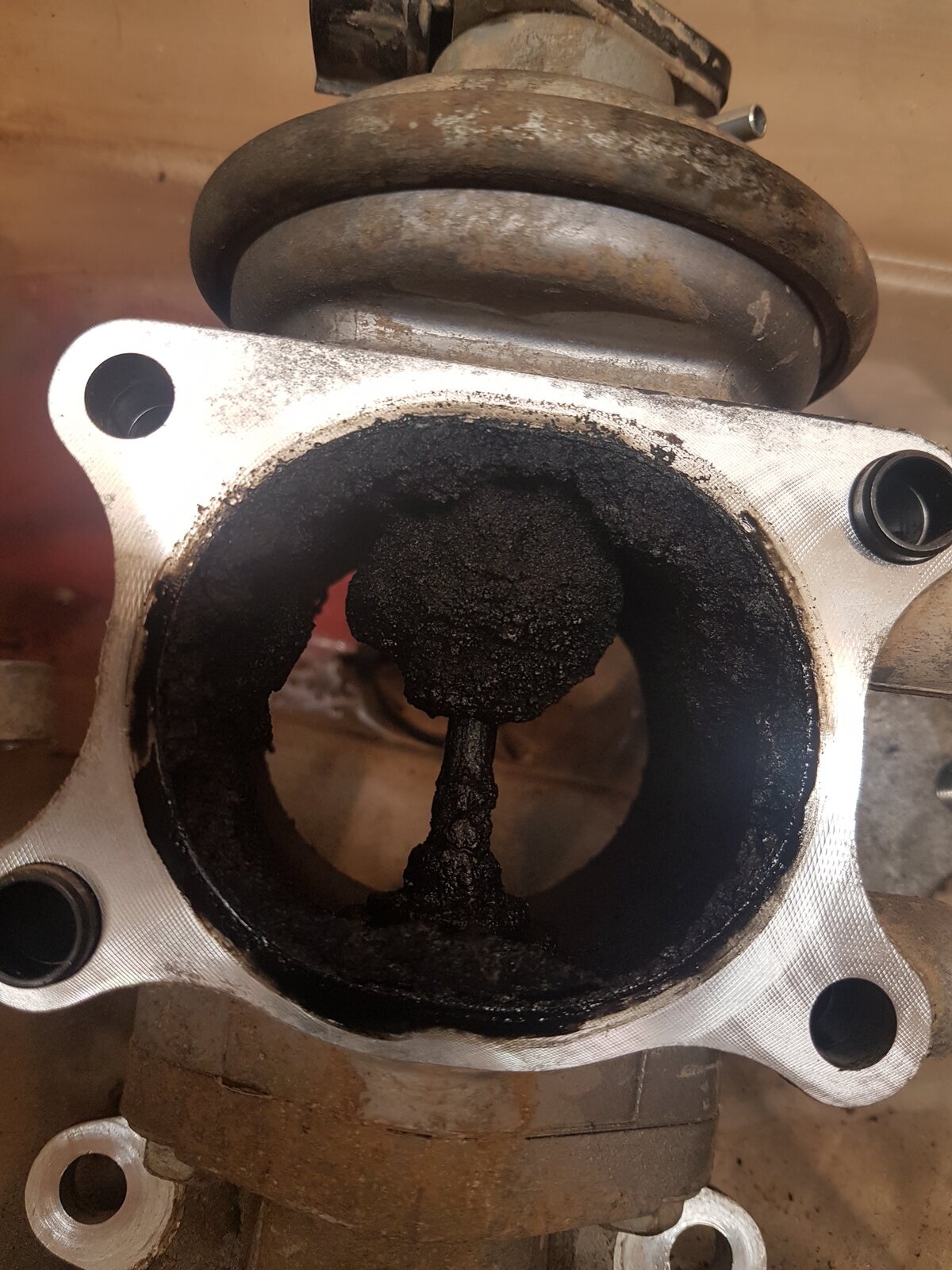

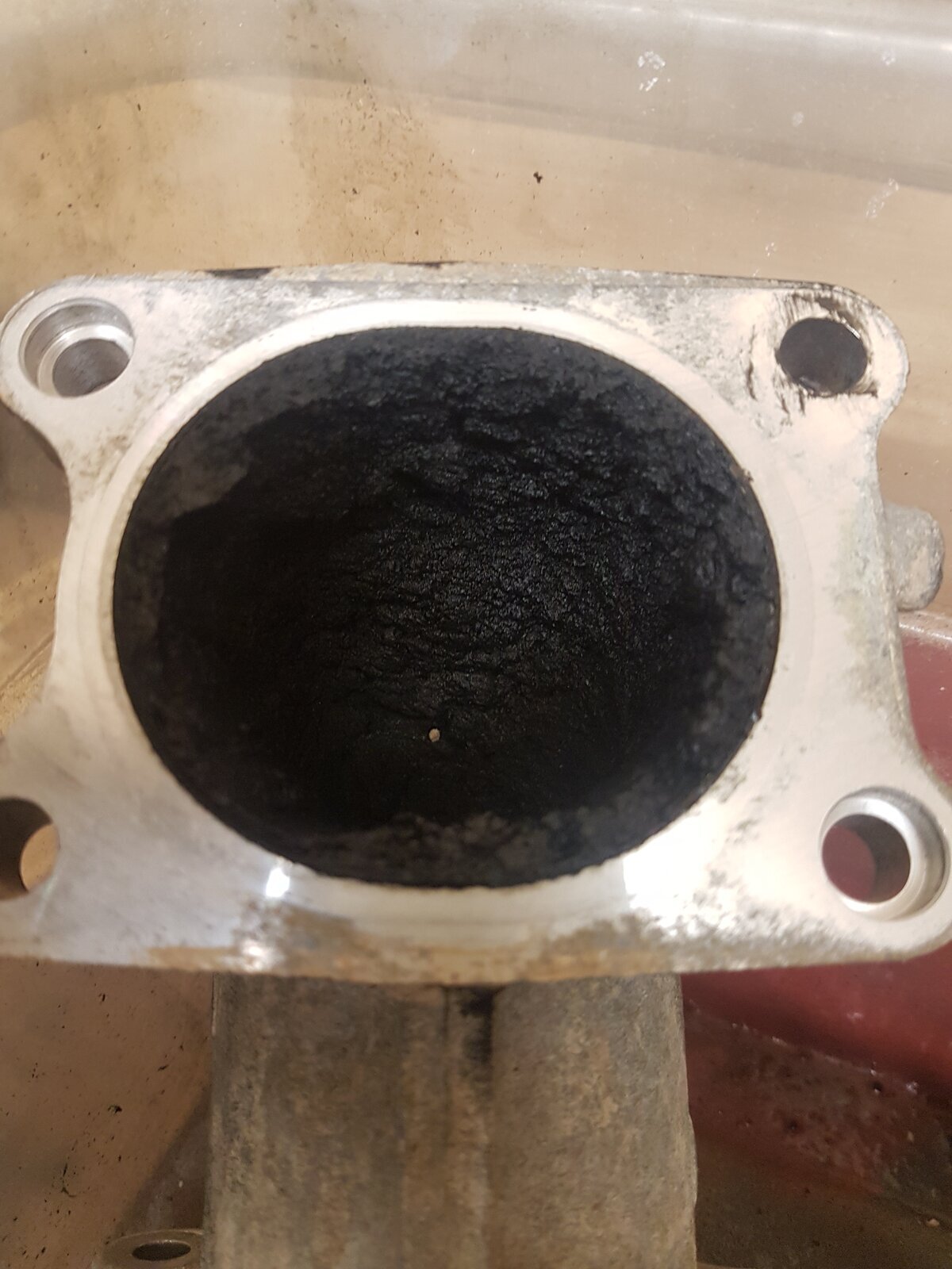

Couple of pics, before and after...
Easy job to do, albeit a bit of a dirty job
