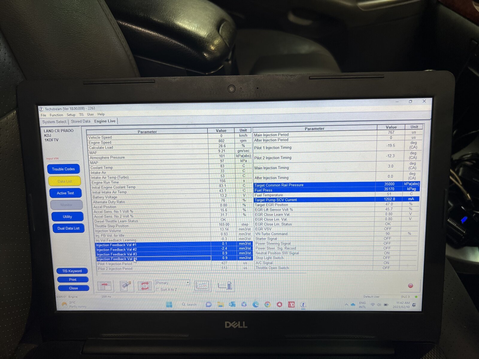

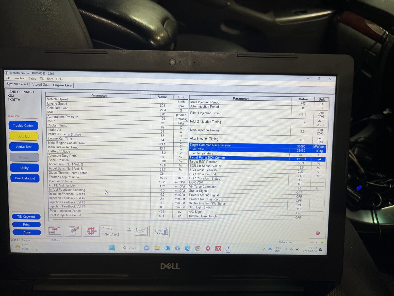

Toyota guys say everything is fine. Fuel pressures, injectors all performing well. No serious fluctuations.

Thanks for the info. What kind of SCV is in it? Fuel pressure looks OK
Quick one - why is the load % so high? With aircon off, and everything (radio etc) off, it should be around 12% when idle if its on new injectors. 27% is what I'd expect to see when the injectors are about to go?
Injection volume (12.26) also seems very high - would expect around 6.
Not saying thats related to your stalling problem just observations.
Injector checks need to be more than just looking at the 4 feedback values, but Toyota will know this.

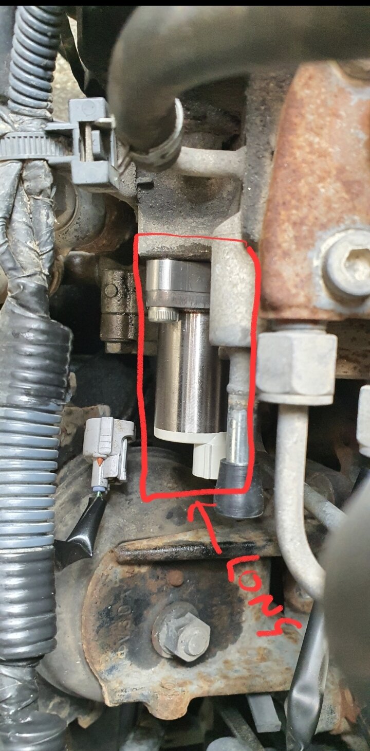

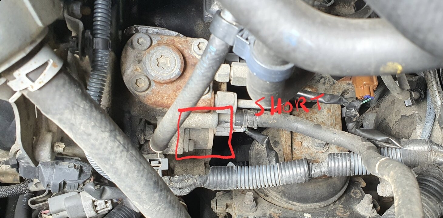

If you take a photo of your high pressure pump under the bonnet, we'll be able to tell you what kind of SCV it is!
If you dont know where the pump is, follow the hose from the diesel filter housing towards the front of the car - that hose will go to the pump.
The delay sounds sensible - but you always wait for the glow plug light to go out anyway, right?
Here's two pics that show the short and long version. You might have a set of a red one and a green one instead....
