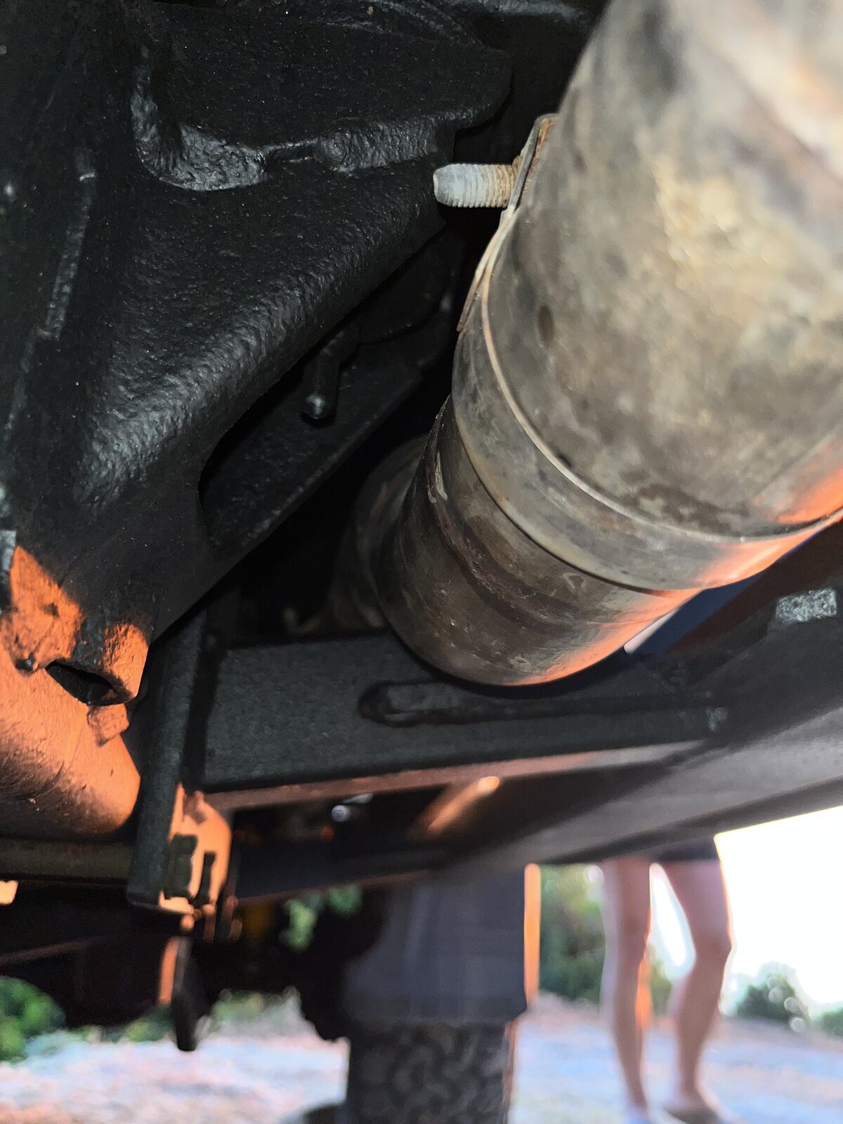

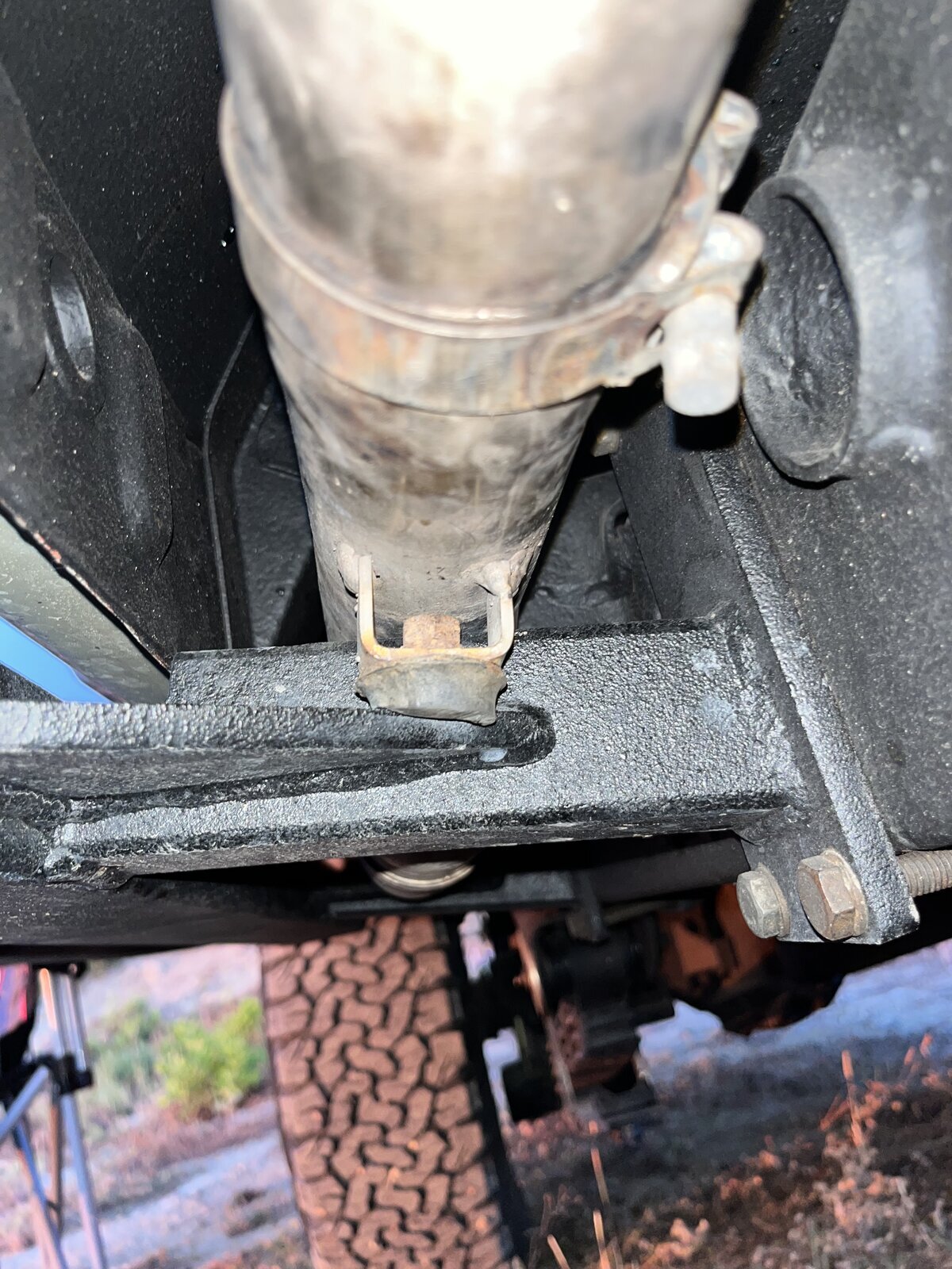

Does anyone know if the exhaust section beneath the offside, driver’s door should have any kind of clamp or fixture ?
It started shuddering quite harshly - noticeable especially after switching off the engine.
There’s nothing holding it in position - it’s just resting on the rock slider frame with the rubber mount you see in the pic.

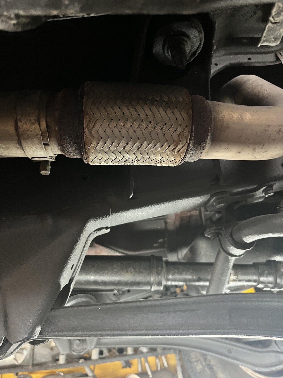

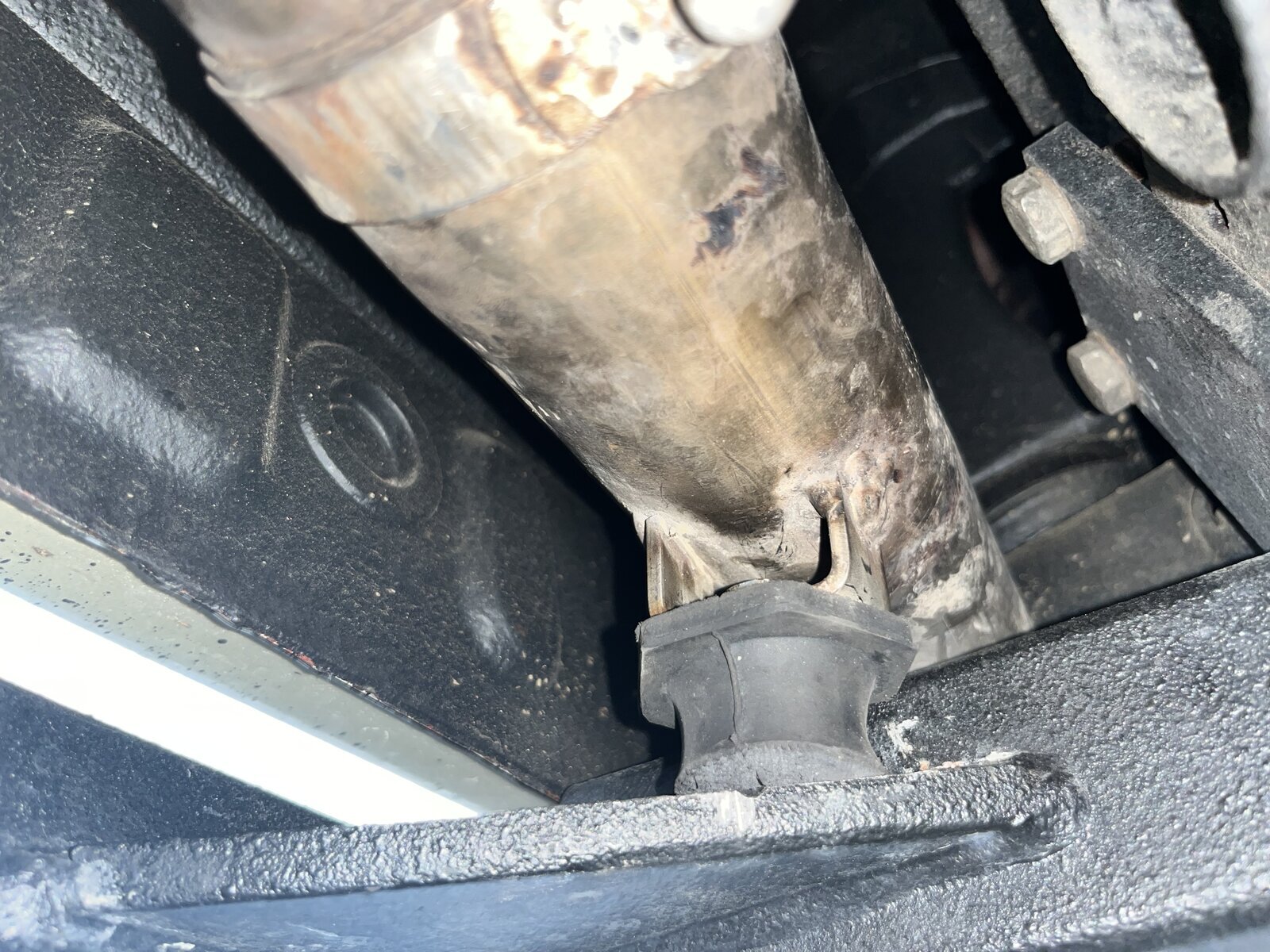

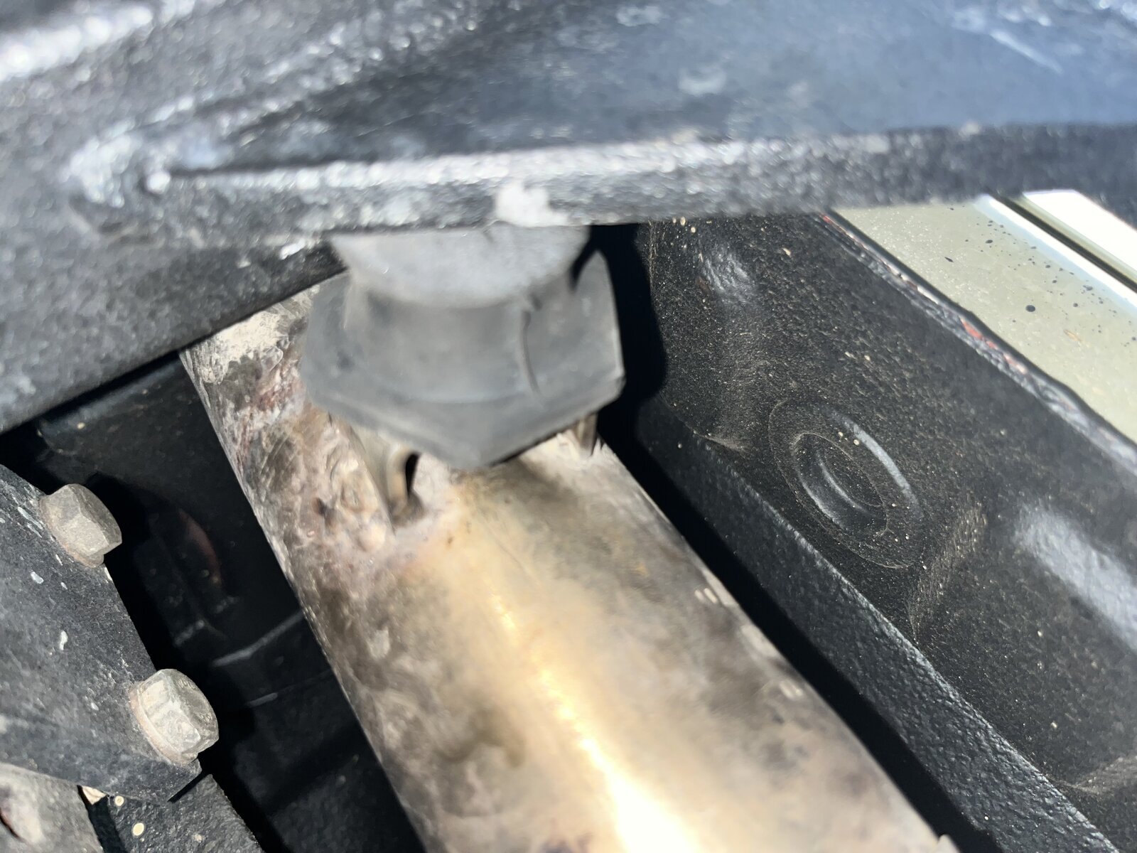

Turns out that the flex pipe i had ( see pics) has seized and hardened and the only option other than its replacement is to put in a beefy rubber mount below the place where the exhaust knocks

Was also advised to put in a longer flex pipe and a 3mm thickness exhaust pipe next time around.
@Phil01 Interesting. Where did you get it looked at? Was it a typical 'fast-fit' outfit or a 4x4 specialist ?
Just a regular place. You could attach the mount yourself- it was only the removal of the old one that brought out the hammers
