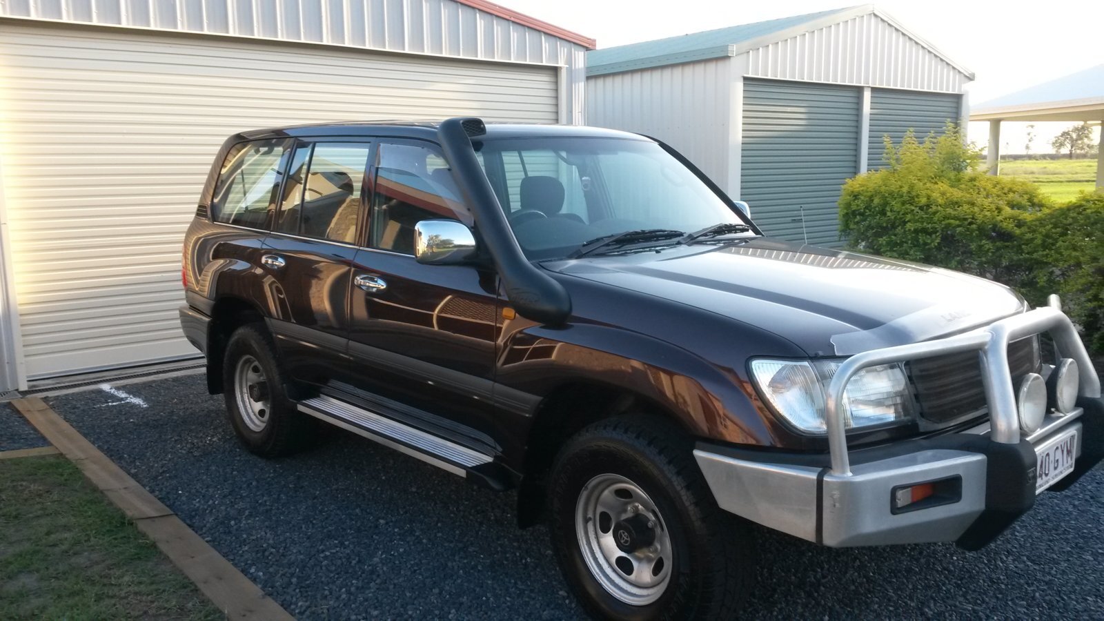

Hi my name is Paul I have just traded my 2002 Patrol on a 100 series 2002 model Cruiser and so far really happy,I've only had it about 2 weeks.
It has 255,000 k on it and drives really well,It has a few rattles I need to find but every thing else is really nice for it's age.
Paul

Good looking truck there!

nice looking truck there, I was going to ask if its a 105, based on the steels on there.
w.r.t the turbo, there is a lot of content on the internet about good / bad and wins/ loses from after market turbo's on the 1HZ engine. Is there a specific reason the mechanic recommended getting this one removed ? Do you know when it was put on and who did it and what kit etc was used ?
