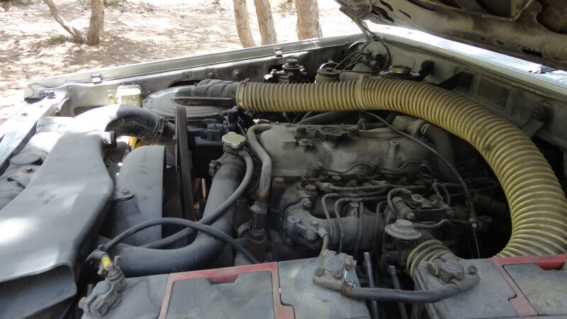

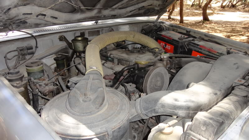

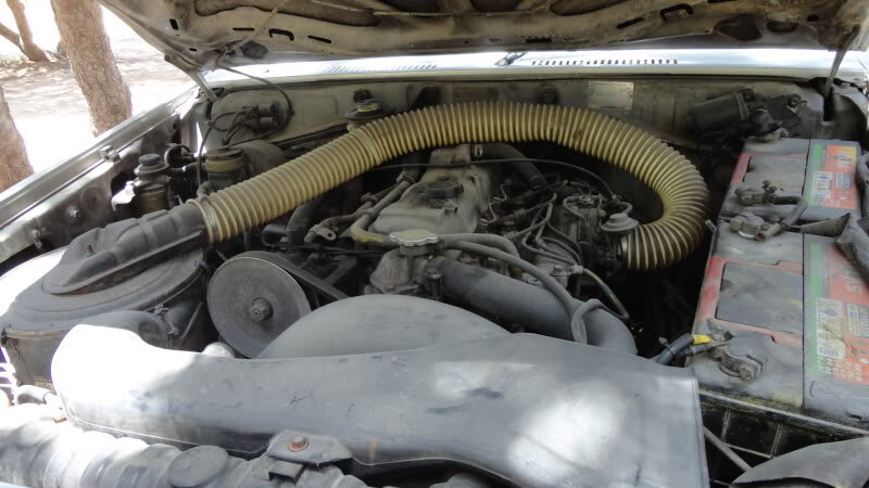

i would like to see some pics of the engine.
in late 88 the 3B changed to the 3B II which can be identified by the exhaust manifold. so a pic of the bottom section of the exhaust manifold would be nice.
the tappet cover looks more like a PZ,HZ,KZ style for the 3B II
and the injection pump is rotory vrs the inline.

My engine is a 13B (as in the Toyota Dyna). Will post some pics for you in the near future. :)
reason i ask, i have yet to see a factory 13B in a Land Cruiser of any vintage.
it might be a PO swap though.
BJ70 came with the 3B or the 3B II
the BJ71 came with the 13BT
but none came with the 13B from the factory ... if yours is actual then it is a extremely rare unit.
as for the year, post up the last 6 digits of the serial number and i can tell you the month and year of production.
I'm not that technical. When I asked the guy from whom I bought it, he said that it is an original engine (not swapped). Anyway...mya Engine number is 0914628. Thanks for the info! :)

@ Crushers - I haven't forgotten you...I still need to take a pic of the engine for you! ;)
Crushers....these are mobile uploads of the engine...sorry they're a bit crappy, but I promise to upload some quality photos soon. :)
Next week...appointment with the sprayer....will be spraying the inside...then pimping the interior :)
could i ask for some pics of the engine where i can actually see the engine?

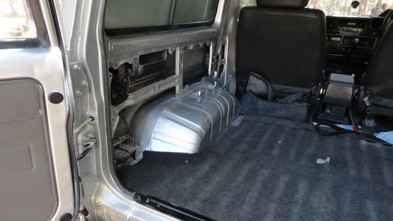

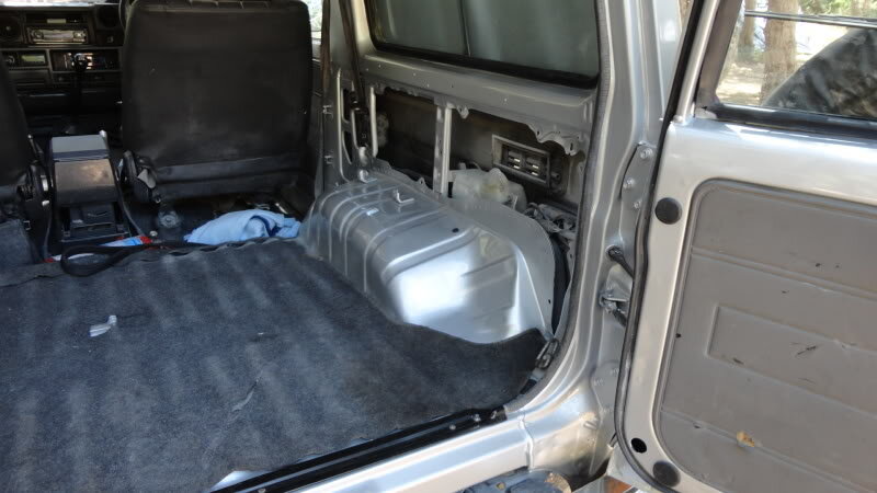

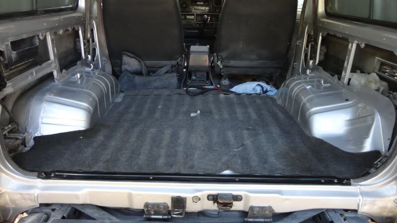

pics of newly-sprayed interior and engine (special request by crushers ;)), which still needs a good clean-up.
Next step....upholstery!...

it does appear to be a 13B
it does appear to be an engine swap
thanks for the pics.
