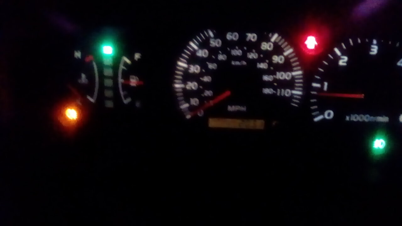

Oops forgot to
add a piccy
Green on right under rev counter is front fogs on and orange under temp gauge on LEFT is rear
Thanks Steve I definitely have neither lit but they might be there now I know where to look , maybe with dead bulbs too .
