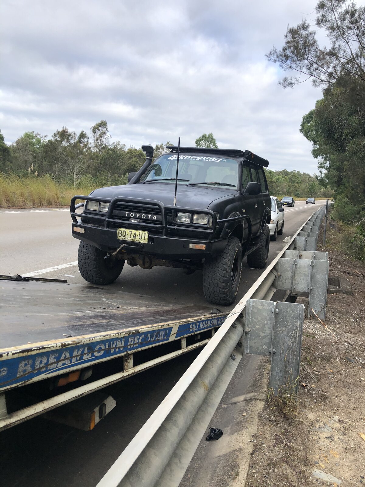

I have a 1992 dx 1hz, I bought it a few months ago, 3rd & 4th always grinds to go in, I always had to rev match it, & to put it in 4x4 mode was tough.
Yesterday I broke down on the highway, it was grinding and felt horrible so I pulled over and turned the car off & started it a few minutes later to take off from the emergency lane, & to find out that in every gear including reverse it grinds & sounds horrible ! And won’t move a inch.
I’ve been told that this could be my clutch or my gear box and transfer by different people, but my clutch felt fine, it engaged low and still holds pressure.
I bought a second hand gear box that came out of a wrecking car that runs and shifts smooth. Just wondering how would I find out if my transfer buggered too? I looked under the car and see that it was dribbling a little bit off oil where the tail shaft connects.
and would the gear box be hard to change at home? I’m located at central coast NSW, is there any cheap mechanic shops that’ll change this that won’t cost a arm and a leg? Or would anyone like a cashy haha..
Cheers!!
