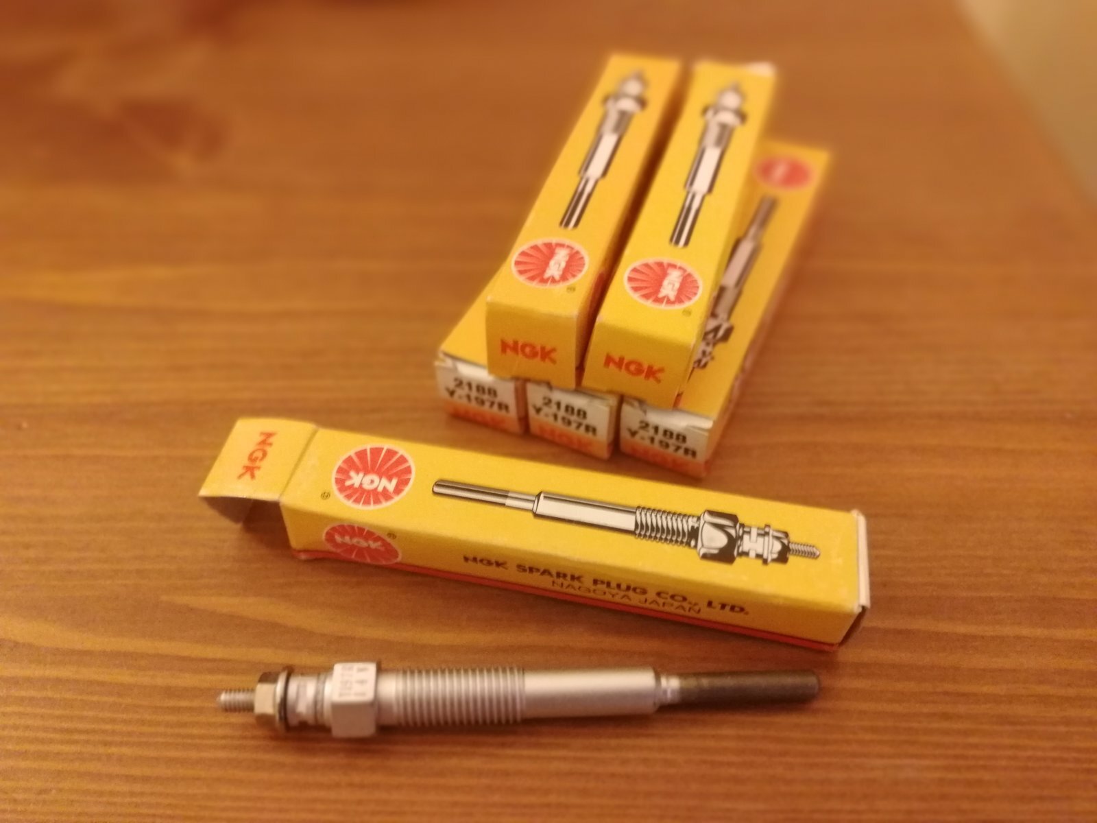

Bit of an update on this.
Simon Holton was kind enough to provide me with the correct part number for the glow plugs based on my VIN: 19850-58010.
Unfortunately those retail at £23.08 + Vat each (£27.62inc) after the club discount, which is a bit step for some glow plugs.
But thanks to the wonder of the internet I was able to cross reference those to NGK Y-197R (#2188). I grabbed a bargain on those on eBay at £37.29 inc. delivery for a set of 6. Those come with a 1-year manufacturer warranty so I thought there would be no harm trying them on.
The cold start issue has now disappeared, and the car now fires up in a split second in the morning. Sadly those didn't arrive on time to test them under the -7degC that we had a few weeks back.
Nick.

There you go:
NGK Y-197R on Ebay
There are a few sellers who sell the same product for circa £45.00 a set. The one I ordered took almost a week to arrive, but to be fair to the seller the snow fall the previous weekend had generated some backlog at Royal Mail.
