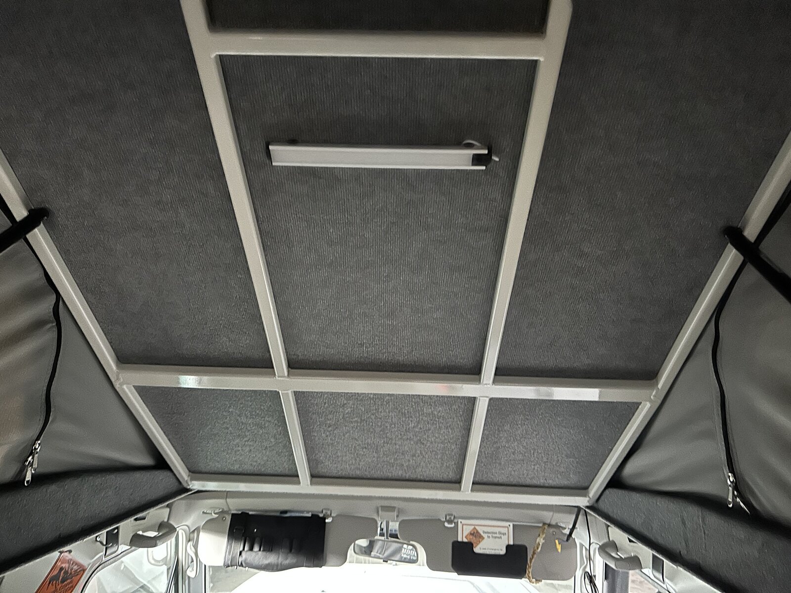

A few more pictures. Hard to photograph the inside whilst it’s in the workshop. I special requested light colour carpet as usually they are all fitted with charcoal colour which makes the inside even darker.

Absolutely stunning build. Really great job! I like the fact that you haven't built the units too high so you have an unobstructed view throughout the cab. It makes it feel much bigger.
I also love that timber work top.
Thank you. At one point during the build I hated it! But the plan is starting to come together now! The wood for the worktop and table was my prize find.
