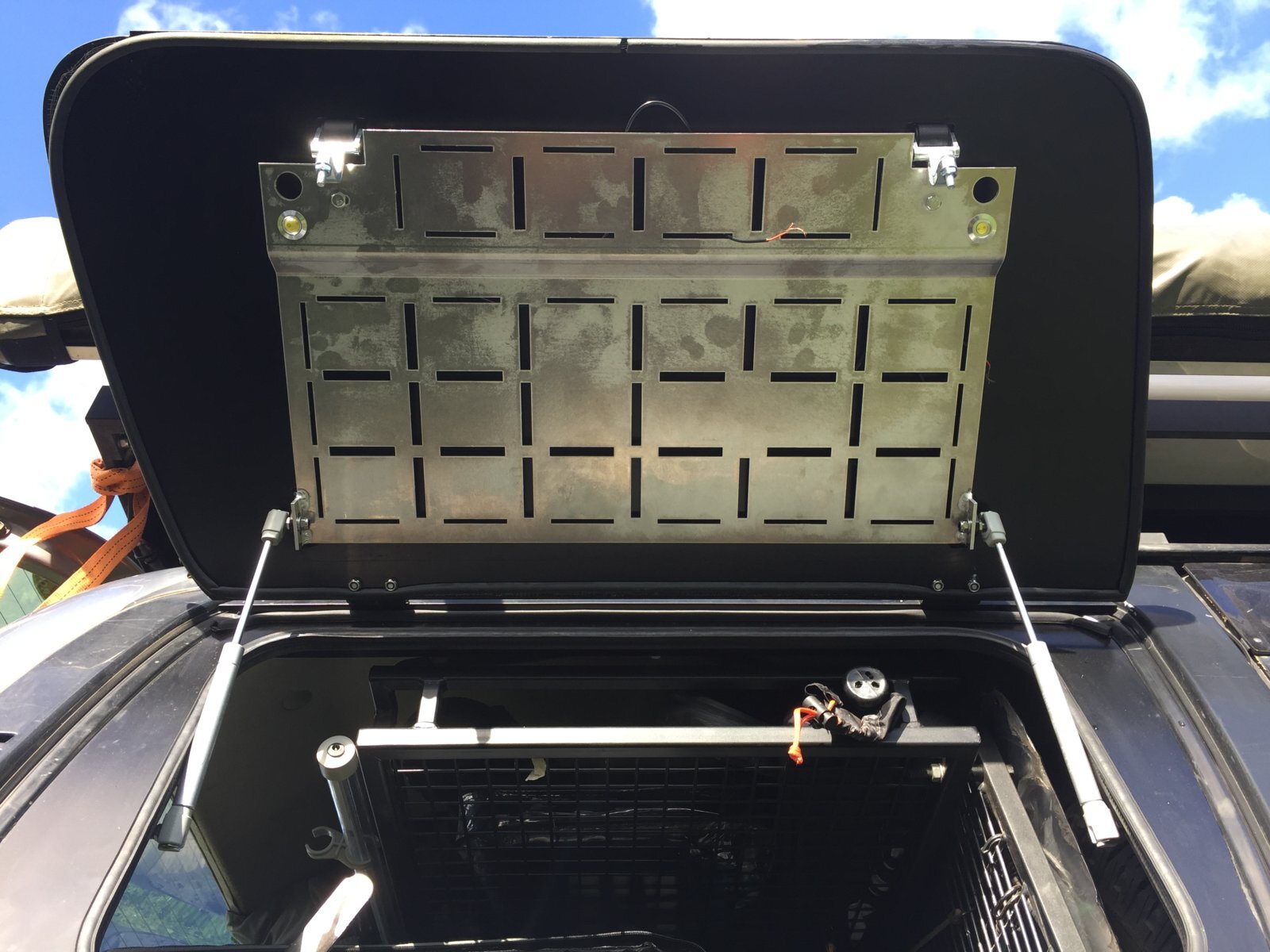

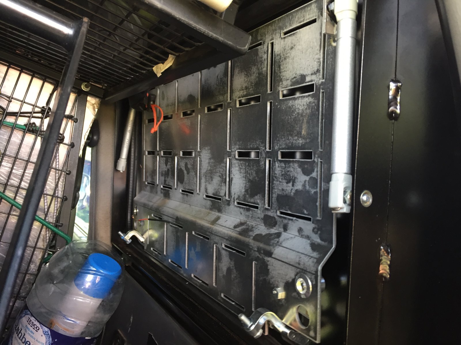

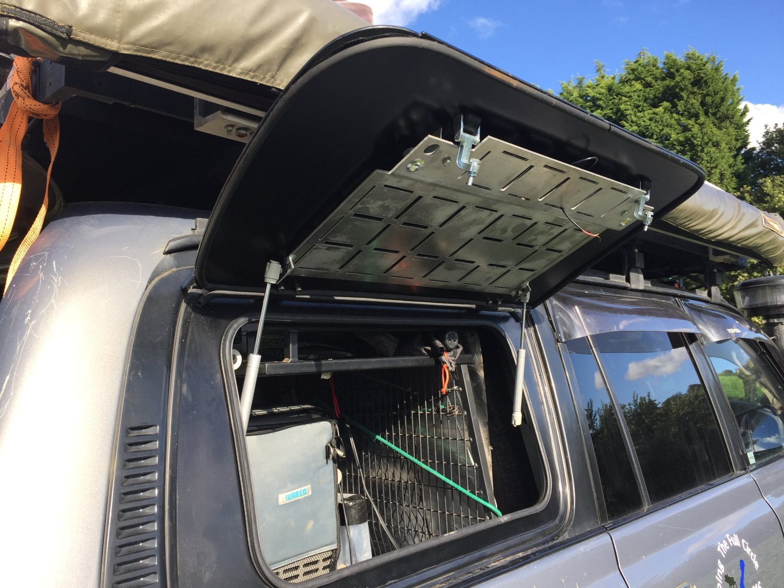

Got it properly wired in and some kit on there. Used flexible conduit to carry the wires over.The struts carry the weight with no problem at all.

Nice Chris. Pleased they hold the weight ok. :-)
Is that using T nuts in the slots?
Actually T nuts were a bit grand Rich and the smaller slots are too small for that in any case. I just used machine screws, washers and nylocks.

It will be interesting to see just what weight is acceptable and what causes the door to drop.

Rich, small suggestion. I'd perhaps make the cut out where the locking arm goes just a little wider - 5mm a side? And also the two bolt holes next to the lamps would be better as slots I think. Horizontally. A bit of wiggle room would be handy.
If you mean the mounting holes Chris they should already be slots. Not big ones but slots they should be. I did forget to amend the clearance to the side of the catches but elected to not reduce the part the catch rests against when open as there is plenty of room there.
I take your point on the side to side clearance as things could get trapped in there. 5mm a side sounds good.

Fitted a couple of pairs of these over the weekend. They are coming in painted black the same as the doors at the minute and all the slots are now made the same size at 5mm wide.
I had a bit of a trial balancing some weight on the doors and they will happily take 4.5kg and still hold up…just. This was in one place, fairly close to the edge so even distribution will no doubt improve this if need be. Let's face it, they are only really ever going to hold light stuff in easy reach so I'm pretty pleased with 4.5 kg.
