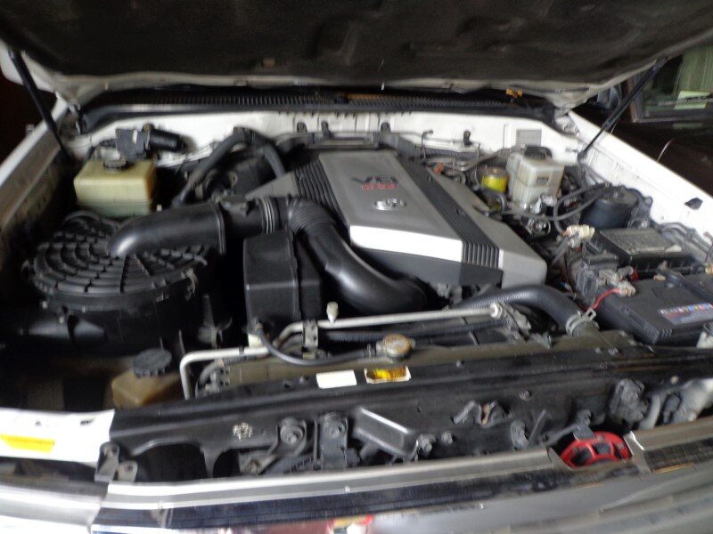

Hello everyone, i just bought a 1998 100 series Landcrusier VXR, i need some help with it.
It is a Dubia model, so i believe it is a original left hand drive.
What is the difference of a VXR, to say a VX?
It is in great shape it has Dual gas tanks, does anyone know the capacity ?
It has a V8 Gas engine, with a Automatic Trans, is it always in Four wheel drive?
How strong are the axles, say compared to a 80 series?
Can someone decipher the model number and VIN? If so here it is
Model number UZJ100L-GNPEKV
VIN JTB11WJAOW8002884
Engine number 2UZ-FE, HOW STRONG IS THIS 4.7 V8?
Any help would be deeply appreciated, as i haven't own a 100 series before, and my last 2 landcrusiers i own was many years ago, I had a 40, which was modified with a 350 chevy V8, was a offroad toy. And i had a 80 series 6 cyl Diesel.
Thank you

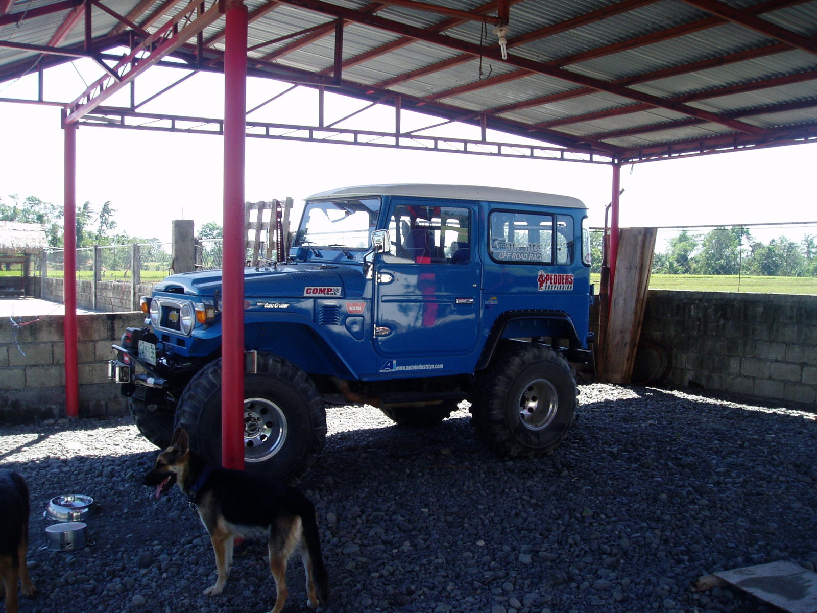

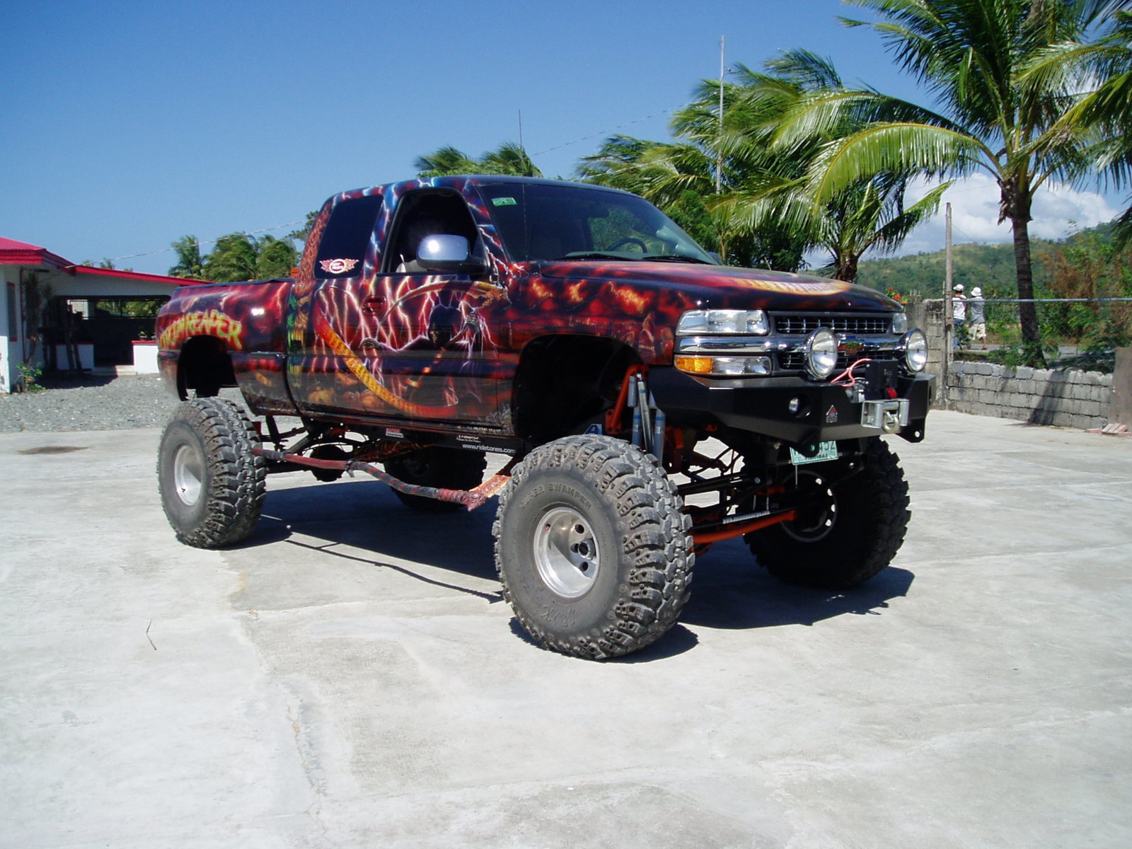

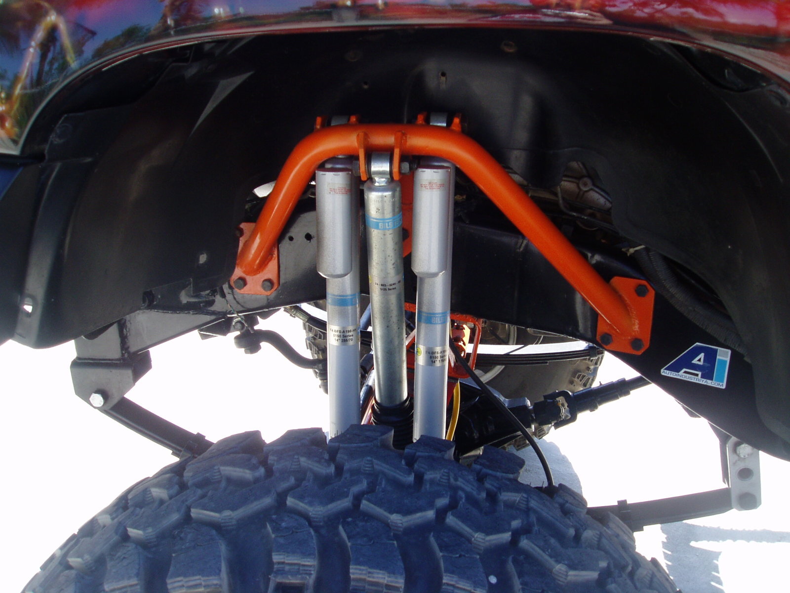

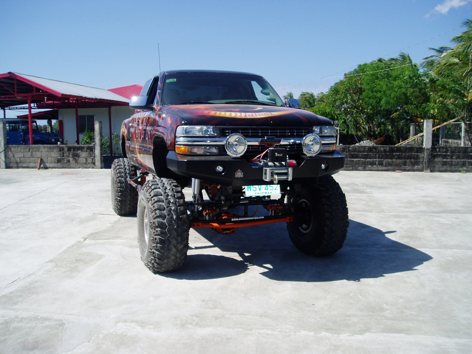

I am hoping i don't break the axle, but if i do will look into all options and decide. My landcrusier won't see too much offroad use, as i been doing off roading for years, and now with my age and medical issues i will not likely be off road to often. But you never know Haha. Here are a few pictures of my Chevy and 40 series.
My goodness, must be something in the water in the Philippines :lol:
Not everyone’s cup of tea, but those trucks are works of art
Love the hundee Cruiser too, looks really nice in white...
Welcome aboard :thumbup:

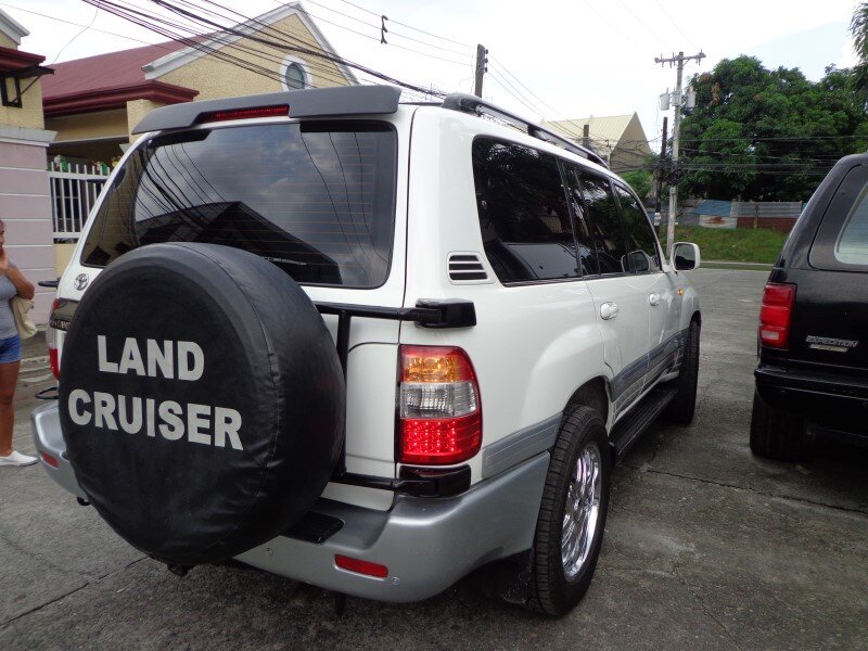

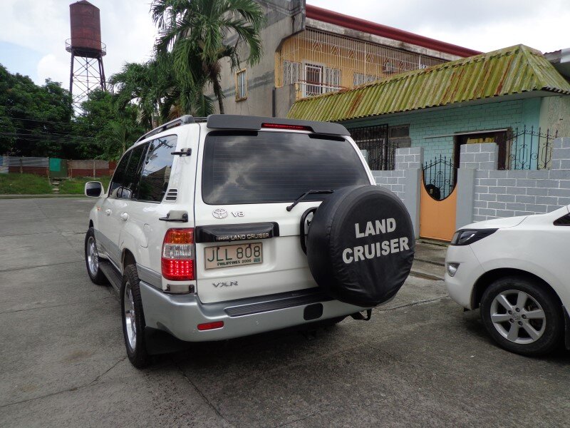

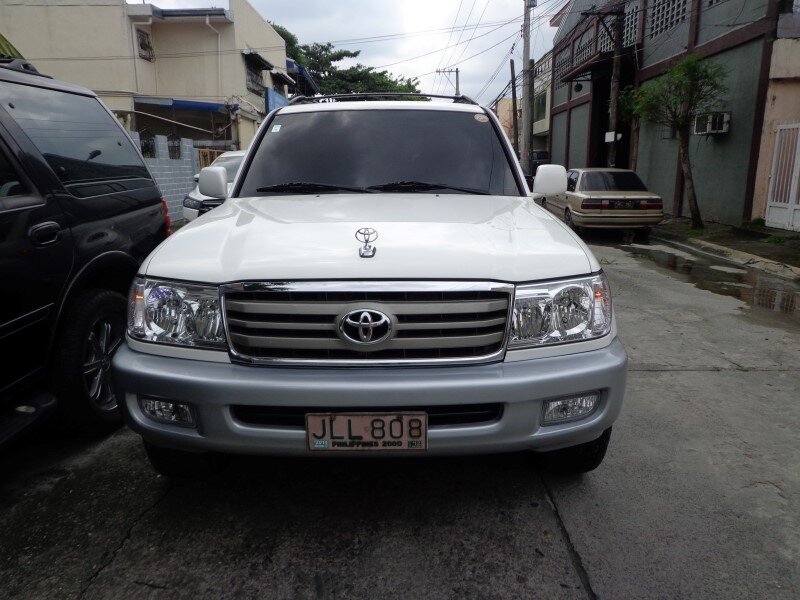

BTW, looking at the pics of the 100, it looks like your rims are not standard, or you have spacers, as they stick out a bit. Or is it just the picture angle? Do they give you powersteer and tracking problems?
Those wheels were on the LC when i bought it, i replaced them with another set. I haven't drove it yet, but will Monday they fit good, will send some pictures next week sir. Thanks again
